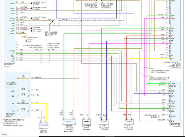

So, I bought a LS400 and all the plugs for the stereo have been cut so it's just hard wires. I need to know what wires are what to be able to wire and aftermarket stereo problem is some of the wires have had some kind of paint overspray on them so it's hard to tell which ones are which, but they are also bundled in their individual groups. so, I'm hoping to find a pinout for each plug so I can kind of try and match the wires to the right plug and be able to wire up my stereo.

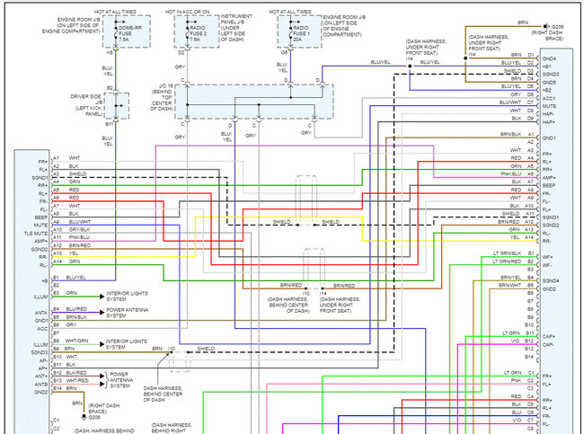

This sounds like it may be difficult if you can't see the wire colors. Regardless, I have attached the wiring schematic below for your review. I had to cut it in half to make it readable for you, but I did overlap them so you can follow from one to the next.
