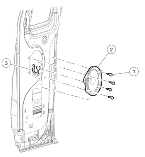

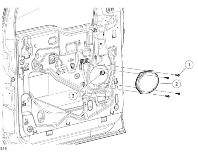

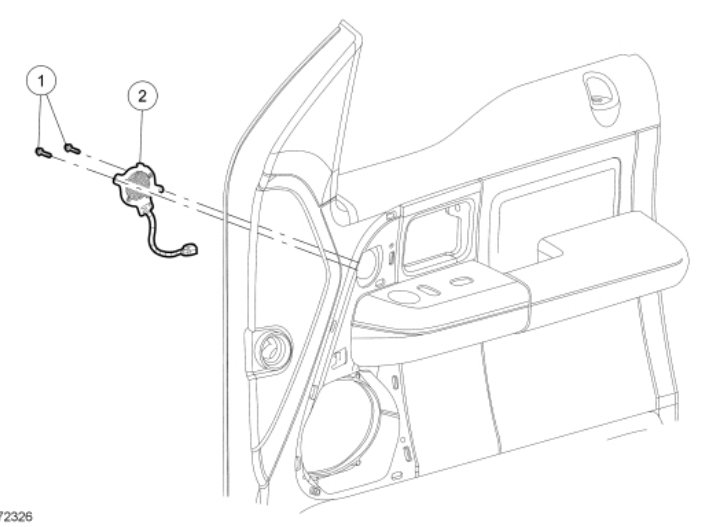

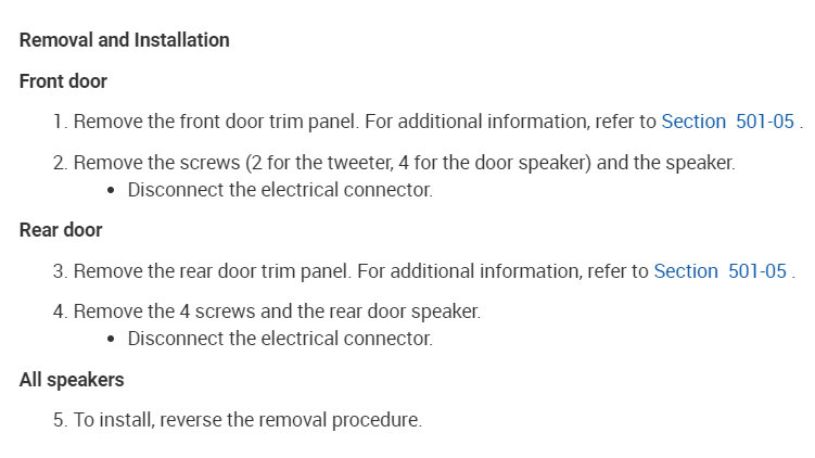

I am looking into buying new door speakers and I want to make sure they are compatible without an amp. Is the factory Ford head unit 4ohm.
Wednesday, April 29th, 2020 AT 10:16 AM
DANNY L
  • 5,648 POSTS
Hello, I'm Danny.
Yes, the speakers in your trucks audio system are all 4 ohm. I've attached removal and replacement instructions and location pictures below. Hope this helps and thanks for using 2CarPros.
