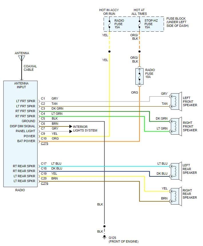

Does the factory stereo have a factory amplifier wire?
1993 CHEVROLET S-10
300,000 MILES • 1.3L • 6 CYL • 2WD • MANUAL
ERICA DONI
If so where is it and what color? And can you bypass it?
Feb 27, 2021 at 2:50 PM
STEVE W.
  • 15,345 POSTS
No amplifier wire on the stock stereos in that vintage truck. This is the OE wiring for them. I have added a remote switch to them but it involves removing the unit and adding a relay and wires to the OE switch to turn on an external amp. What is it you wish to do? If you want to add an amp you mat want to upgrade the OE unit anyway.
