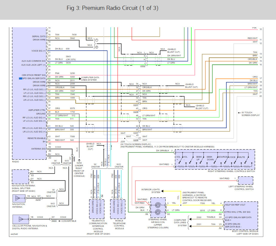

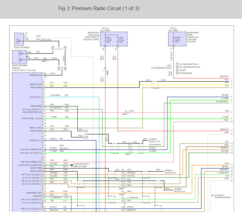

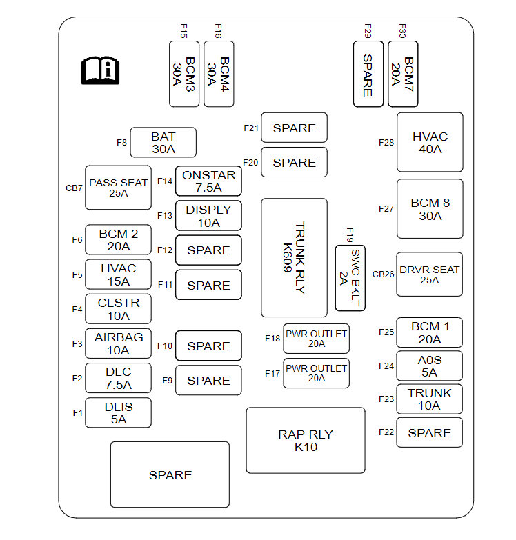

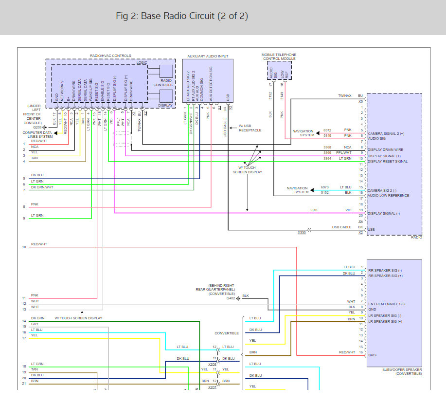

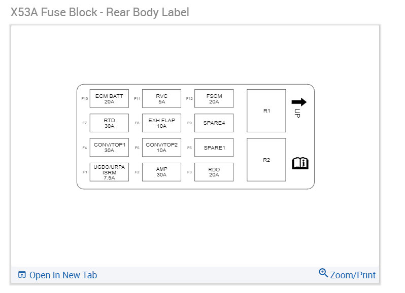

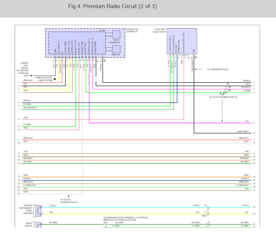

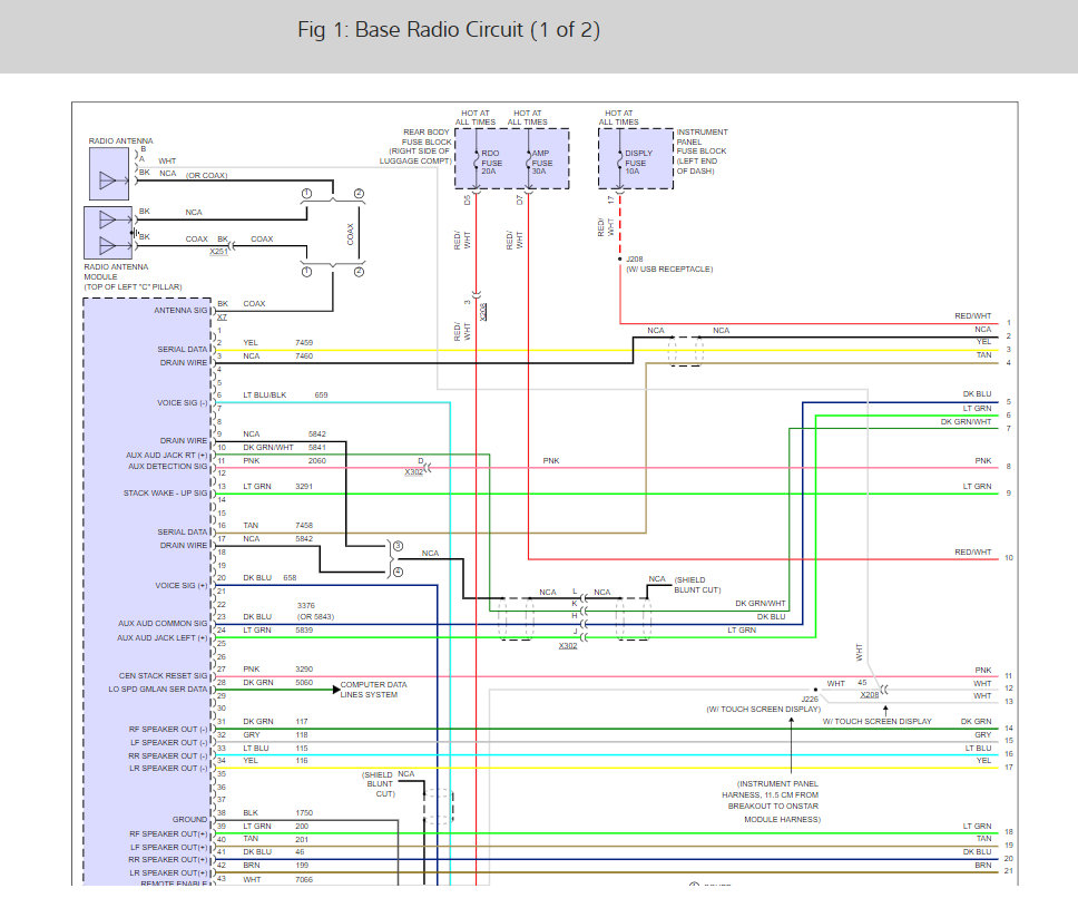

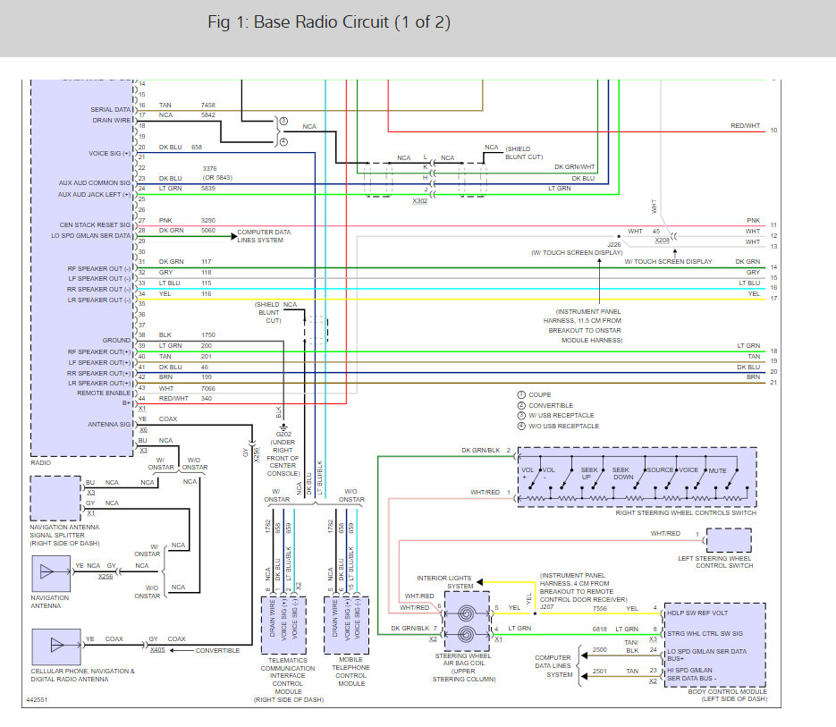

I was having no problems and then all of the speakers stopped working. The radio comes on and changed stations but there is no sound at all. The blinker doesn’t even have a sound anymore. What could this be?
Mar 1, 2019 at 4:14 AM
  • 55,694 POSTS

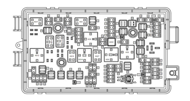

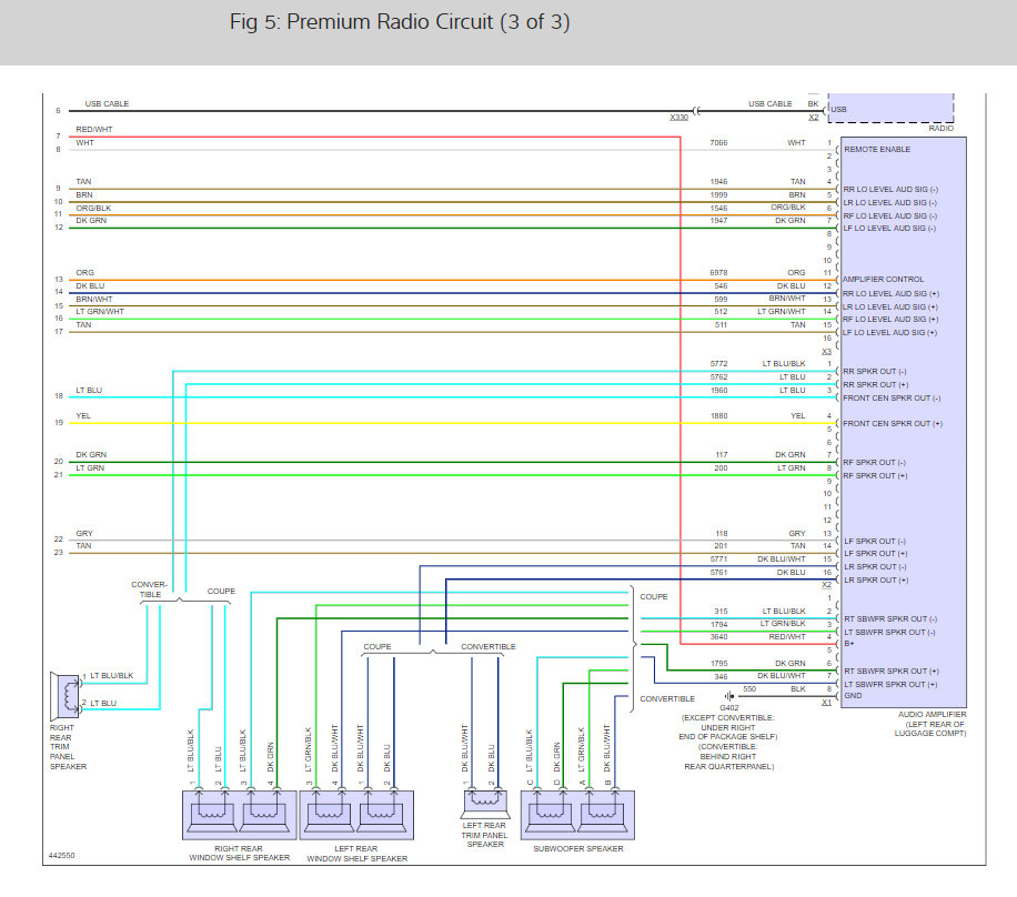

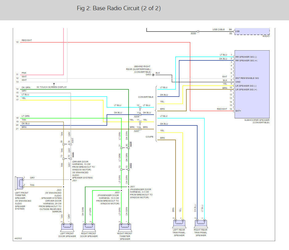

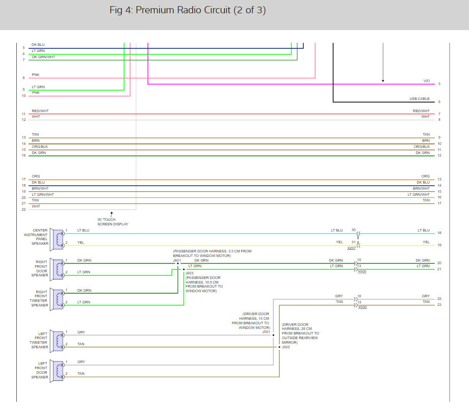

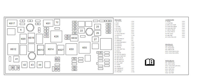

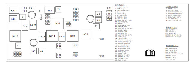

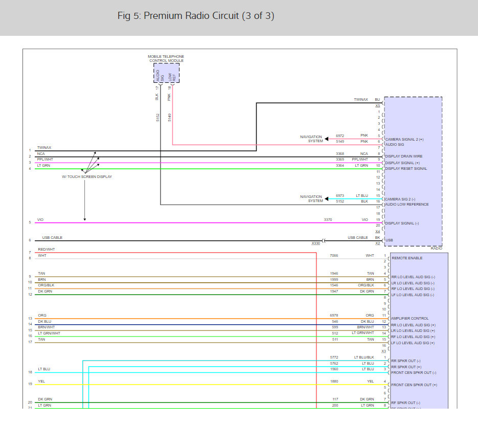

It sounds like a fuse (RDO, AMP or DISPLY) has gone out. but to be sure let's use this guide to check for power. I have included the fuse locations and the radio wiring diagrams so you can see how the system works below. There are two kinds of radios I got both sets of diagrams.
