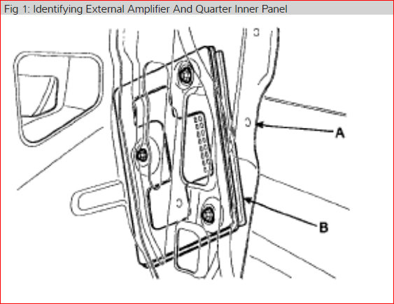

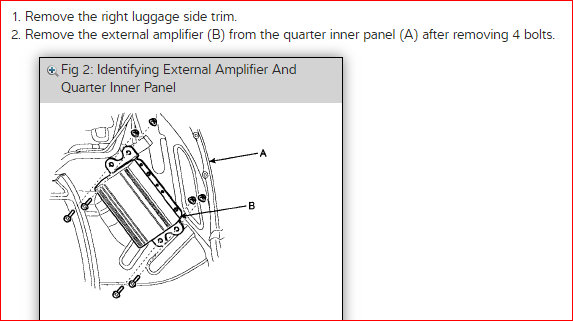

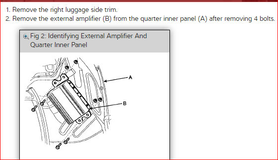

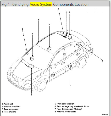

Where is the stereo amp located?
Dec 27, 2018 at 12:12 AM
DANNY L
  • 5,648 POSTS
Hello, I'm Danny.
Here is the information you've asked for. I have attached three pictures below. It is located in the right rear trunk area. Hope this helps and thanks for using 2CarPros.

Its not there.

Hello again.
Did you remove the right side luggage trim? That is the only location on your vehicle showing the amplifier location. Hope this helps and thanks again for using 2CarPros.
