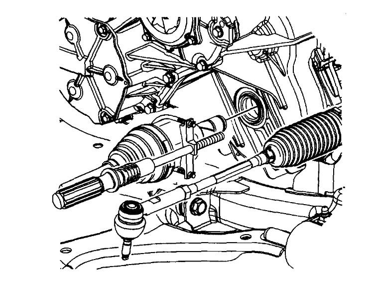

Hi, if possible I need step by step directions on how replace the front CV axle on a the car listed above ION 2 model. Thank you.

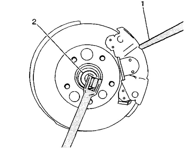

4. Remove the wheel drive shaft nut. Insert a drift (1) or a flat-bladed tool into the caliper and the rotor to prevent the rotor from turning.
5. Carefully loosen the wheel drive shaft splines from the wheel bearing/hub assembly using a wood block and a hammer. The nut can be partially reinstalled to protect the threads.

9. Separate the wheel drive shaft from the wheel bearing/hub assembly, then support the shaft assembly.
10. Assemble the J 45341 and the SA9173G to the wheel drive shaft inner tripot housing assembly.
11. Using the J 45341 and the SA9173G, separate the wheel drive shaft from the transaxle, then remove the shaft assembly.
12. Inspect the transaxle output shaft seal for damage and/or contamination and replace if necessary.
