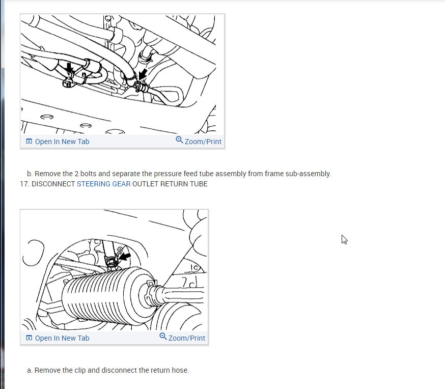

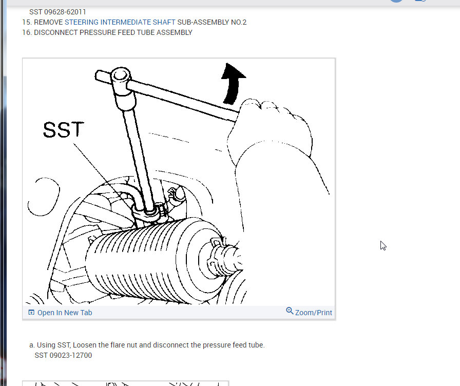

I have the vehicle listed above sr5. About a year ago or so me and a friend of mine did a brake job all the way around. Now I notice the steering rack is leaking Thank you.
Jun 3, 2020 at 2:15 PM

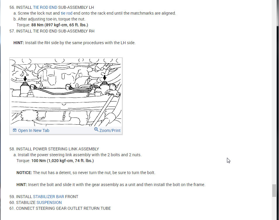

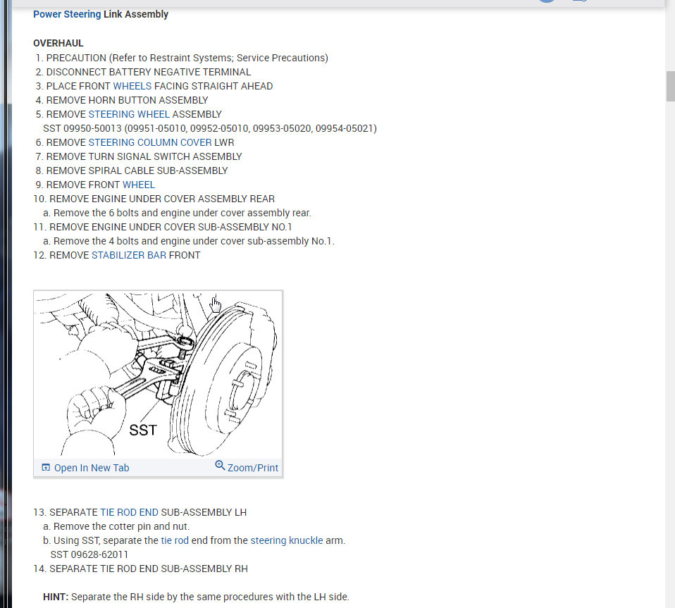

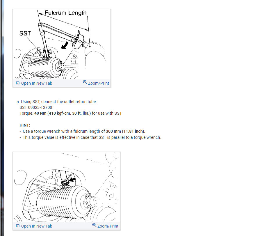

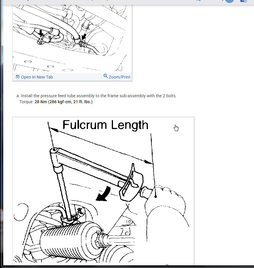

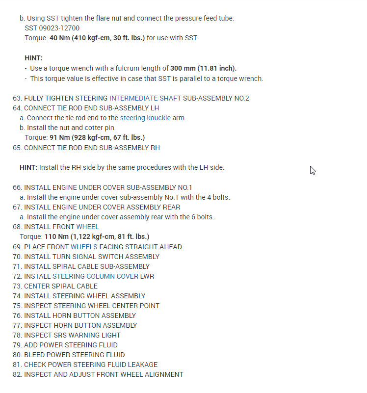

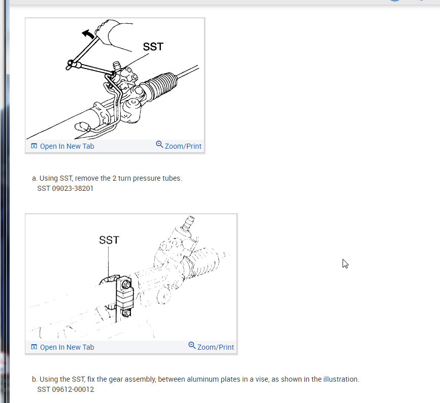

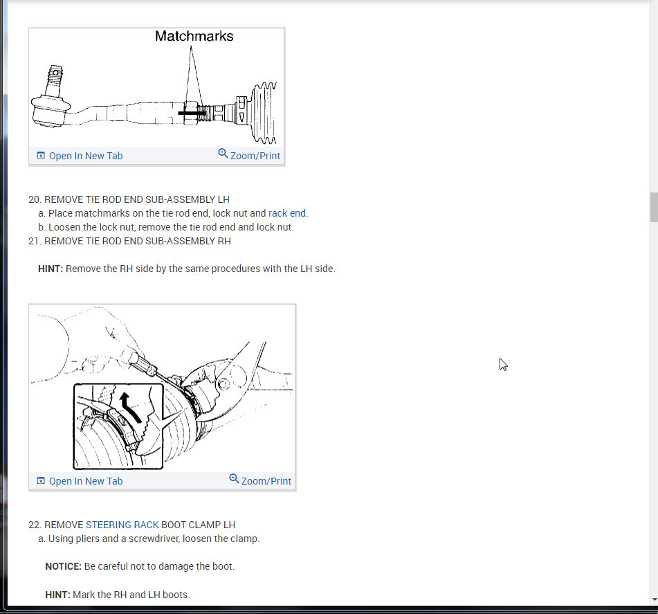

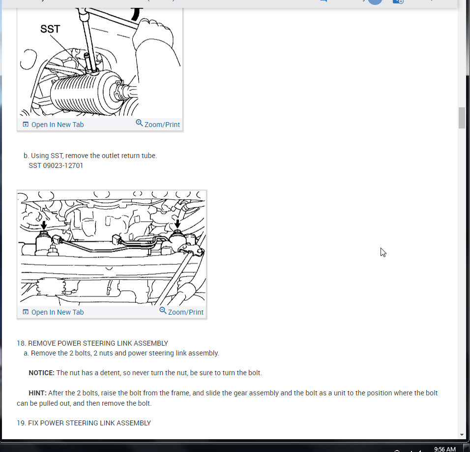

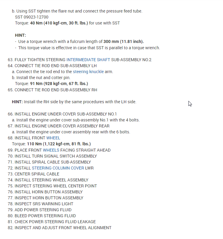

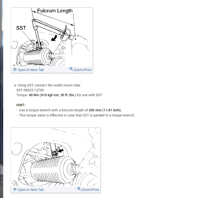

It may just need a boot replacement if that is where it is leaking but if there was any damage done by the dirt getting into the boot then it is best to replace it or rebuild it.
Please let us know if you have questions but the process below is how to replace the rack if that is what is needed. Thanks
