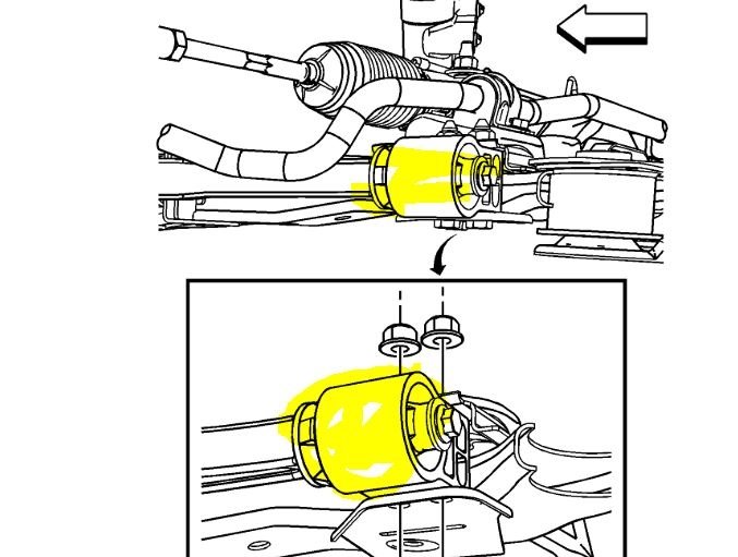

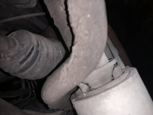

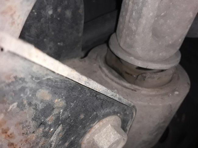

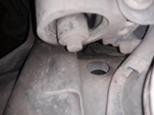

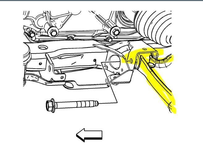

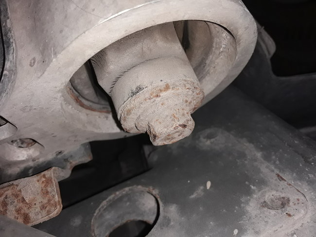

Everything seemed fairly tight when i wiggled around on everything, but found this on the arm that holds the wheel hub and everything. is it likely that this could be moving in and out? it is in the same direction that the wheel moves in.
Sep 11, 2020 at 6:41 AM (Merged)
  • 110,244 POSTS
Welcome to 2CarPros.
In the pictures you provided, am I looking at the control arm? That is what it appears to be. The control arm bushings may be worn. If they are bad enough, it can allow the wheel to move when you accelerate or brake.
Take a look at the pictures I and 2 attached. I highlighted the bushing which I believe is what you are showing us. Please confirm that.
Let us know.
ADAMSJOHN
yes it is. it looks like maybe its suppose to look like that.
