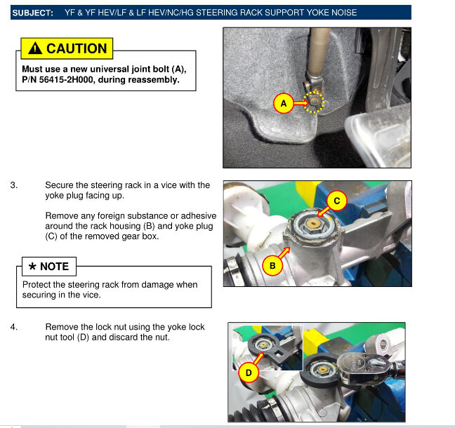

Steering wheel shaking and rattling when turning now all the time.
Aug 6, 2024 at 8:44 AM
  • 110,240 POSTS

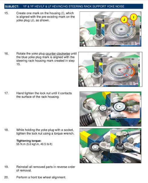

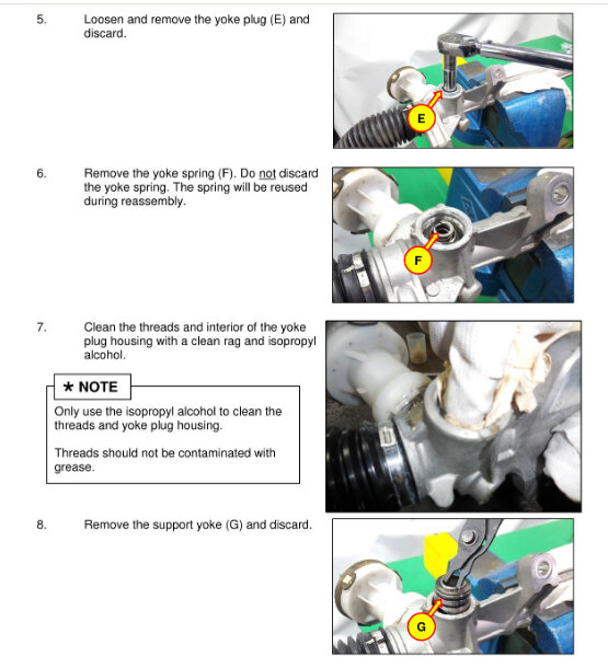

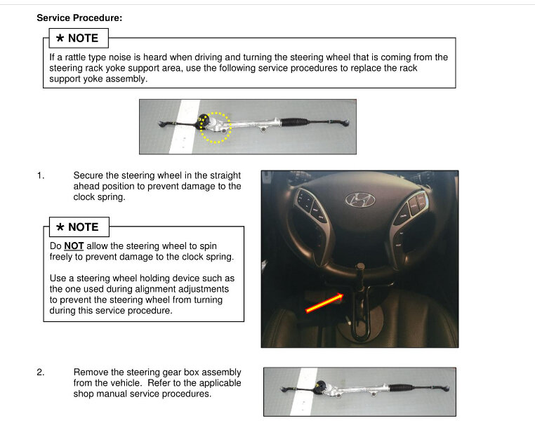

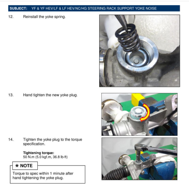

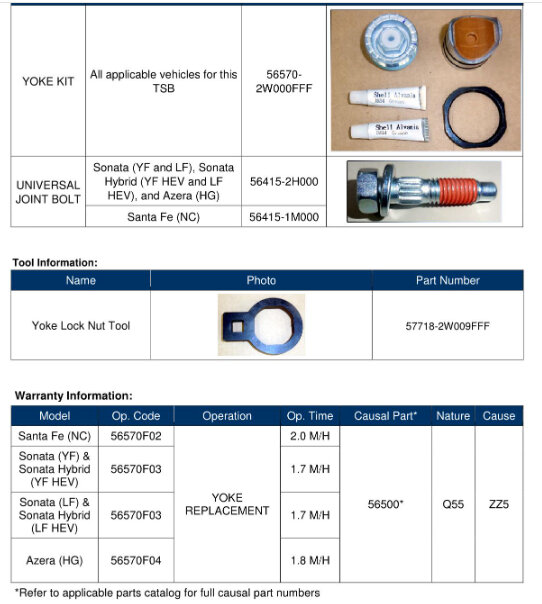

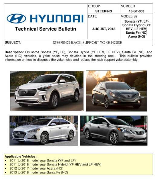

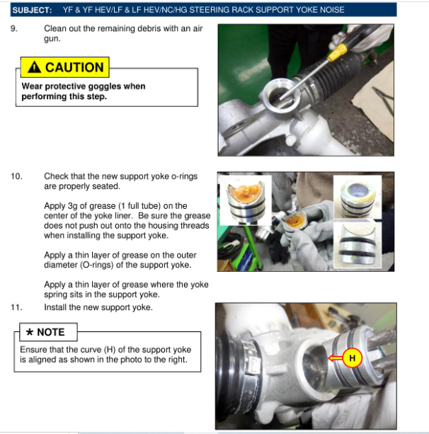

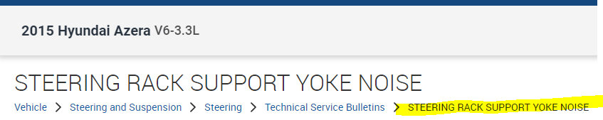

I have a technical service bulletin related to what I believe you are experiencing. I attached the bulletin below as well as the repair procedures.
This is somewhat of a difficult job due to spacing, special tools, and a strong understanding of the rack and pinion. Read through it and let me know if you have questions.
See pics below. Note: If you are not an experienced mechanic, this may not be a DIY job. Special tooling is required as well.
