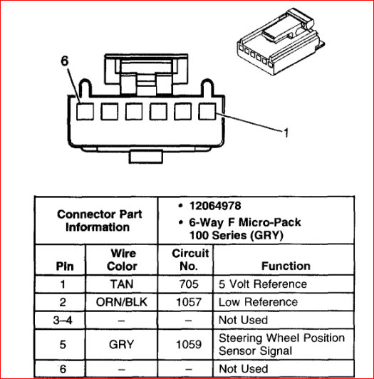

Need to check to see if steering wheel position sensor (SWPS) faulty
2002 CADILLAC ESCALADE
162,000 MILES • 6.0L • V8 • 4WD • AUTOMATIC
DANIEL GRISCHEAU
Is there a way to probe the SWPS wiring harness to check if the SWPS is faulty?

Hello, I am Danny.
I did find this as a reference (picture attached). I also found a step-by-step guide if you are interested for removal/installation. Hope this helps and feel free to ask any questions if needed. Thanks for using 2CarPros.
