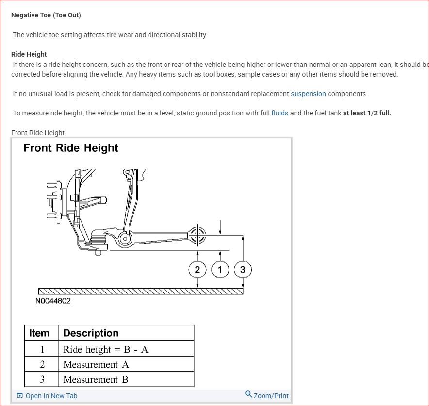

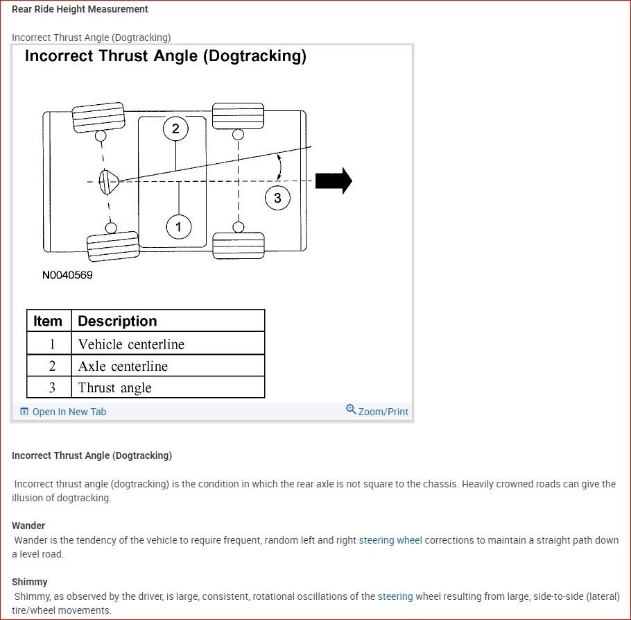

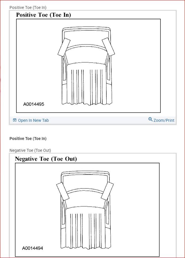

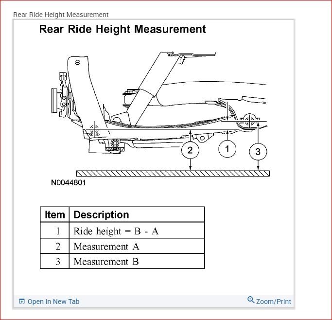

This could be a low power assist situation but lets test that first.
When sitting still, vehicle in park, and the engine running. Can you turn the wheel from lock to lock (left and right full travel) with little effort? Basically, can you do it with one hand or does it feel really tight?

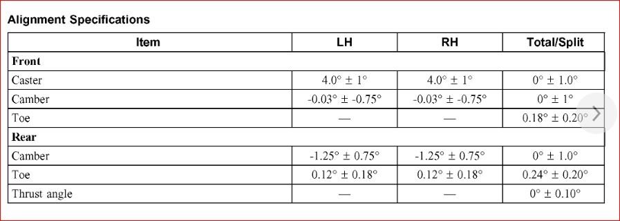

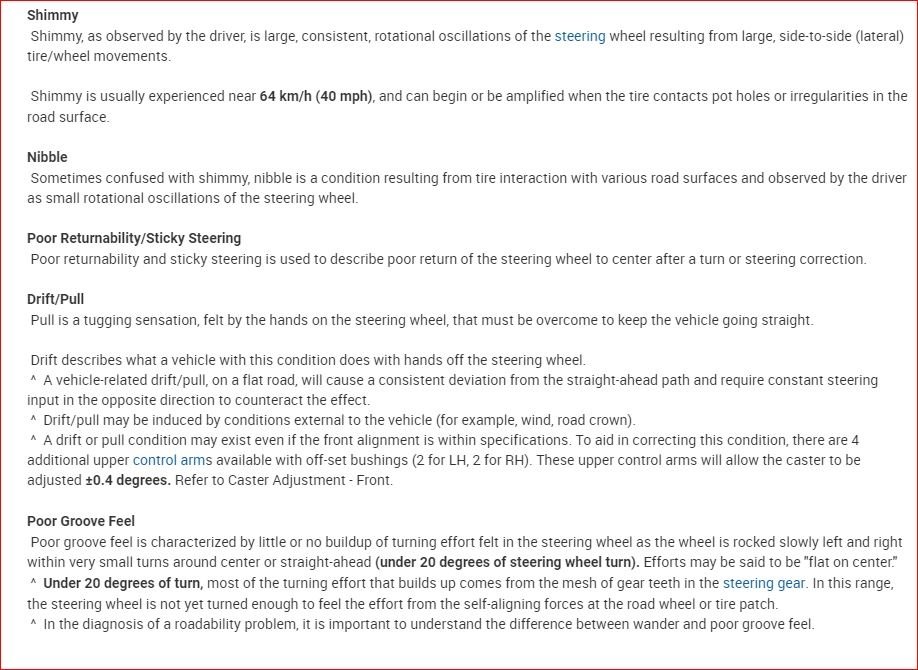

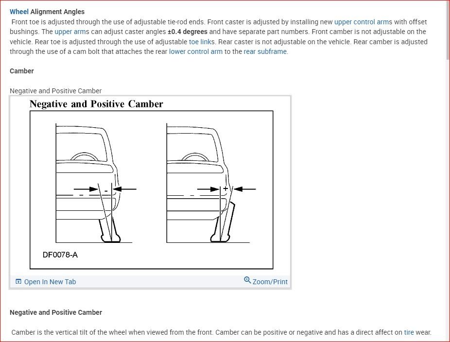

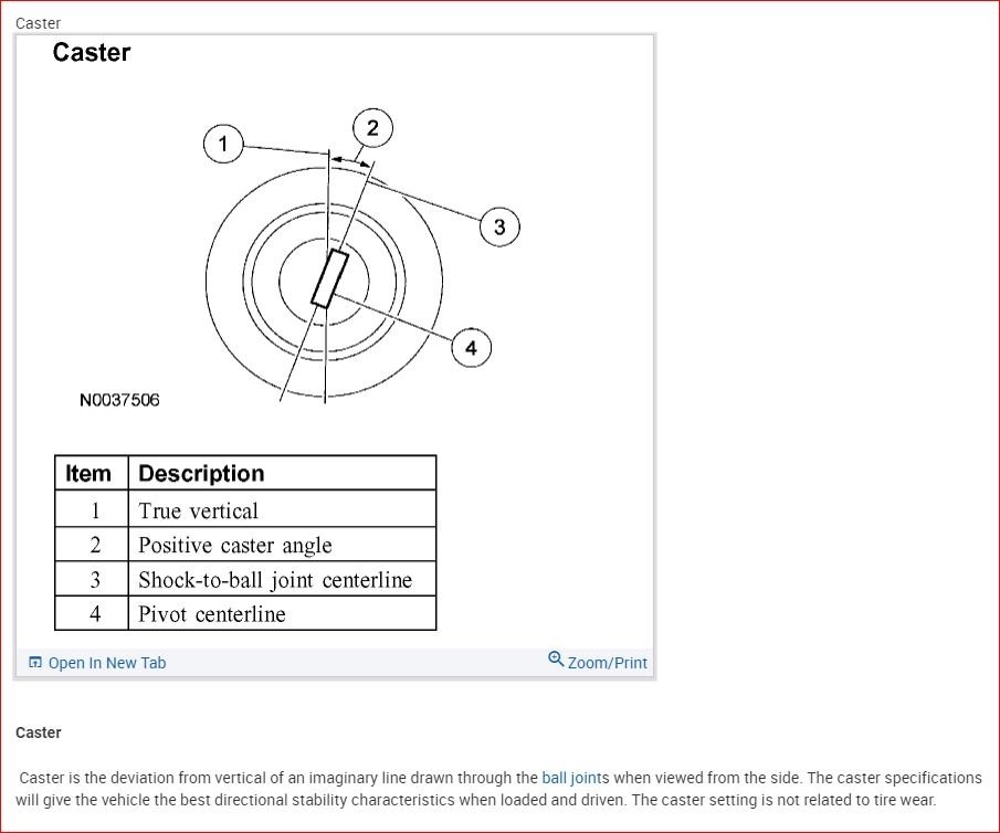

I suspect this will be okay and it feels like you have power assist. If this is the case then most likely when they did your lower control arms they did not set the alignment back to the best setting. When you replace a lower control arm and ball joints, you need to perform an alignment because these new components will change your alignment angles.
The alignment angle that helps with steering return or "memory steer" is caster. I suspect the caster is set to low or negative. For your vehicle each side should be set at 4 degrees positive. If set lower then the vehicle does not return to center very well.
I would suggest taking it back to who performed your service and ask them for your alignment specs when the did the alignment. I included what they should be so you will be able to compare them and see if this is the issue. Feel free to send them over to me if you need help reading them and I will assist translating. Thanks

Yes. An alignment issue of low caster will cause poor steering return. Unless you bought the exact same vehicle you had, you cannot expect the steering or driving characteristics to be the same between vehicles. They will drive different.
It doesn't sound like you have an issue with the steering but I would just keep an eye on it. As for the noise, you are going to have some noise when holding the wheel at full lock (left or right) and moving. This is the position that has the most strain on the steering system so some noise is okay. However, if you are describing a metallic grinding noise when turning, that needs to be checked out because you may have an issue in a half shaft (axle) or the rack and pinion.
