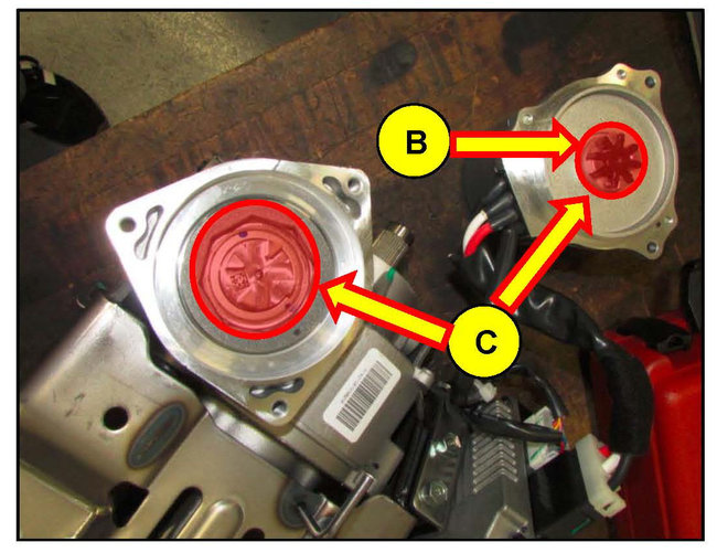

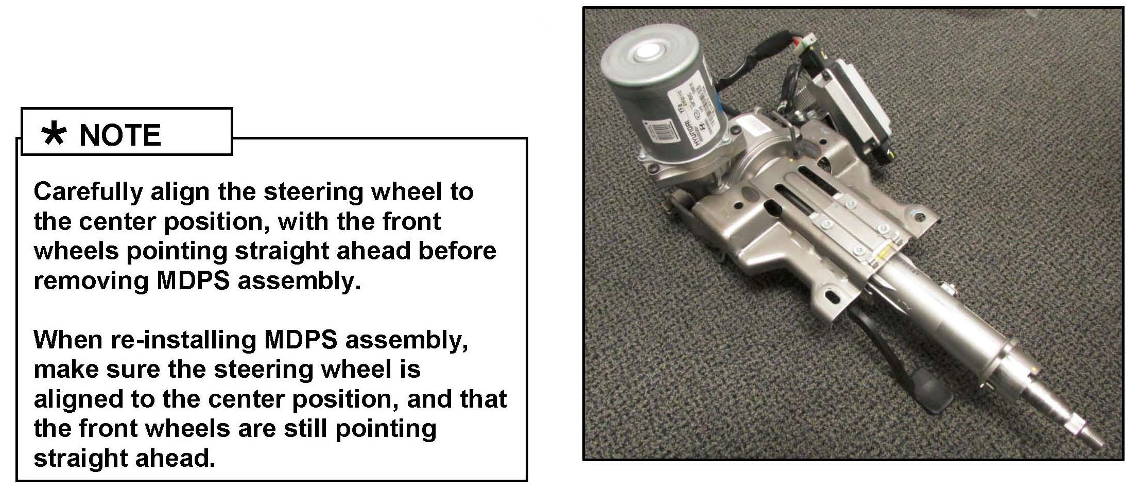

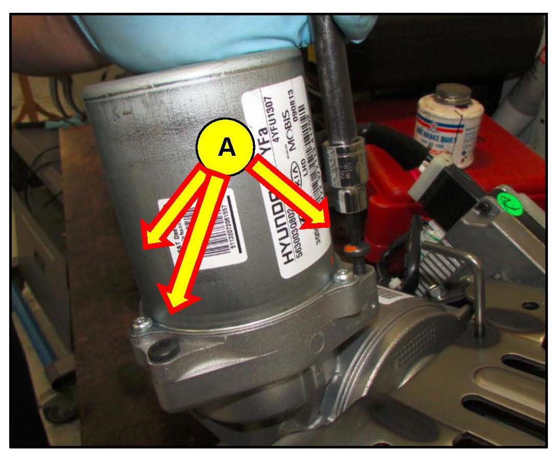

The clicking you hear is likely the cause of a rubber coupling in the motor driven power steering unit (MDPS). There is actually a technical service bulletin (TSB) related to the clicking. If you look at pic 1, it shows the coupling I'm referring to.
As you can tell, it isn't something that is easy to replace. In fact, to replace the coupling requires disassembly of the MDPS and computer programming to get it properly working again. Honestly, I feel this is a dealer repair unless you feel comfortable and have the tooling needed.

YF SONATA MDPS COUPLING REPLACEMENT
pic 2
Description:
This bulletin describes the procedure to replace the flexible rubber coupling in the MDPS (motor driven power steering) assembly to address a minor clicking noise when turning the steering wheel in some Sonata (YF) vehicles.
Applicable Vehicles:
Sonata (YF) vehicles produced from SOP to 12/11/2013

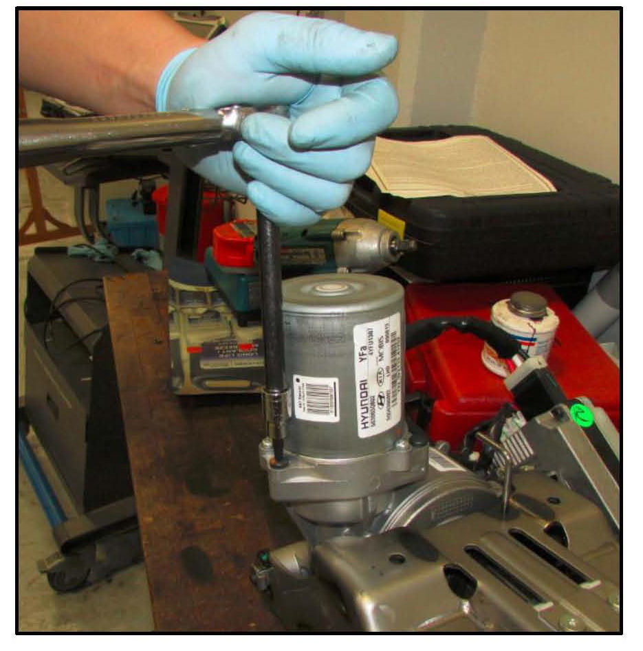

1.Remove MDPS assembly from the vehicle (refer to shop manual for removal procedure).
pic 6
2.Loosen the 3 bolts (A) to remove the MDPS motor using a T25 socket, or similar tool.

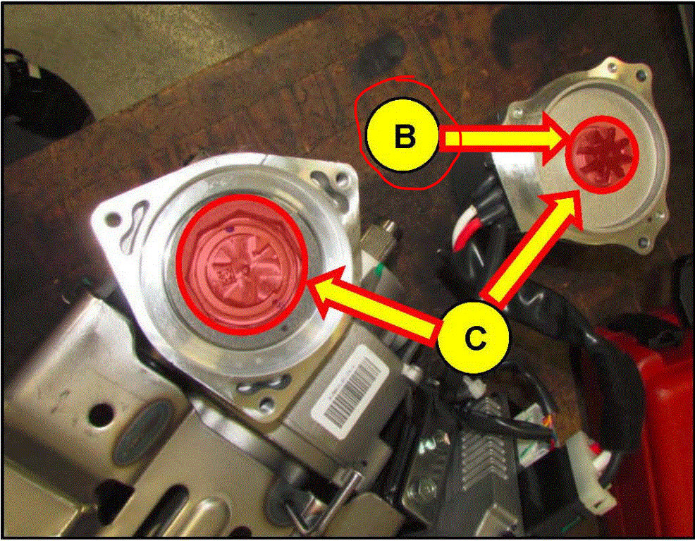

3.Remove rubber coupler (B).

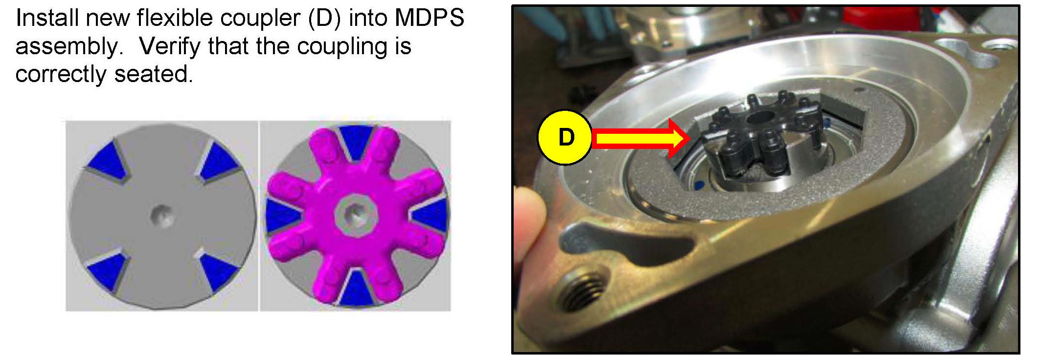

Use an air gun or brush to remove all debris around the coupling seating areas (C).
pic 8

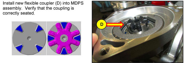

4.Install new flexible coupler (D) into MDPS assembly. Verify that the coupling is correctly seated.
pic 9

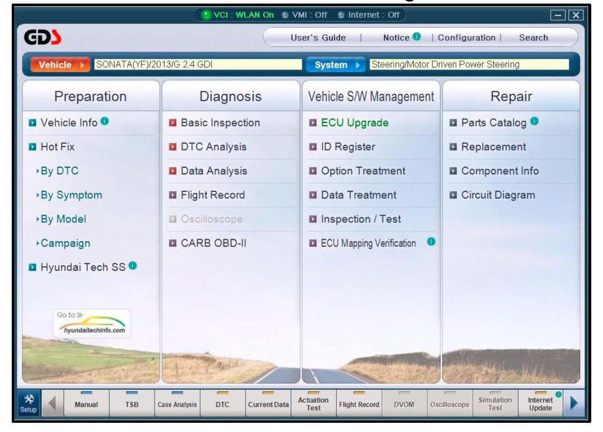

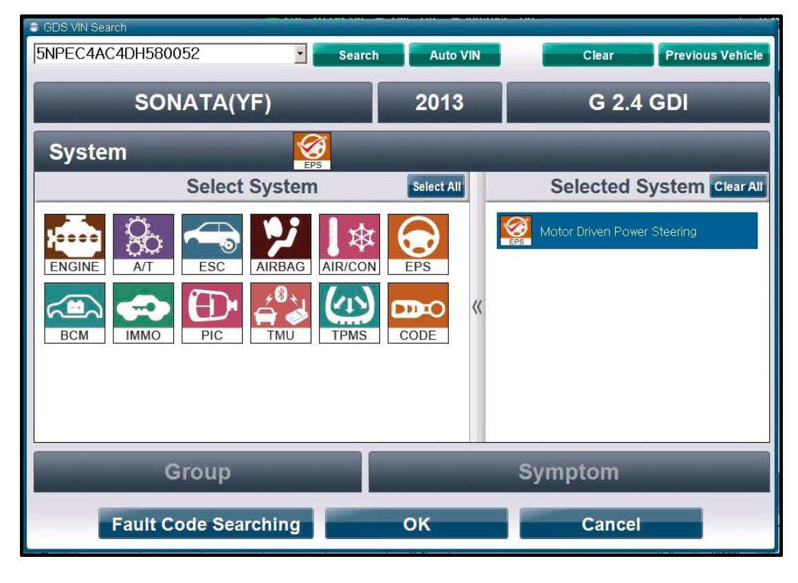

6.Connect GDS VCI to DLC connector. Connect VCI to GDS using USB cable.
Turn the ignition ON and verify that all electrical systems turn off (no electrical load).
Select model and EPS (Electric Power Steering) system, then press "OK" button on the screen.

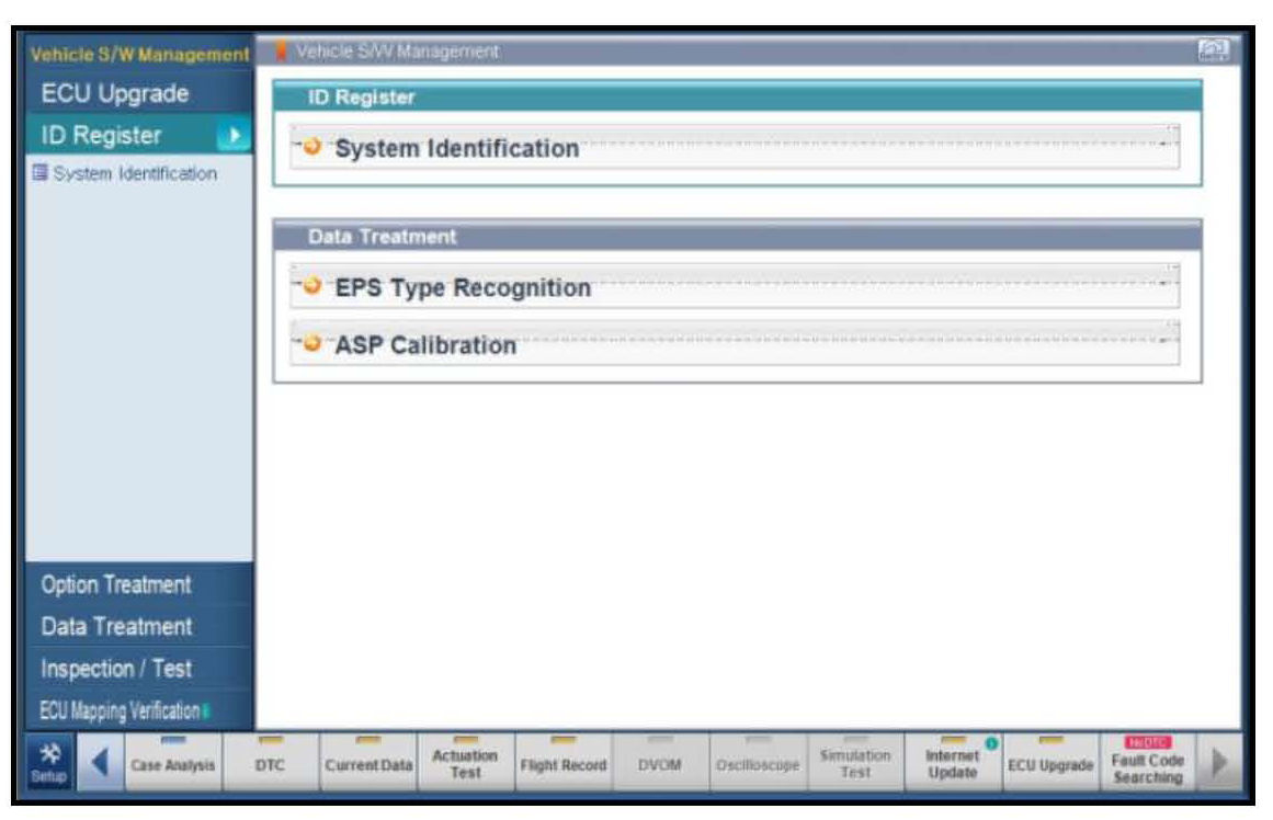

7.Select "Option Treatment" under the Vehicle S/W Management tab.o
pic 12

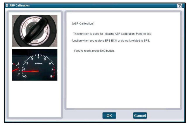

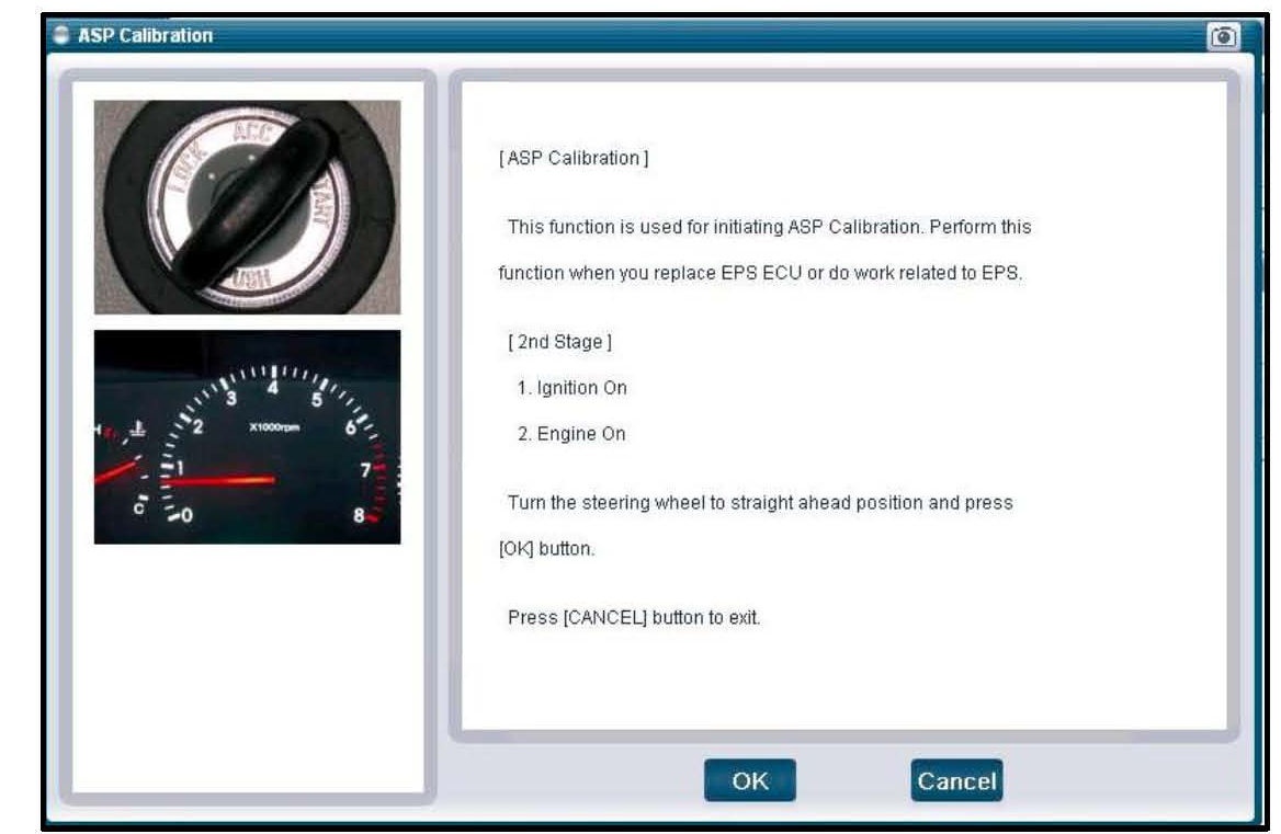

8.Select "ASP Calibration."
pic 13
9.Press "OK" to continue with ASP calibration.
pic 14

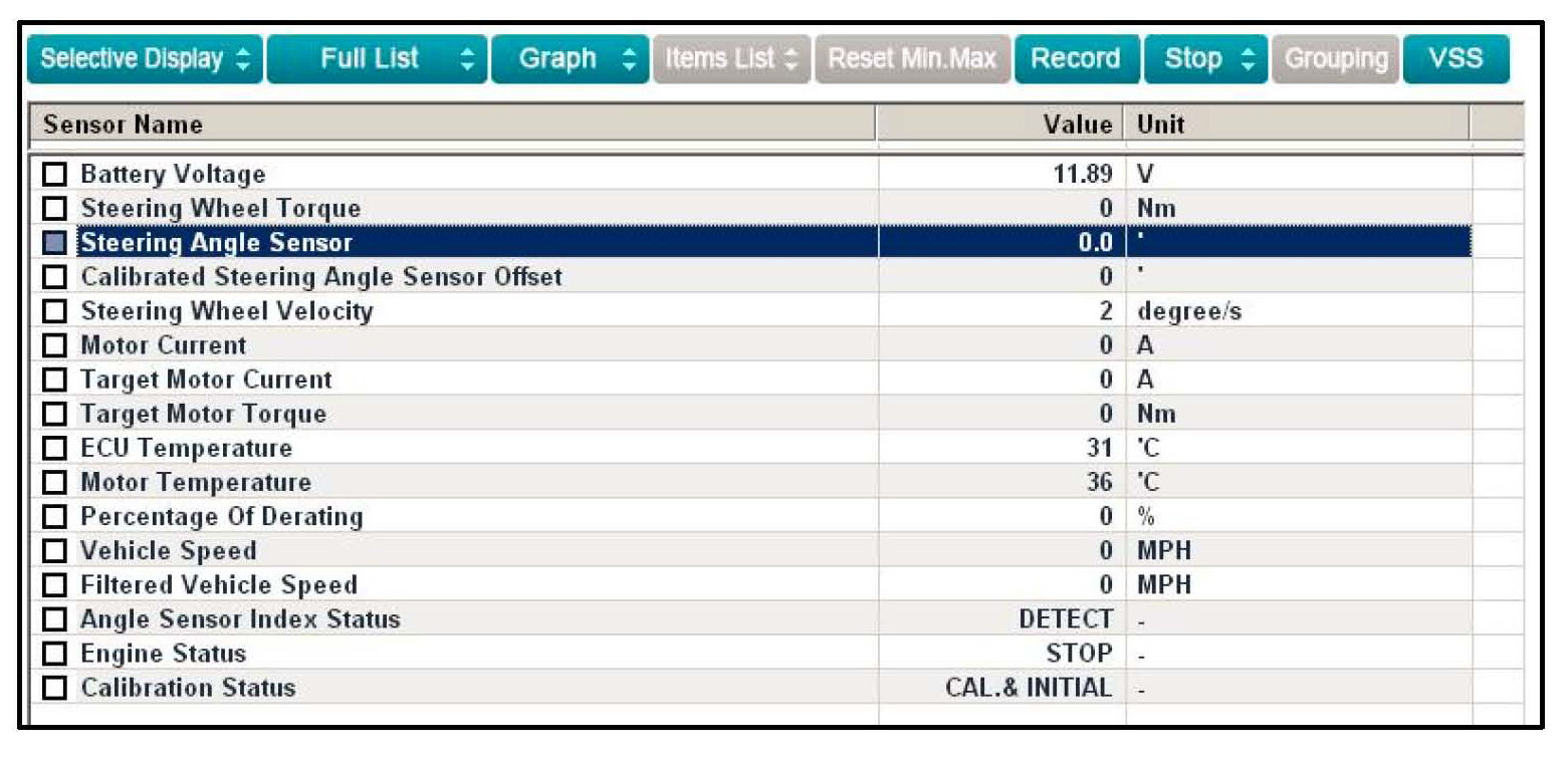

10.Center the steering wheel with the ignition ON and engine idling, then press "OK."
pic 15

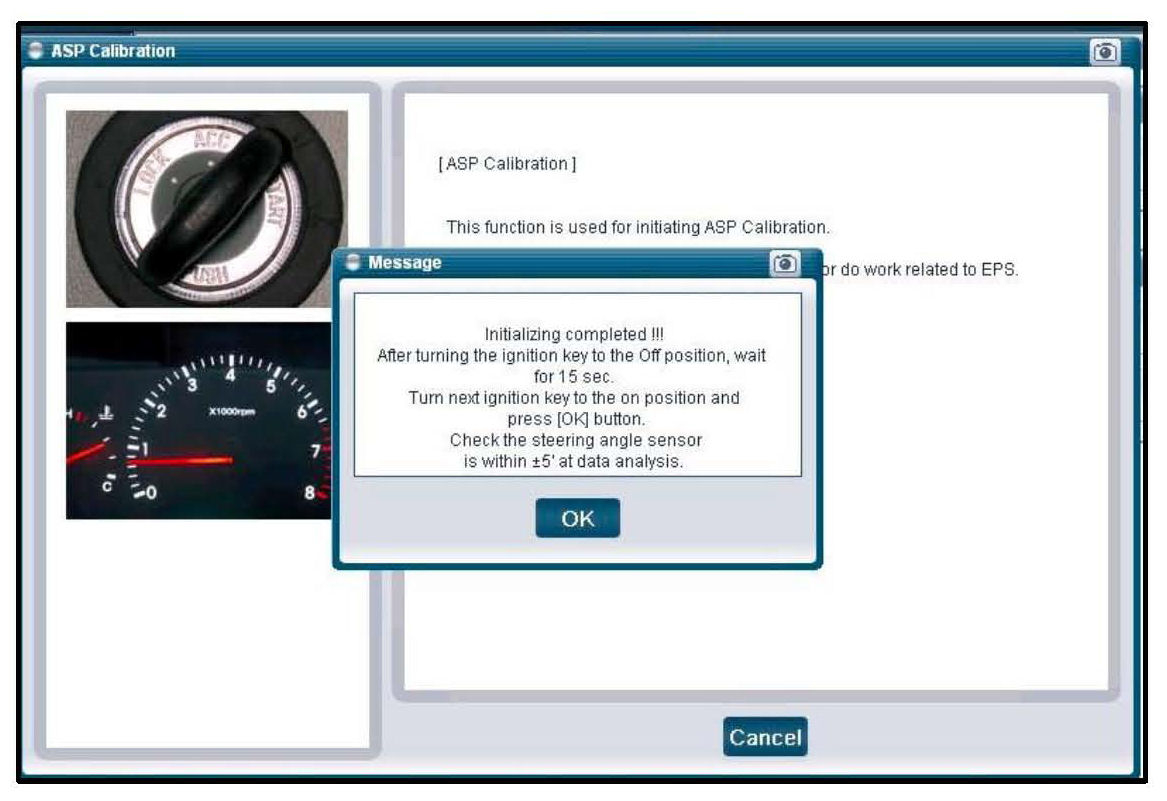

11.Turn the ignition OFF and wait for 15 seconds. Then turn the ignition ON and press "OK."
pic 16
12.Under Current Data, verify that the Steering Angle Sensor value is at: 0.0 5.0 degrees
