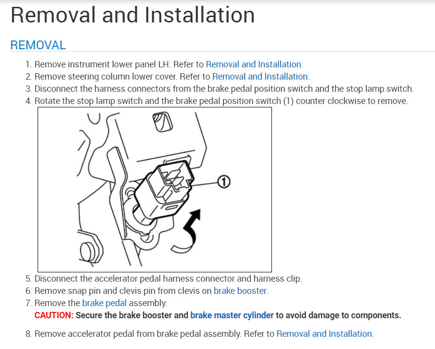

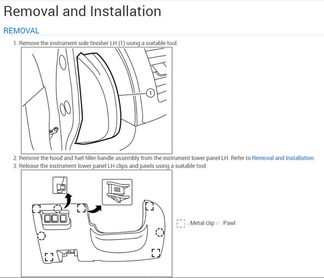

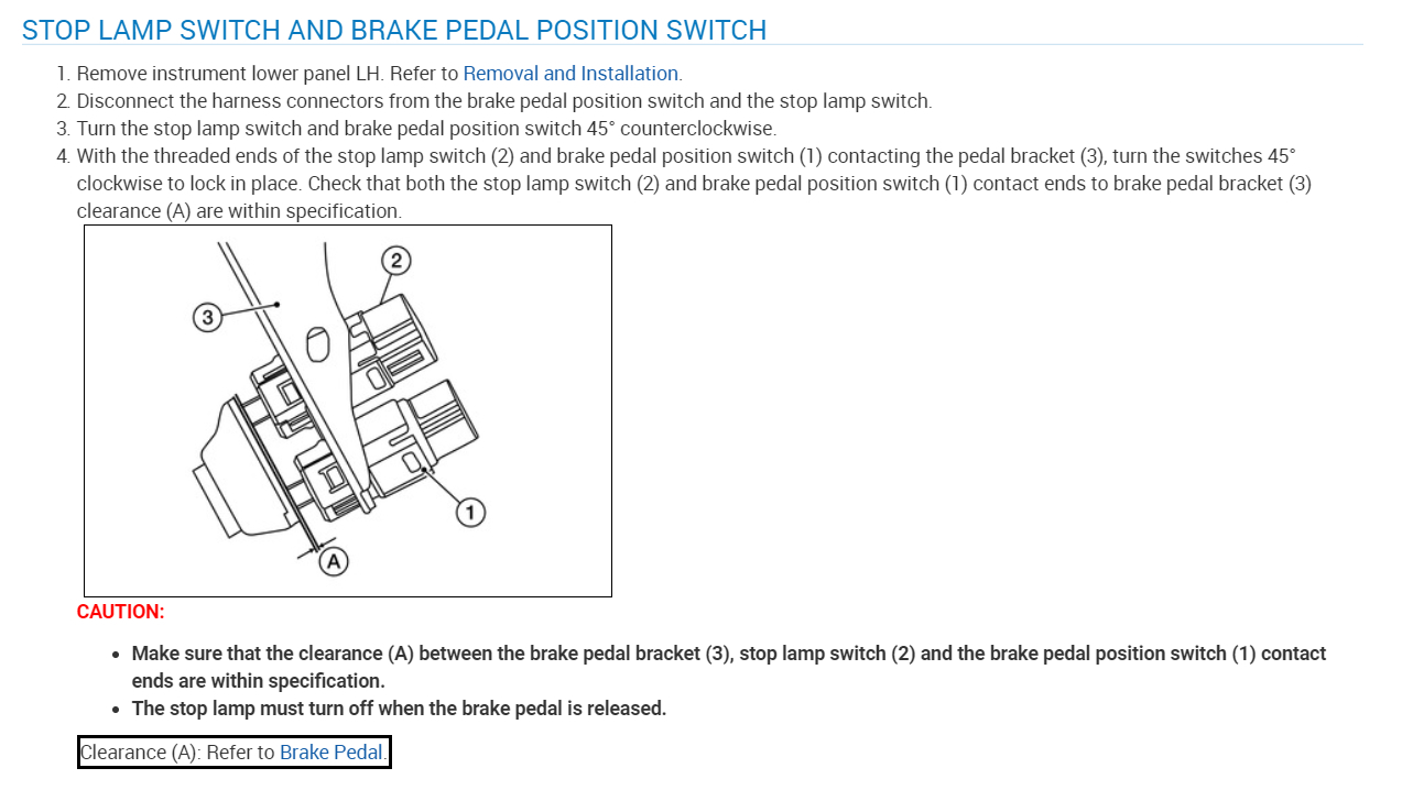

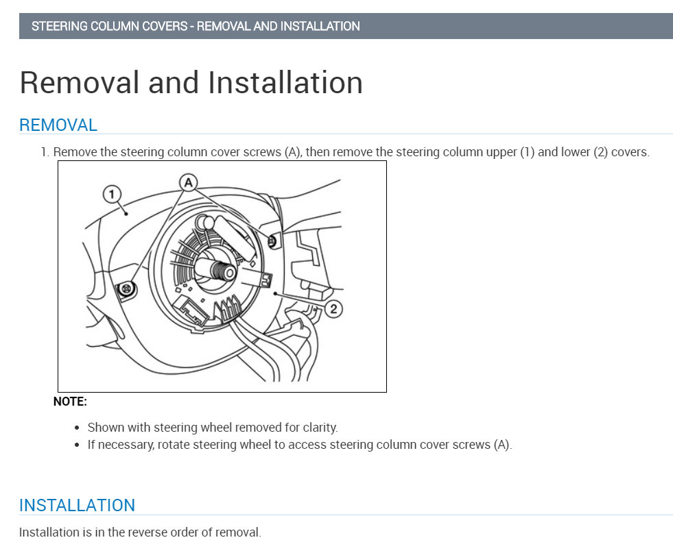

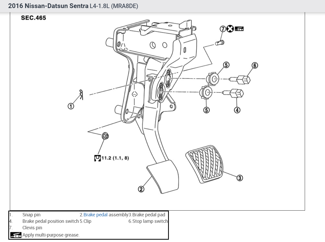

I need to replace the brake switch stoplight, but cannot access it well unless panel is removed.
Sep 1, 2019 at 11:11 PM
  • 55,423 POSTS
Here are the instructions on how to change the brake light switch in the diagrams below. Please let us know if you need anything else to get the problem fixed. Can you please shoot a quick video with your phone so we can see what's going on? that would be great. You can upload it here with your response.
