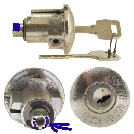

Ignition key would not turn. I bought a key-lock cylinder to replace old one. I took cover off got to the cylinder was able to turn key start my car, but could not get the steering wheel to unlock so to replace the cylinder. Do i have to drop the entire column to the ground in order to unlock steering so i can replace the cylinder?

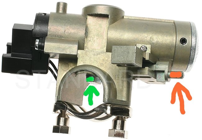

If they key will turn and start the engine, but you cannot unlock the steering wheel to steer you will need to drop the column to replace the lock assembly.
It starts with you inserting the key, than you step on the brake (which moves the orange piece and you rotate the key. As it rotates the cylinder moves the purple piece in the second picture which rotates a cam inside the housing that pulls the green part down and unlocks the steering column and wheel. In your case it seems that part is not moving. Now as you managed to get the vehicle to start it would seem that the ignition switch is okay and the lock cylinder is okay.
Now the book says that to change the actual column lock part you need to remove the steering wheel, remove the covers, remove the multi-function switch. Then drop the column so you can get to the two bolts that actually hold the locking mechanism in place. Which you then use a chisel or Dremel type tool to create slots to turn them out.
However, It may be possible to skip a lot of that mess if you can remove the plastic covers and actually see the two bolts that secure that part to the column. Then it would be much simpler to just remove the column bolts (two or four depending on build date). Drop the column down cut the slots and remove the bolts. There appears to be a screw in the bottom that holds the multi-function switch to the locking assembly so do not forget it.

If the key doesn't move the replacement of the entire assembly is a faster and easier repair. Replacement of just the cylinder is possible but it does require that the cylinder move.
Replacement of the entire lock assembly is listed with a book time of 1/2 hour so it's probably cheaper as well.
