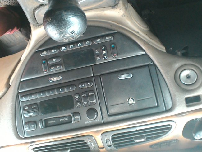

This vehicle was opened without the key and when the battery was put and the terminals connected, the vehicle steering was locked. Please who knows the security code I can use to unlock the radio and steering wheel.

Okay, this is the serial number from the radio:
VIN:SAJAD01L21FM12762
SERIAL NUMBER:BPJYM006395

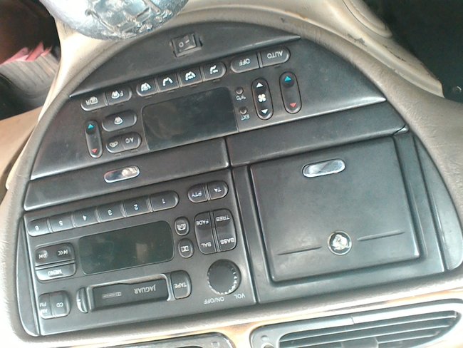

Hello! Good morning, thanks for your assistance but I want you to know that the radio is not touch screen and I don't think it will work. Look at the image below.

Are the same buttons indicated in the video on this radio as well?
Aug 18, 2021 at 3:03 PM
MALLYBOY
  • 329 POSTS
Are the same buttons indicated in the video on this radio as well? No, that was why I said it will not work.
