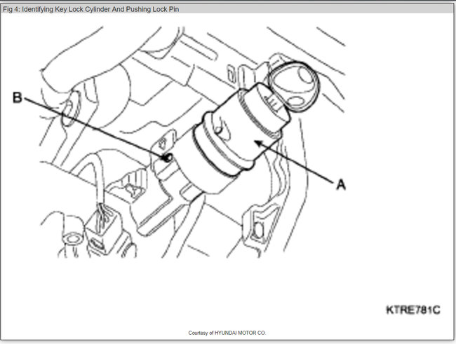

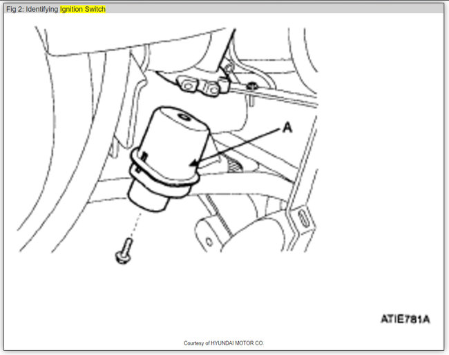

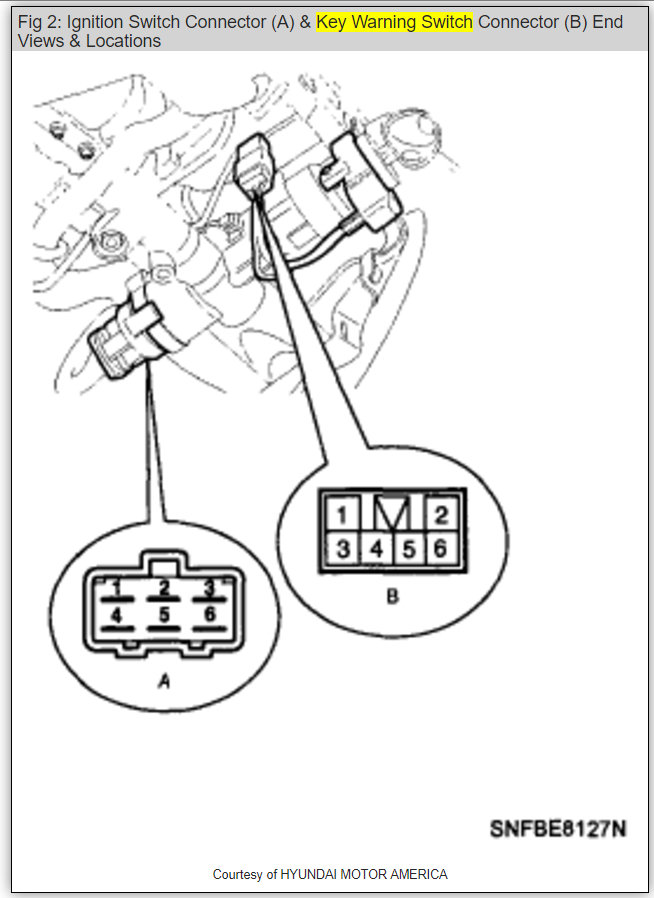

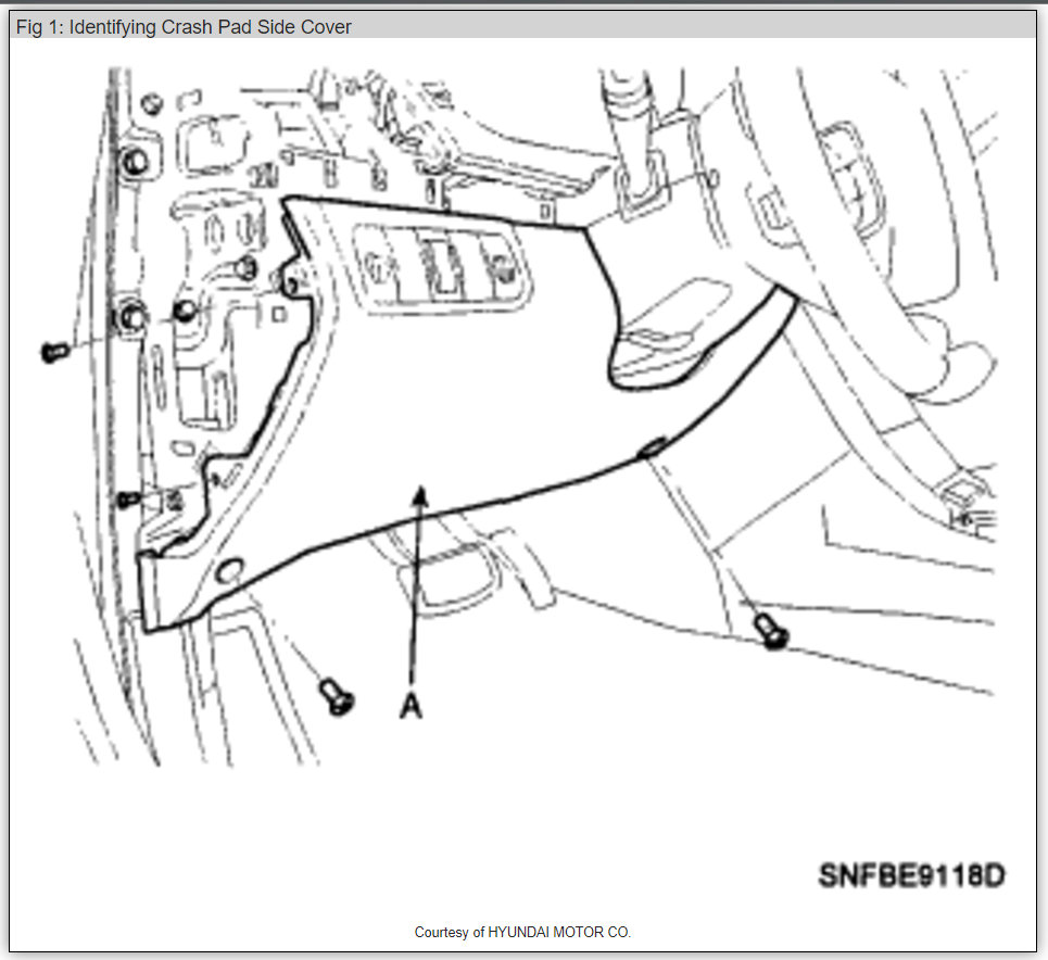

What happens is the ignition key and tumbler become worn out and the lock part stops working. You must replace the key and tumbler combination. You will need to have the new keys programmed by the dealer or a garage that can do it, call first.
Here is what the repair consists of (below)
Please let us know what happens and upload pictures or videos of the problem.
