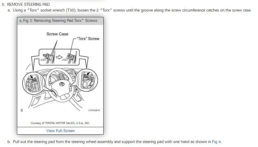

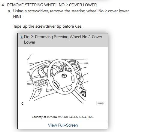

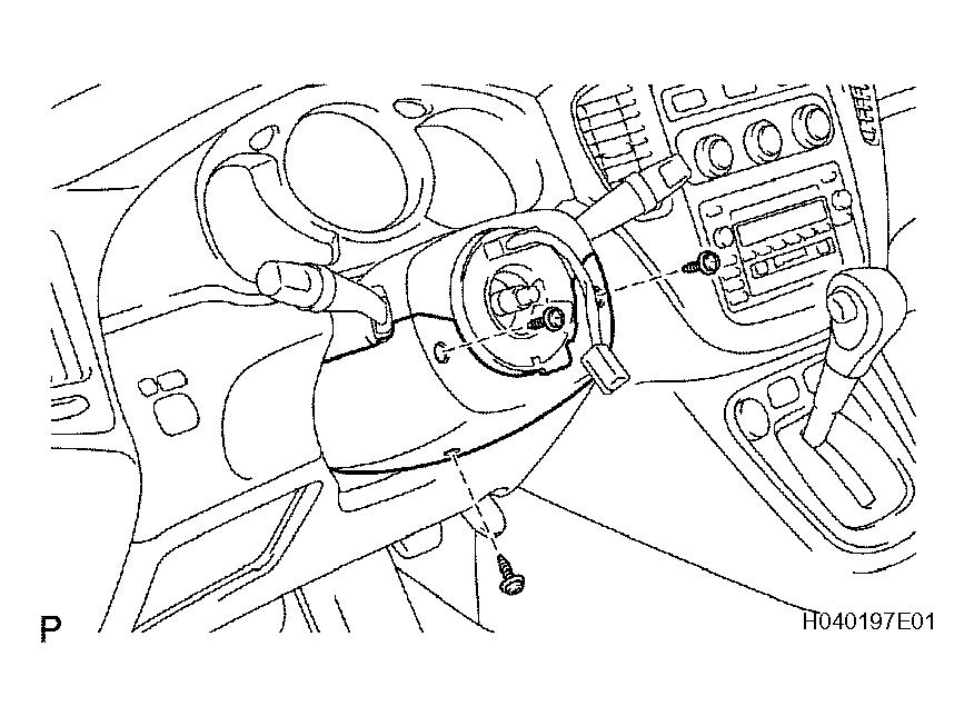

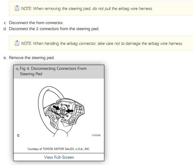

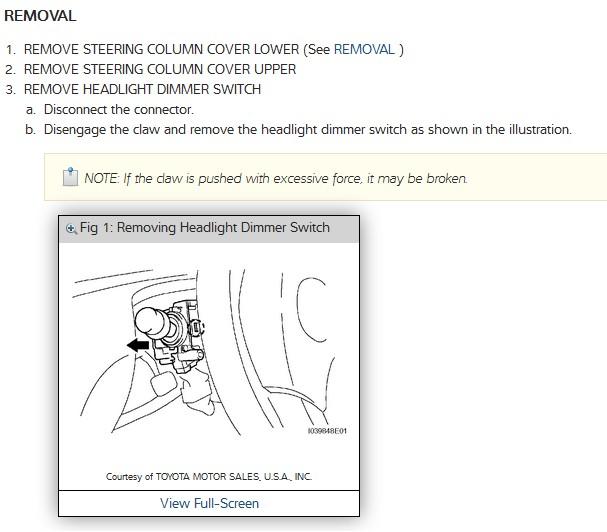

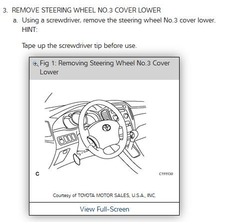

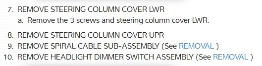

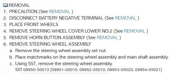

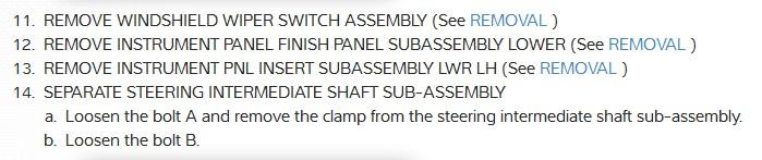

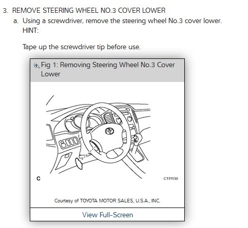

Can you please tell me how the horn pad comes off the steering wheel on a 2006 Toyota Highlander Limited.
I need to replace the cruise control switch lever which is broken.
I would also like to know the cost of the cruise switch lever,
My vehicle has automatic light control, but that switch lever on the other side is working fine.
Any help you can give will be greatly appreciated.
Feb 15, 2014 at 12:03 PM
OBXAUTOMEDIC
  • 3,719 POSTS
Ok, you would be best off to call around to your local parts stores to get a price on the switch. Attached are images and instructions to remove steering wheel and switch. Probably won't be in correct order but sure you can figure it out.
