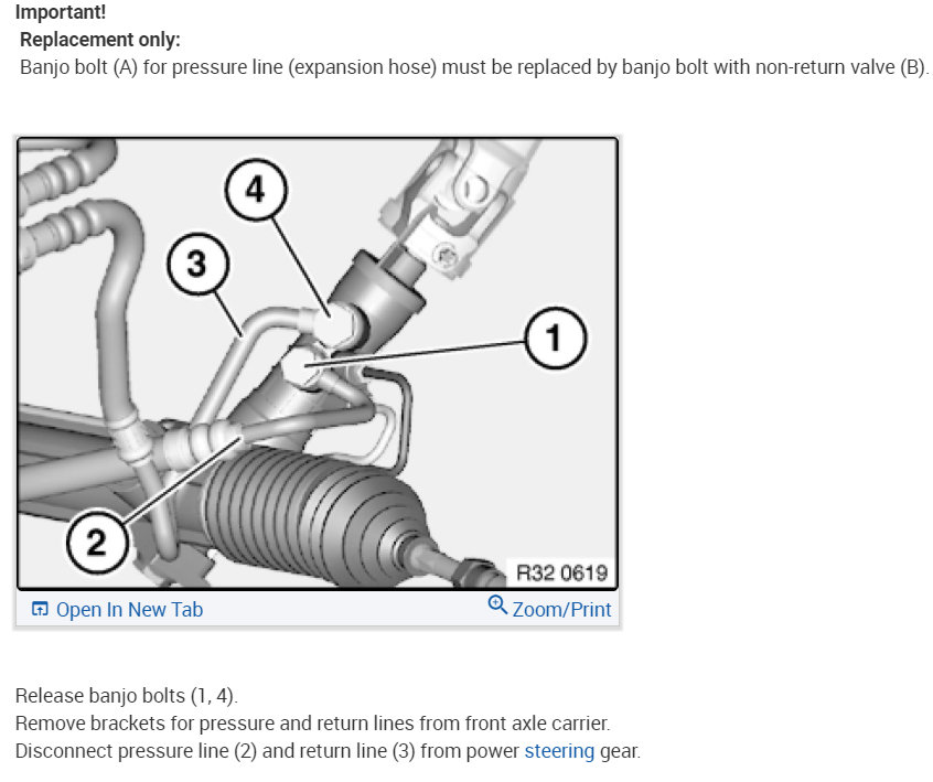

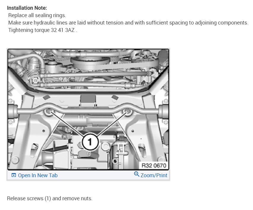

  • 55,732 POSTS

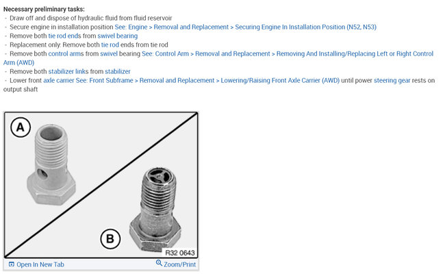

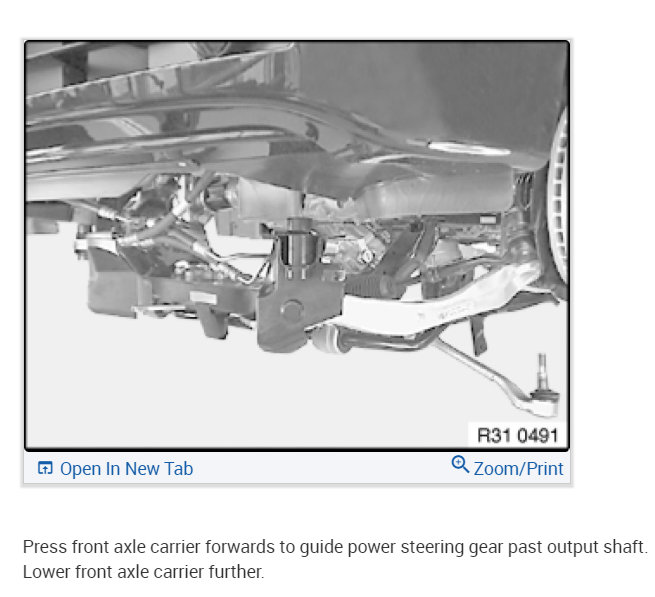

If the alignment does not fix it it sounds like the rack and pinion is going out. Here is information (below) on how to replace it, cost and labor time.
Parts Information OEM Part Price
Steering Gear
4 - Steering Gear 32106780124 $2646.65
Complete Assembly With Transfer Of Parts B 6.2 hrs
Does Not Include: Wheel Alignment.
Nov 1, 2018 at 6:31 AM

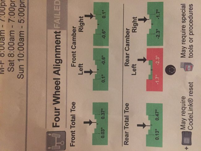

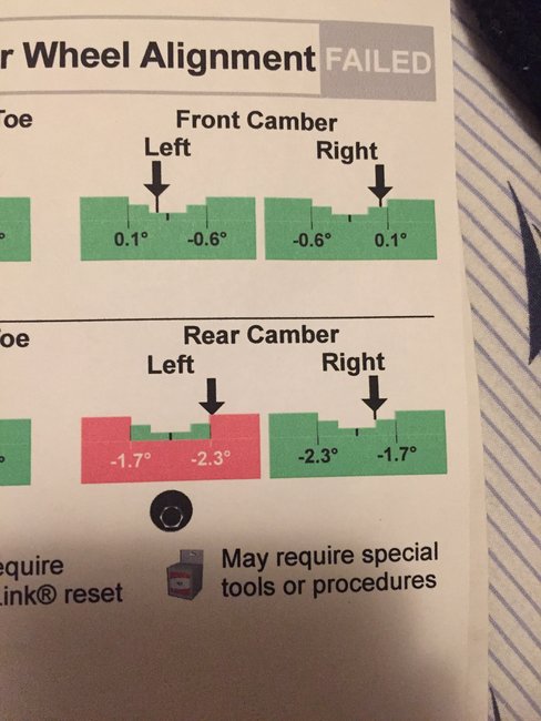

I went and got a wheel alignment and they said that the left rear camber needs to be adjusted but I have to go to the dealer to do so.
Nov 5, 2018 at 12:12 PM
JONNYB1963
  • 263 POSTS
So the front alignment was okay then? Just curious, what does it say about Caster? That part was cut off on the picture you attached.
If the caster turns out to be okay, then I would be inclined to agree with Ken in that you have something binding in the front end that is preventing the wheel returning to center by itself.

Here is the full picture:
Nov 6, 2018 at 11:42 AM
STEVE W.
  • 15,415 POSTS
For poor return to center the caster would need to be way off. The wrong camber in the rear that picture shows would not cause it. However that reading suggests either worn bushings in the rear suspension or something was slightly bent.
Your issue is in the front suspension, as it was there before the new struts and mounts were installed I would look at other components first. Namely the steering rack, the tie rod ends and the lower ball joints/swivel bearings. It would only take binding in one of them to cause this issue. A simple test would be to jack the front end up enough to get both front tires off the ground. With the engine running, put your hands on either front tire at the 9 and 3 positions and try to turn the tire like you are making a turn. Does it move freely or do you feel an easy then hard spot like binding? If you turn the steering wheel does it feel smooth as you turn or does it get stiffer as you turn it back/forth? Do you hear anything like creaking or popping as you turn the wheel?
