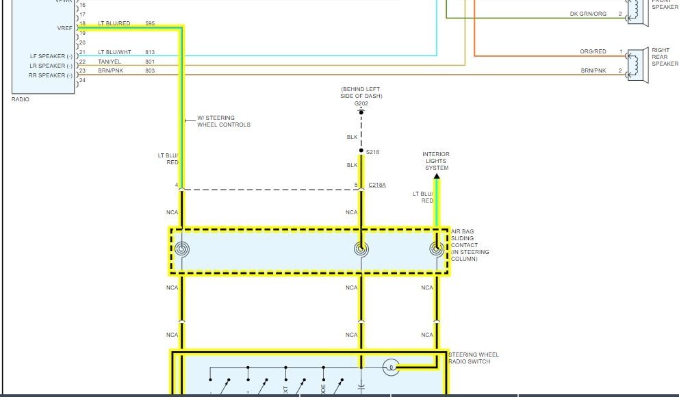

We switched the steering wheel and cluster on the truck from an xl to a Lariat wheel, with radio and options controls on it!
The speed control works but i don't have the harness for the options button for the cluster or the radio or A/C buttons? Do i need to add a controller or module to it??
Thank you very much!
Jun 18, 2020 at 4:19 PM

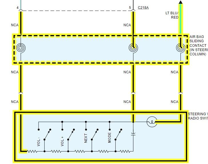

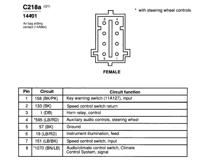

Good morning,
I attached the wiring for the radio. I attached the connector that contains the 2 wires for the radio control.
Can you verify the wires are there in the connector?
