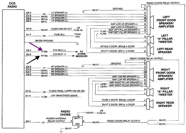

I am trying to find out what wires go to the steering wheel controls so i can connect my aftermarket stereo to them. i can't seem to find any diagrams that tell me which wires they are.
Apr 5, 2019 at 4:29 AM
CARADIODOC
  • 34,414 POSTS

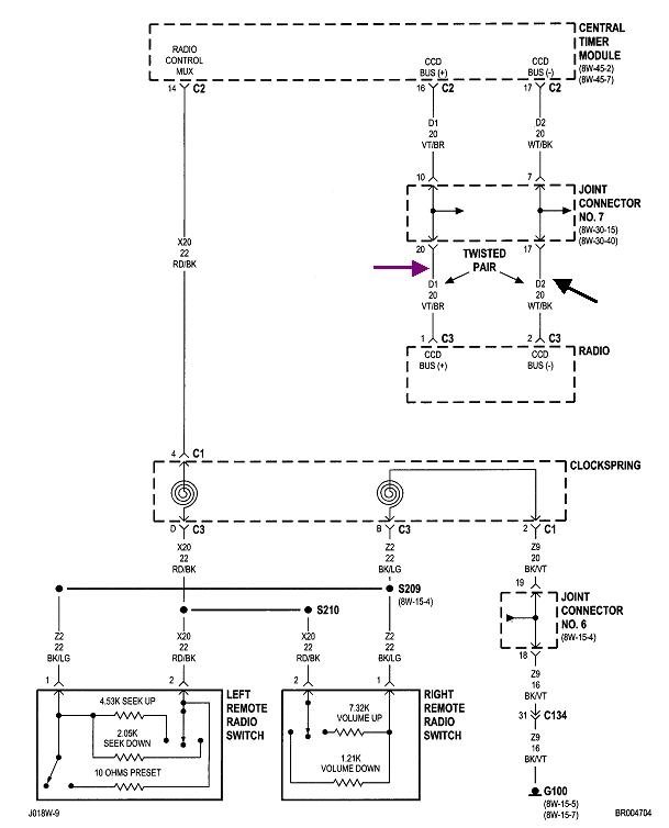

There are no multiple wires for those functions. It would not be practical to try to run dozens of wires through the clock spring. That's a wound-up ribbon cable in a plastic housing, under the steering wheel. Instead, they use a type of multiplexing system where a pair of wires are connected to all of the switches, and each switch switches in a different resistor. That makes a different voltage appear on those wires. The computer interprets each voltage as its corresponding function.

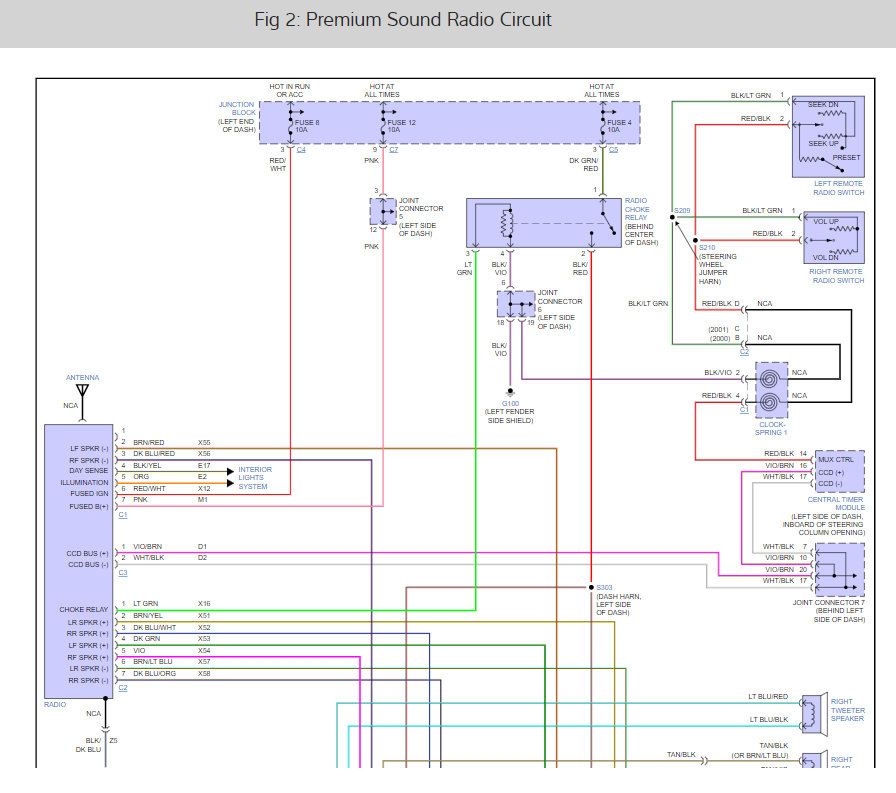

The best radio for your model is the CD / cassette combo radio, even if you don't have cassettes. That radio is built by Mitsubishi for Chrysler and is the highest quality radio I've ever worked on. If you're going to downgrade to an aftermarket radio, check places like Crutchfield and Best Buy for a converter made for this purpose. The aftermarket industry is always a few years behind, but when they catch up, they do a pretty good job of building ways around what the car manufacturers designed. Here are the wiring diagrams for the radio and clock spring (spiral wire). Check out the diagrams (Below). Please let us know if you need anything else to get the problem fixed.

The back of my new stereo has a wire for steering wheel controls, which wire would i tap into the white or the purple one?
Apr 5, 2019 at 8:15 AM

My understanding is Chrysler still uses three data busses, so any exchanging of information has to take place inside a computer that takes it in on one buss, interprets it, uses what it needs, then sends the translated data out on a different buss. This one originates in the Body Computer. Chrysler's name for that in their truck models is the "Central Timer Module", (CTM). That's shown in the upper right of the second diagram.

As for which wire to use, they both send the same signals, but mirror images of each other. Both have six volts on them put there by the Central Timer Module. The signal on the "CCD+" wire is a digital square wave that goes only about 0.2 volt higher. To say that a different way, the signal pulses between 6.0 and 6.2 volts. That tiny voltage makes it susceptible to stray electromagnetic interference from all the adjacent wires, especially those that run parallel to each other. That's why you'll see them listed on the diagrams as a "twisted pair", and that's how you'll find them in the truck. Any interference that generates a voltage spike in one wire will do so equally in the other wire. The net difference is zero, and those signals will cancel out.
The "CCD-" wire has an identical signal, but upside-down compared to the CCD+ wire. It's signal pulses between 6.0 and 5.8 volts. By having two twin signals, each computer on that data buss can be sure it's seeing the correct signal. Minor spikes on one wire can be ignored.
Think of the data buss as the two wings on a bird. He won't get far with just one wing. You're asking which wire to connect your radio to. To use a true data buss to communicate with the steering wheel switches, through the Central Timer Module, your radio needs both wires too. If it only requires one wire, my first concern is you won't have that twisted pair. Keep that wire as short as possible because it is going to act like an antenna for stray voltage spikes. The heater control, fan motor, even the dash lights could inject signals onto the data buss and confuse the other computers. The dash lights use "pulse-width dimming" meaning they are pulsed on and off 400 times per second, and the ratio of on-time to off-time is varied to adjust the brightness. That's 12 volts that is switched rapidly on and off, and that creates voltage spikes. That's highly-desirable in an ignition coil, but it must be avoided in other applications.
If I had to make an educated guess, when using just one data buss wire, I'd choose the "CCD+" wire. If that works, I would expect to see something to that effect in the radio's owner's manual.
Please remember, the digital signals on a data buss are totally different from on / off switch settings, and from the older resistive steering wheel controls on older vehicles. Even in your truck, if you look at the lower left in the second diagram, you'll see the steering wheel switches, and each one switches in a different resistance value. Each switch puts a different voltage on that circuit. On older vehicles, it was the radio that interpreted those voltages to know which function was being selected. Now, with the Central Timer Module, that is what is interpreting those different voltages, then it sends a digital signal out on the data buss for all the computers to see. In this case only the radio cares about that data and uses it. Steering wheel control inputs are simply ignored by all the other computers.
