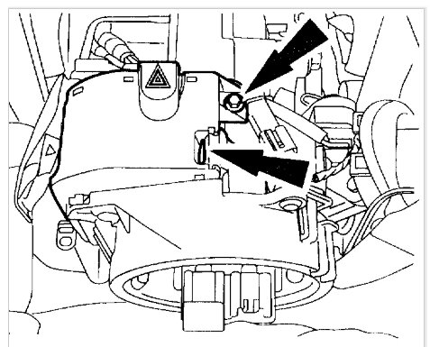

I need a diagram on where the screws are to remove the steering column cover to replace the windshield wiper turn signal switch
Sep 19, 2026 at 12:42 PM
  • 55,746 POSTS

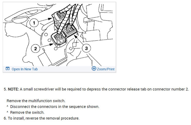

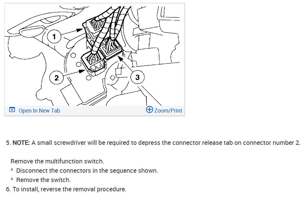

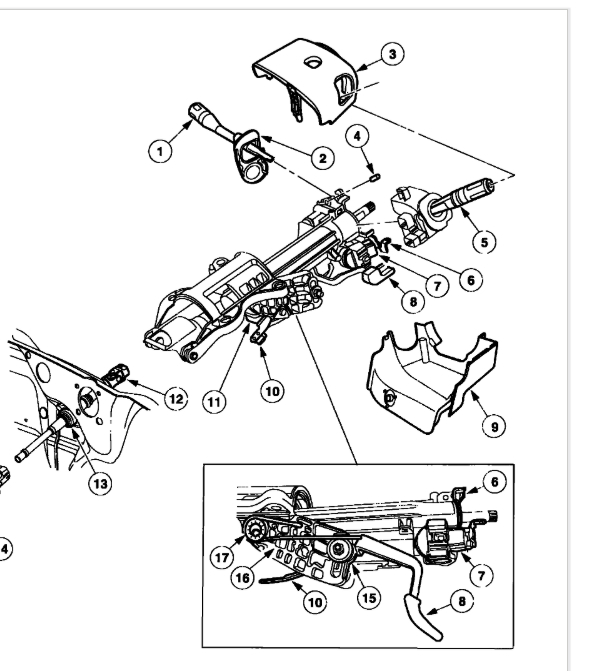

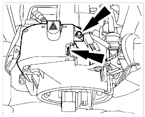

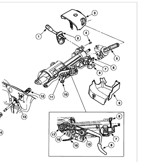

So the screws are on the underside of the plastic cover, look for small holes in the bottom part. Here are some images to help you change out the multifunction switch.
