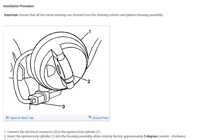

Somebody tried to steal my car. They broke off the under part of the steering wheel and broke the ignition stuff, am i able to get any of that fixed so i can be driving and going back to work? everything else is not damaged.

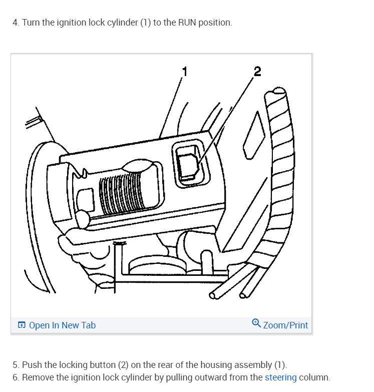

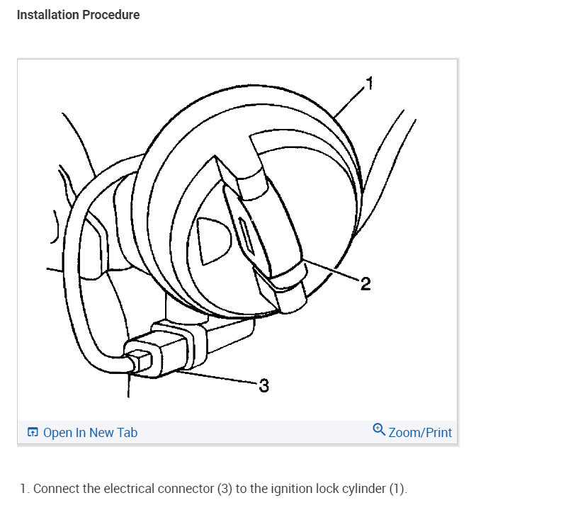

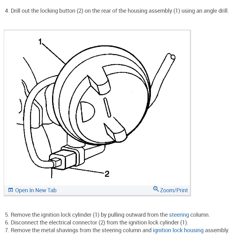

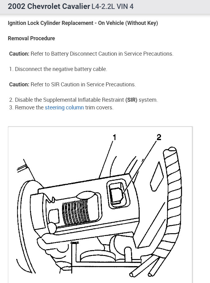

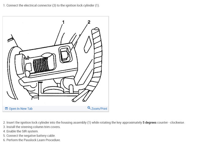

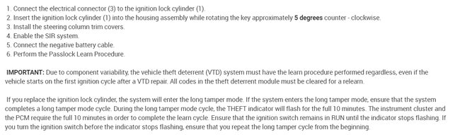

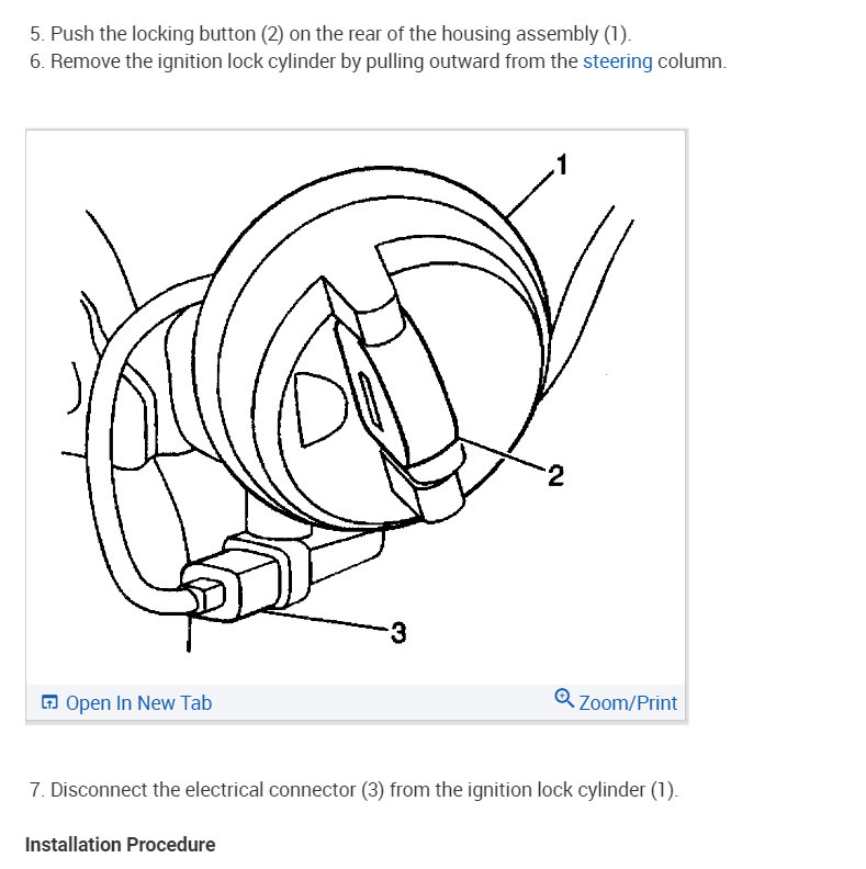

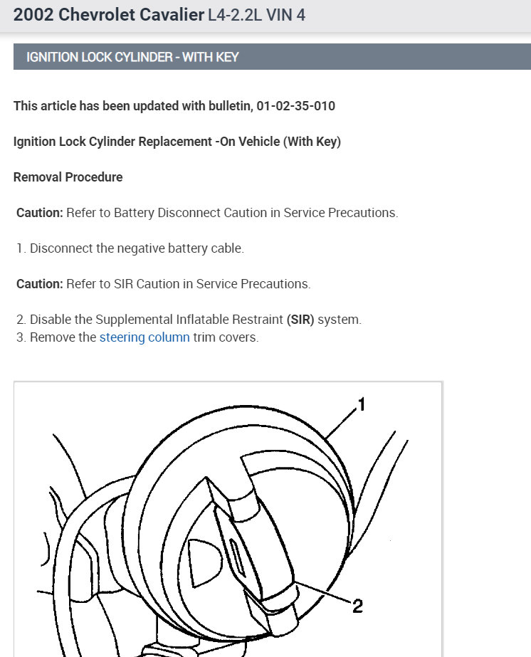

If you upload a picture of the damage, it will help me to see what needs to be done. In the meantime, here is how to change the ignition lock out. When you get a new ignition lock get it from the dealer so they can program it for you before the installation. The first set of instructions is the ignition switch change without using the key the second set is with the key. Check out the images (below). Let us know what happens and please upload pictures or videos of the problem.
