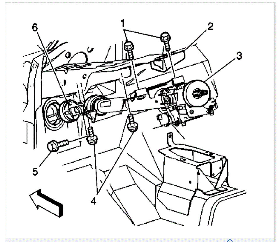

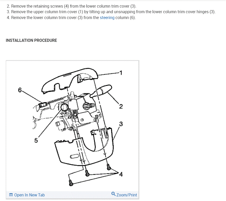

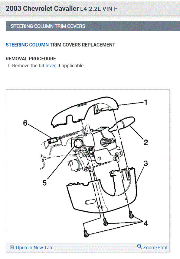

My steering wheel decided to fall when I was driving. It won't stay in place like it's loose or broken. I'm trying to take my column off, but I can't get the borrow part off due to my ignition pegs. I can't take my ignition cover off. That being said I can't get the broom of my column off. How do I get this fixed?

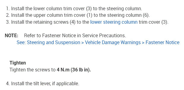

When you say it fell, do you mean the entire column or just the tilt? I attached the directions for removal of the trim cover removal. Take a look at the directions and let me know if that is what you needed.
Also, I added the last pic so you can see where and how the column is mounted.
Let me know if this helps, and any specifics that may help me further help.
