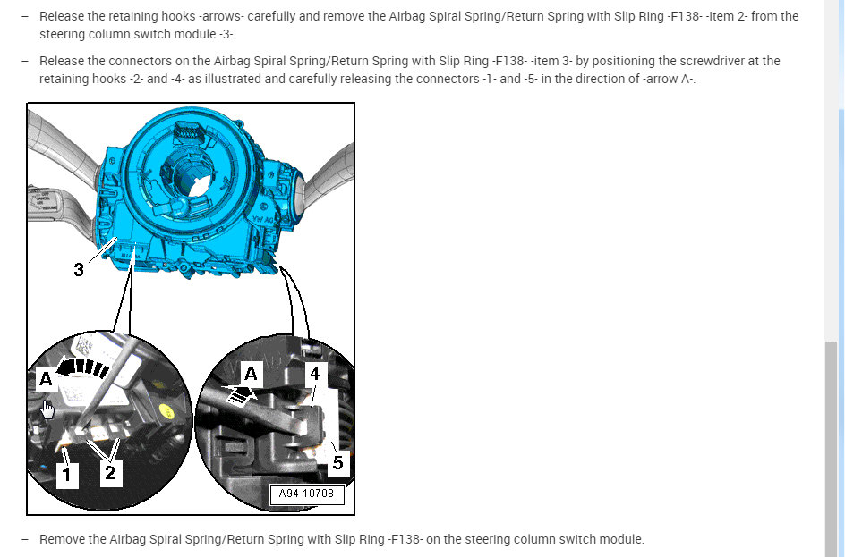

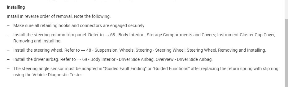

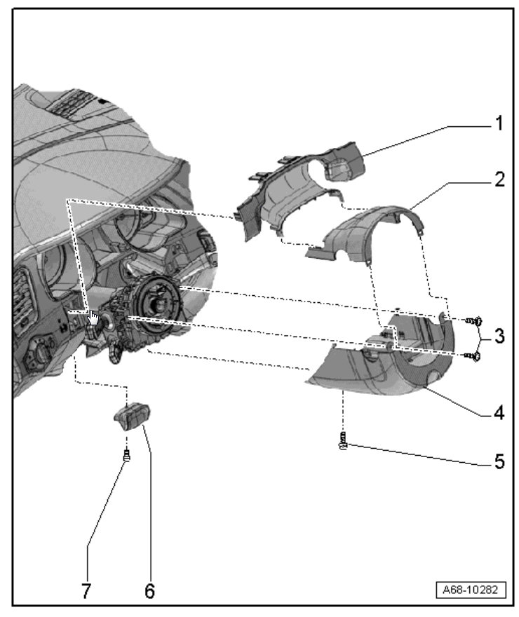

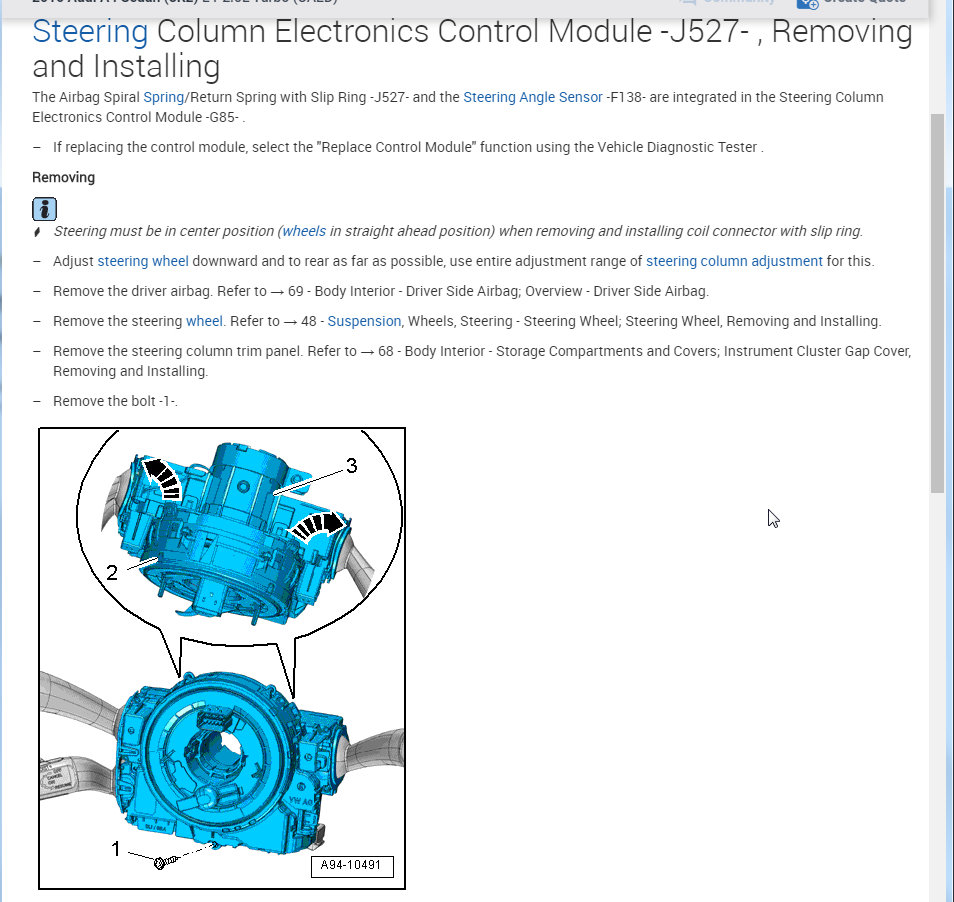

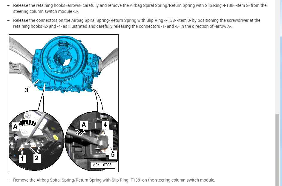

This is called the airbag spiral spring or clockspring. I attached a bit of info on this but if you are going to do this yourself, make sure you disconnect the battery because you will be removing an airbag.
https://www.2carpros.com/articles/symptoms-of-a-bad-airbag-clock-spring
https://www.2carpros.com/articles/steering-wheel-clock-spring-removal
