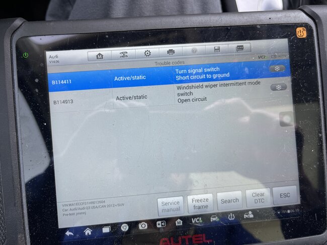

My wife said the airbag light came on. I scanned it and it had a code for high resistance airbag, usually it's the clock spring. The wipers and turn signals worked fine. Radio buttons on steering do not work. High bean works. Horn works. I replaced the spring and did a calibration, and the airbag light went out. The steering radio buttons and menu buttons still do not work. The only codes i have are these. Do you know where the fuse is? Some people talked about a j527 fuse which i do not know where it is

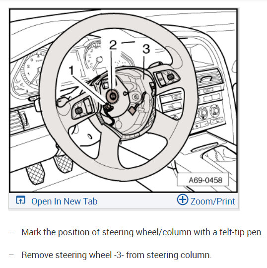

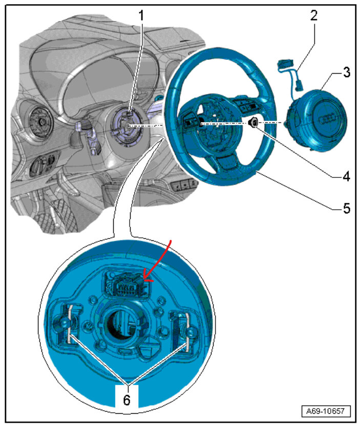

There is no fuse for the steering wheel controls that i can find, to me the spiral spring might be the wrong one or the button cluster on the steering wheel has gone out. Did you match the part numbers to make sure you had the correct part? Also, there is a connector on the spiral spring you need to make sure it gets connected correctly. Please check out the images below to see what I am talking about. Check out the images (below). Let us know how it goes.

It looks like inside the connector there are 12 wires correct? Are some of the terminal cavities empty?

Check out the first image in the post above, it looks like 12 terminals. If this is not connected the buttons will not work.
