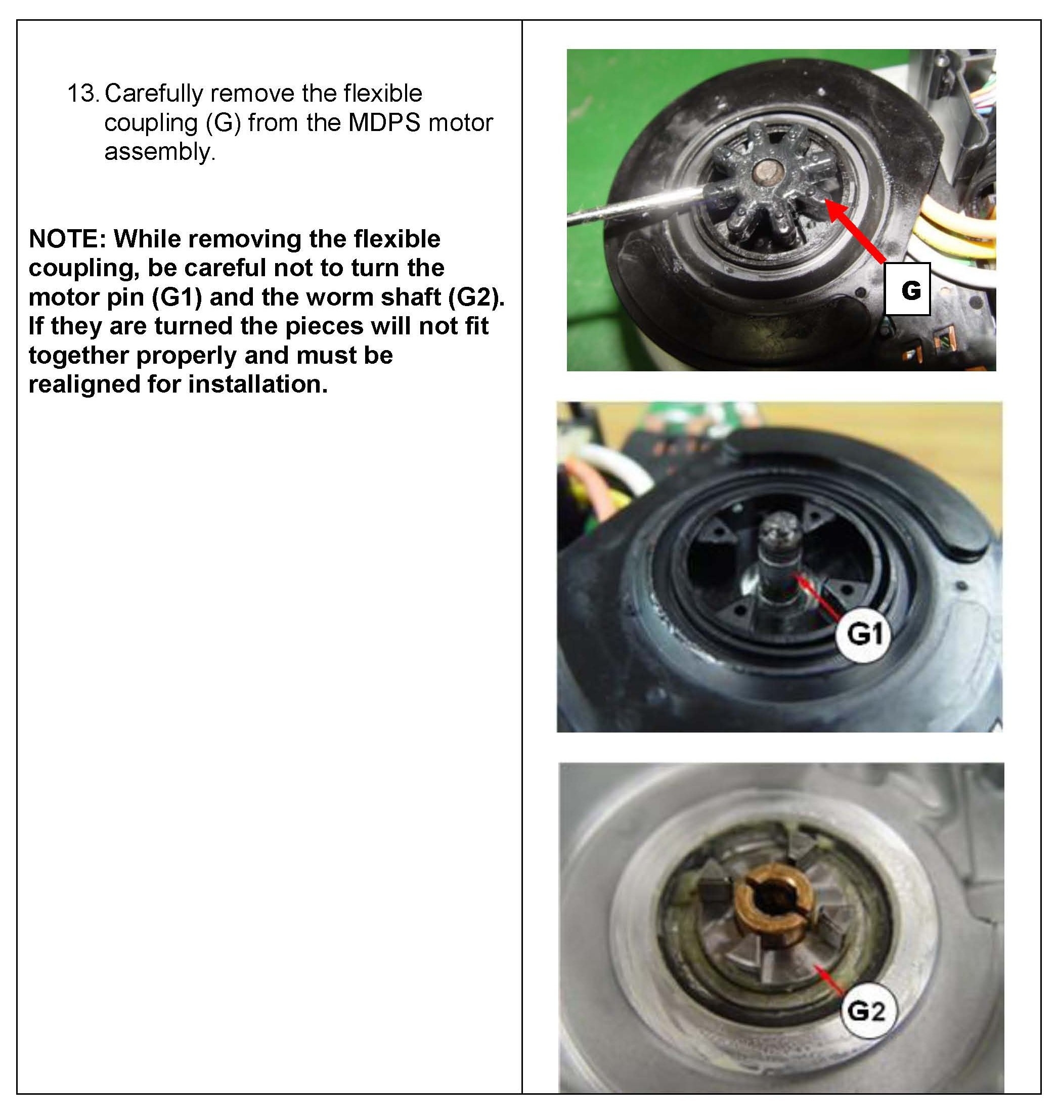

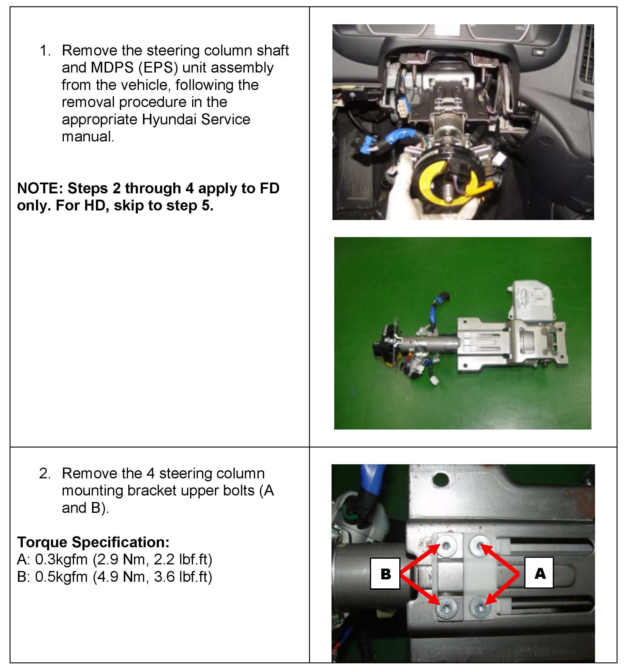

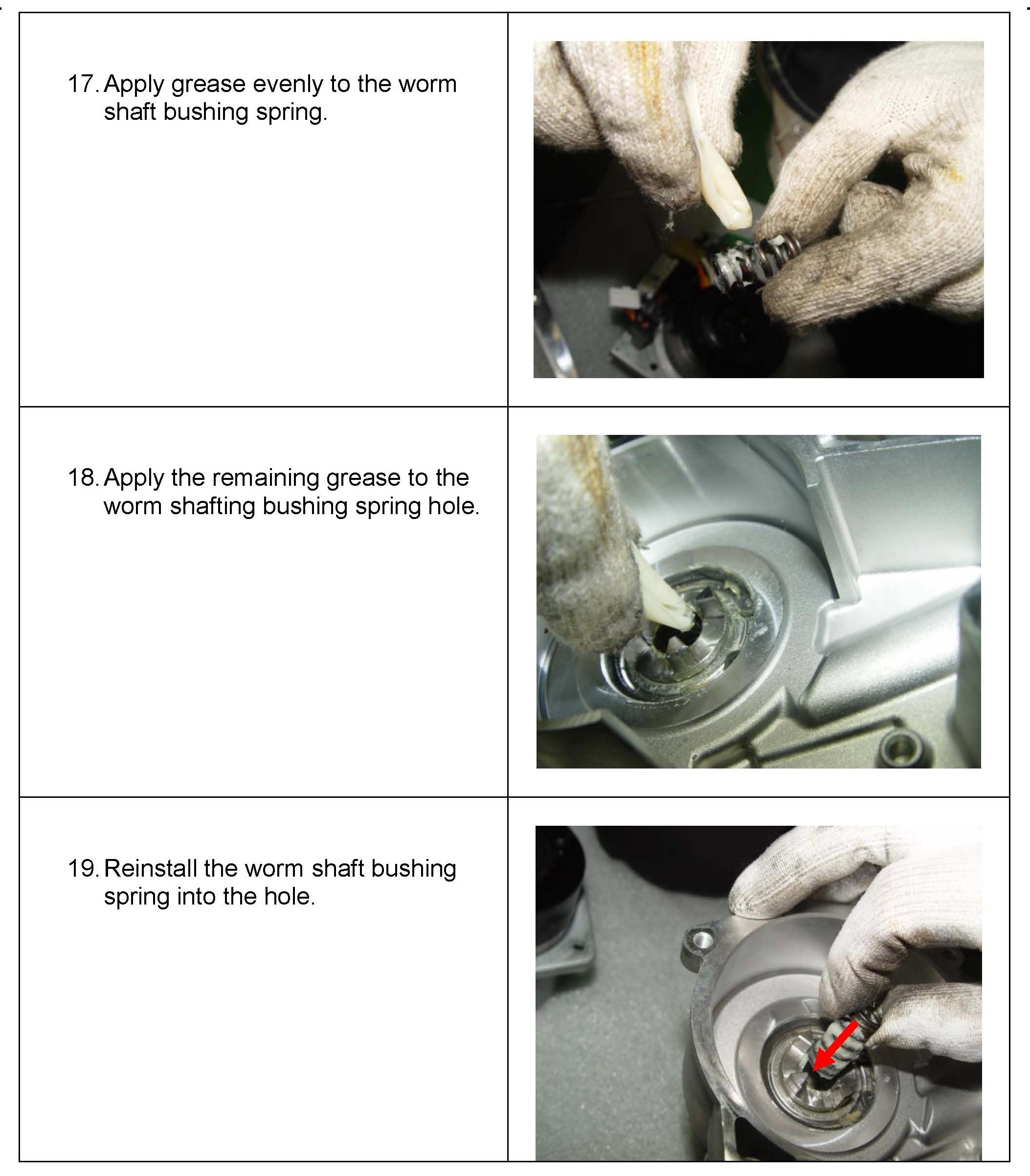

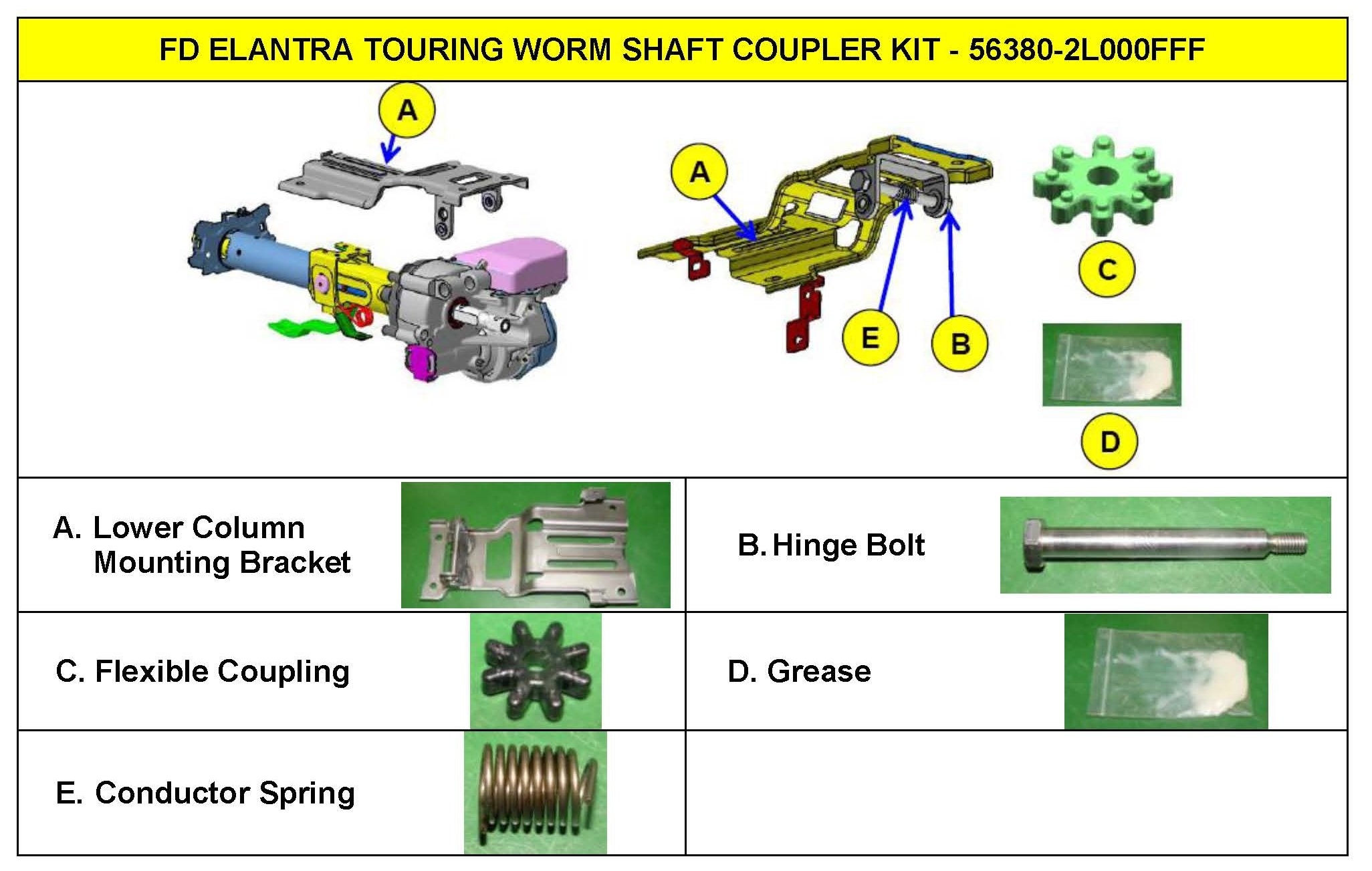

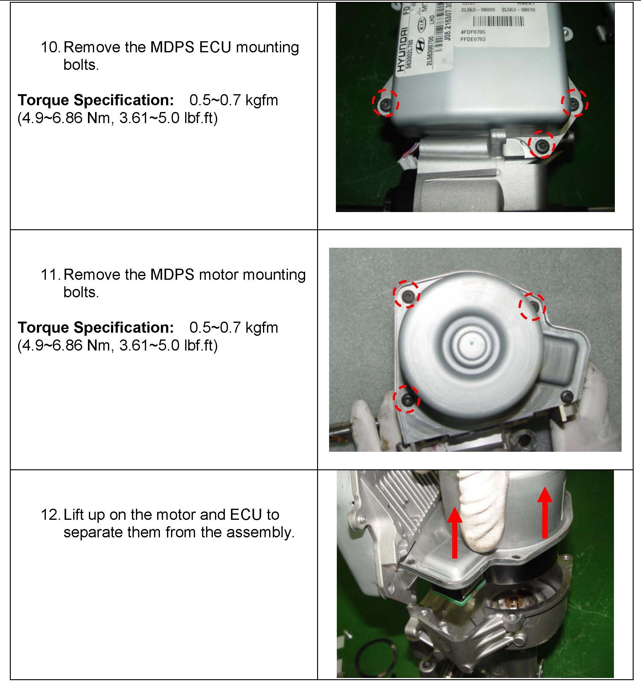

While turning I feel a "bump" in the rotation of the steering.
Oct 31, 2020 at 12:50 AM
  • 110,241 POSTS

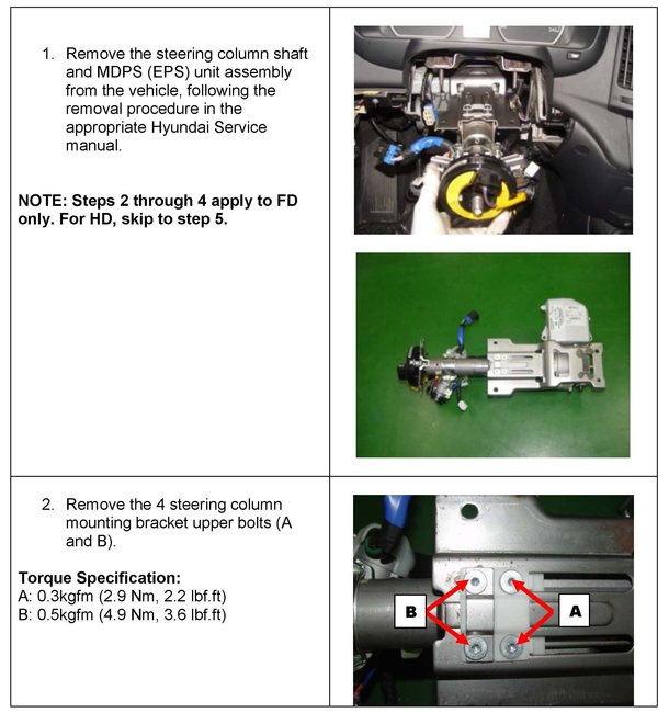

When this happens, does it make any noise? I came across a technical service bulletin (TSB) related to a rattle when hitting bumps or turning the wheel.

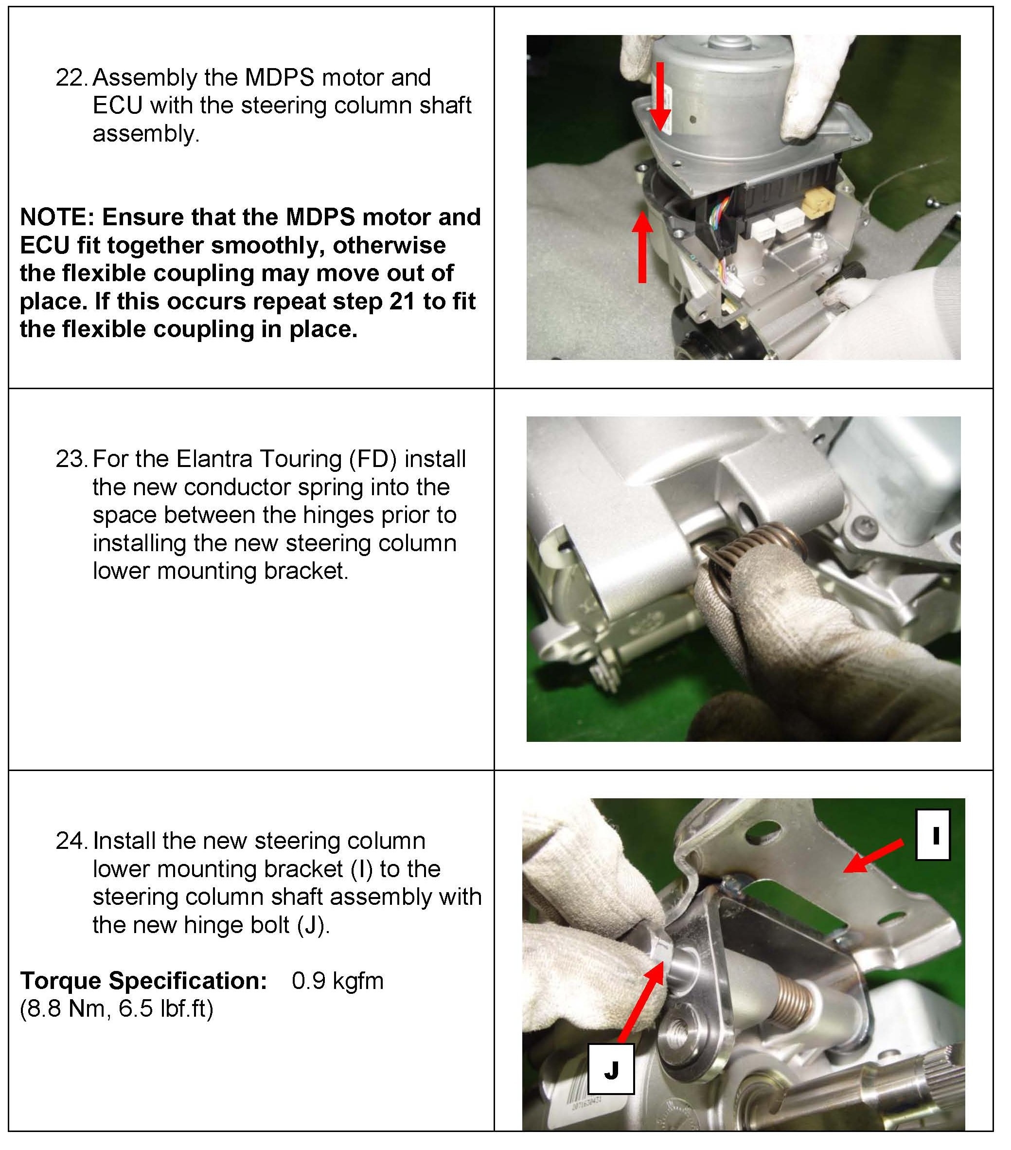

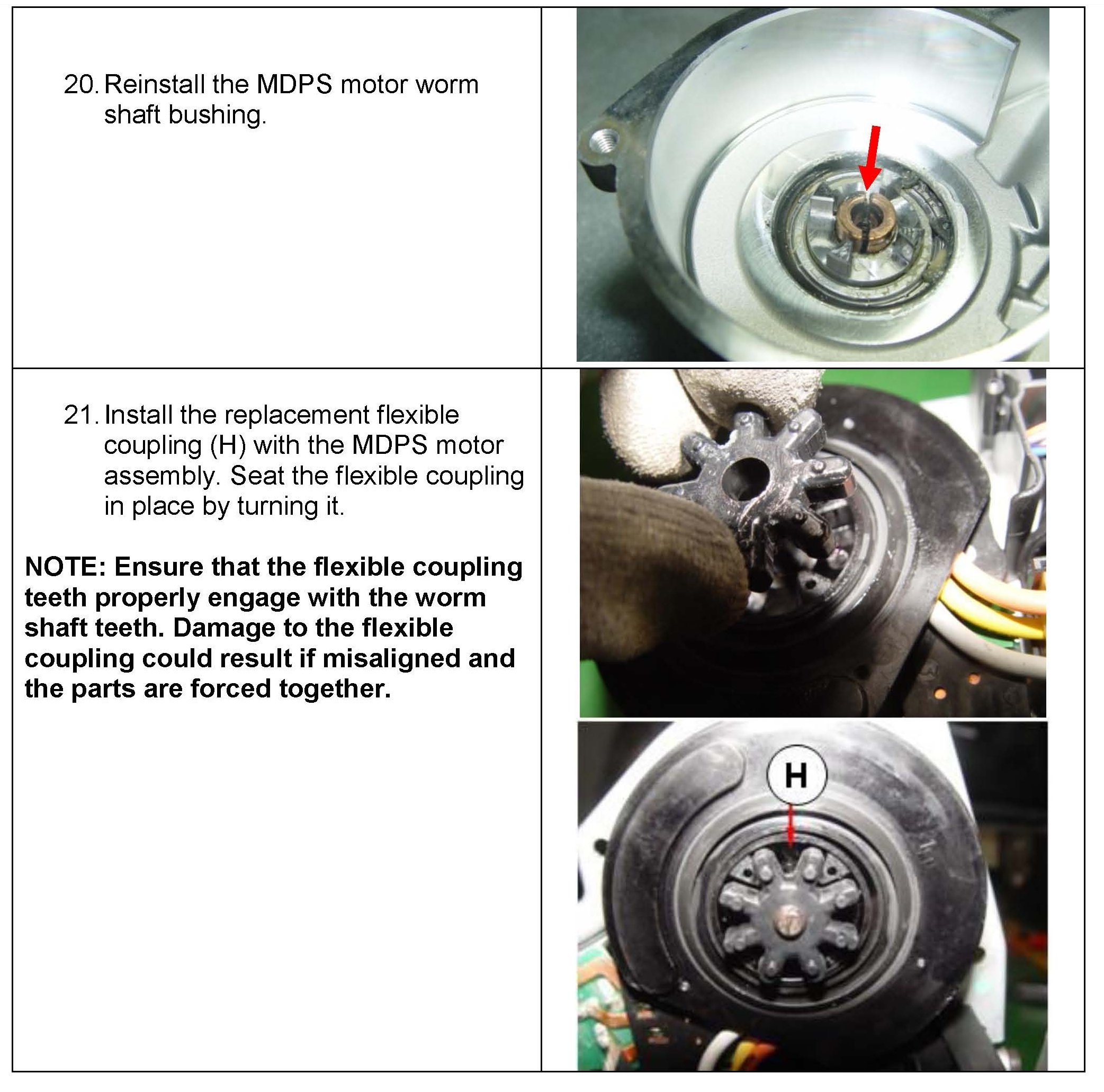

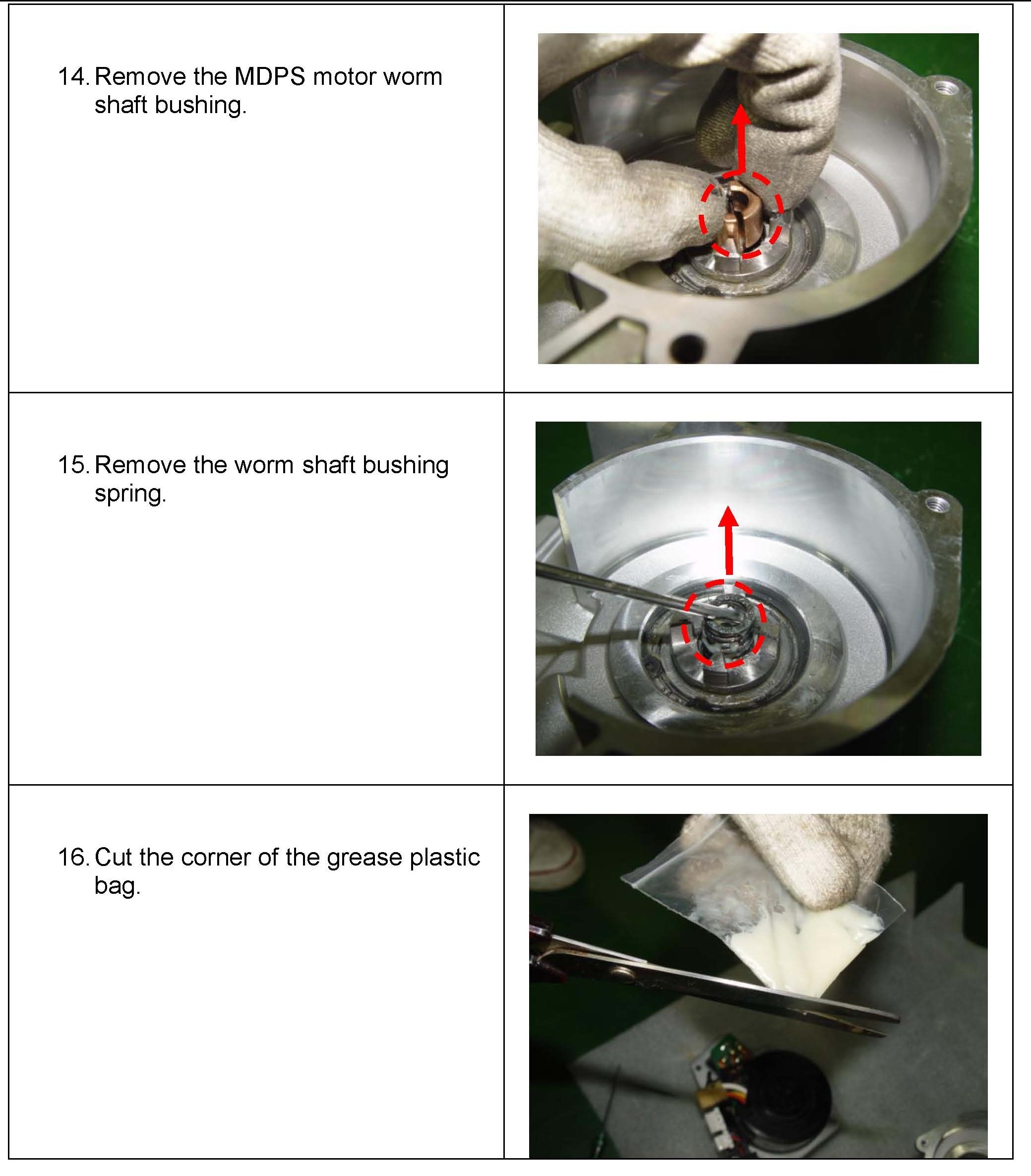

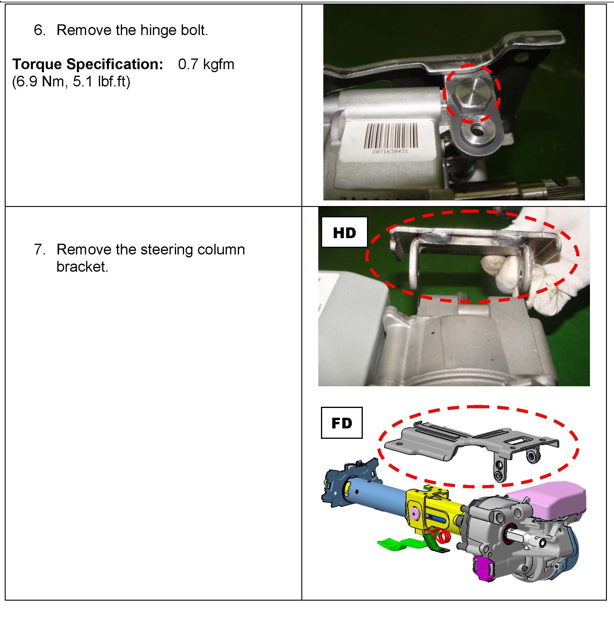

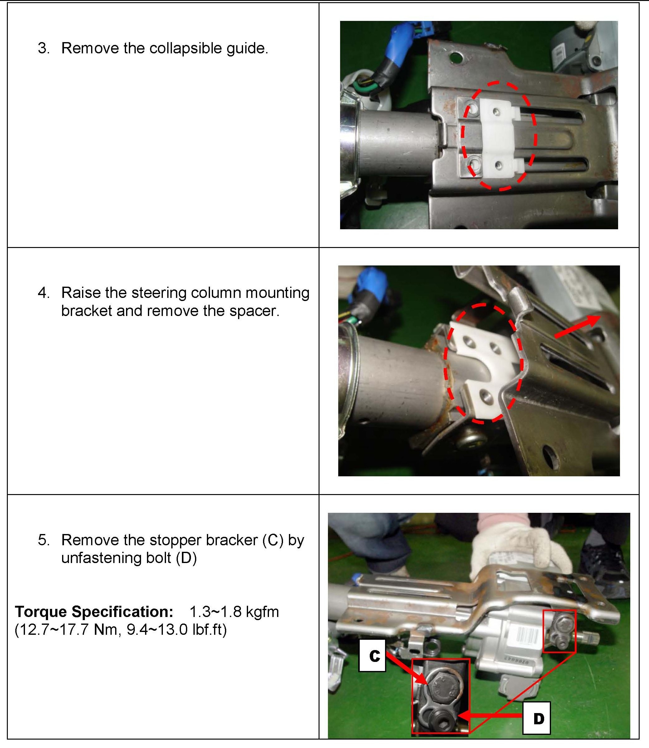

Take a look through this. This describes the issue and how it's repaired. The attached pics correlate with the TSB.

2010 Hyundai Elantra L4-2.0L
Steering - Steering Column Rattle
Vehicle Steering and Suspension Steering Canada - Steering - Steering Column Rattle
NO. 11-50-004
DATE DECEMBER 5, 2011
MODEL ELANTRA (HD), ELANTRA TOURING (FD)
SUBJECT
ELANTRA STEERING COLUMN RATTLE
Some 2007-2010MY Elantra and 2009-2010MY Elantra Touring vehicles may exhibit a slight rattle noise from the steering column while driving on rough roads at low speeds or while turning the steering wheel.This condition is cause by the worm shaft flexible coupling in the motor driven power steering (MDPS) column. This bulletin provides the procedure to repair this condition.

pic 1

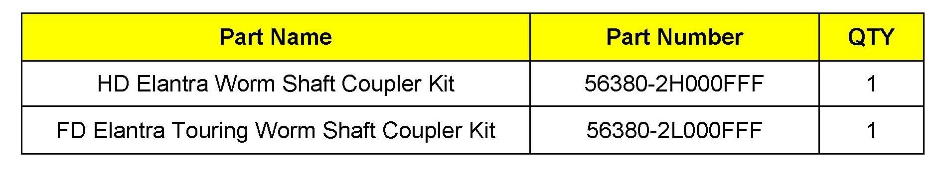

PARTS INFORMATION
pic 2
pic 3

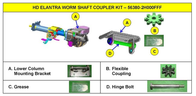

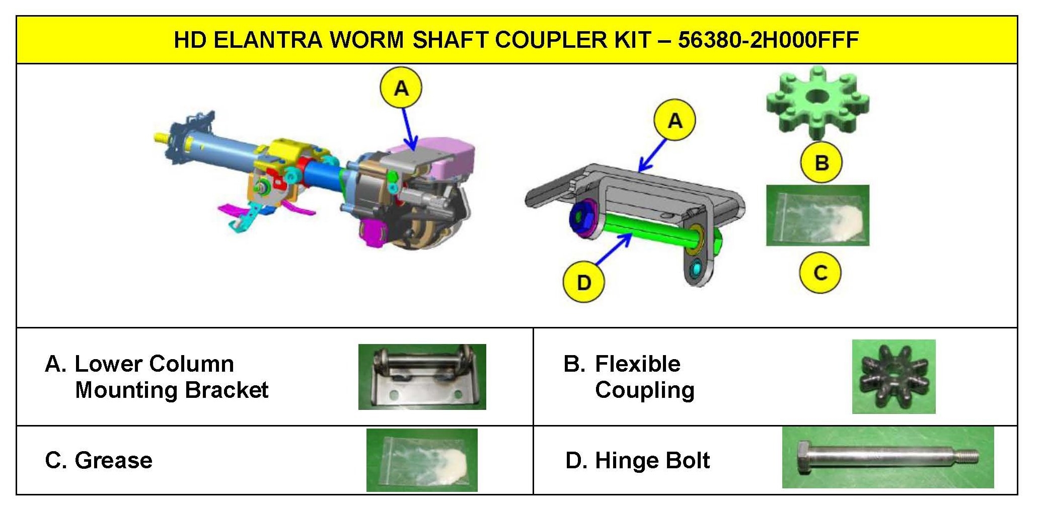

KIT COMPONENTS
Pics 4 to 11

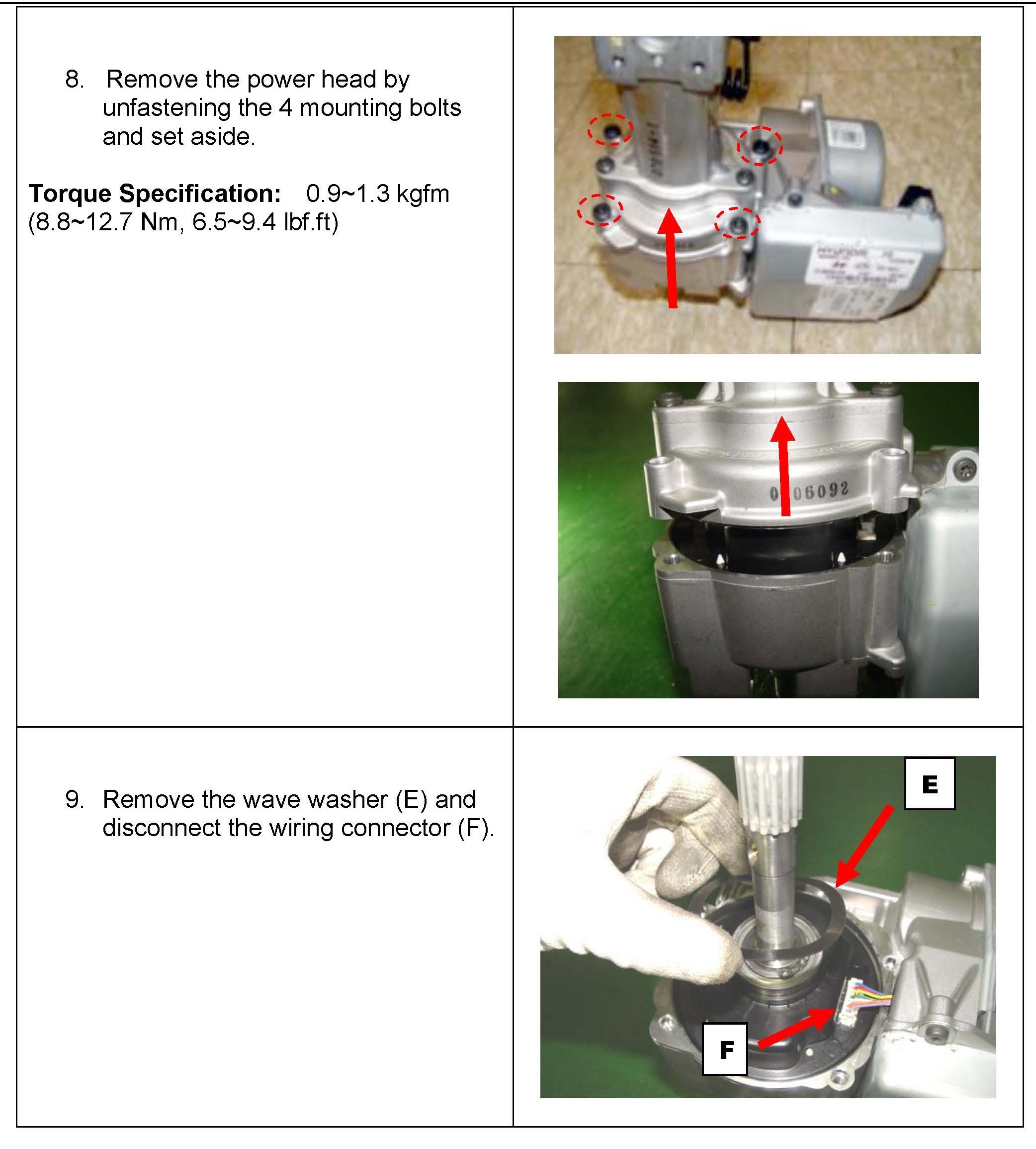

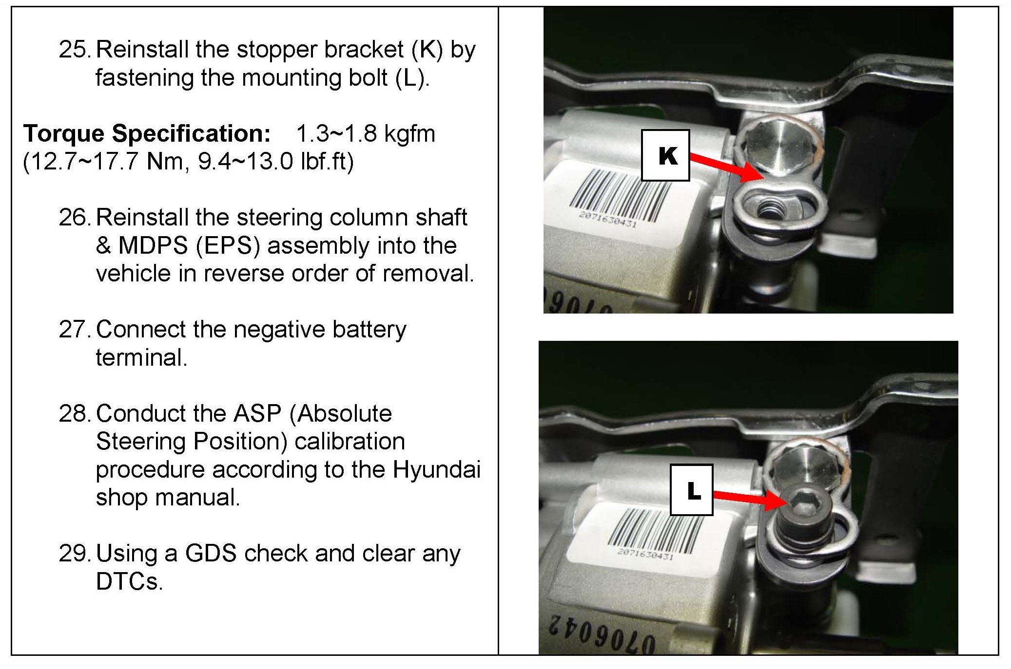

SERVICE PROCEDURE:
WARRANTY INFORMATION
OFP: 56310-2H301 (Qty. 0) Description:Elantra Steering Flexible Coupling Replacement Consequential:56380-2H000FFF (Qty. 1) OP Code: 56380F00 T1: N29 (Abnormal Noise) T2: C24 (Improper Clearance) LTS: 1.3 M/H
OFP: 56310-2L300 Qty. 0) Description:Elantra Touring Steering Flexible Coupling Replacement Consequential:56380-2L000FFF (Qty. 1) OP Code: 56380F00 T1: N29 (Abnormal Noise) T2: C24 (Improper Clearance) LTS: 1.3 M/H

Let me know if this helps. Also, if you have other questions let me know.
