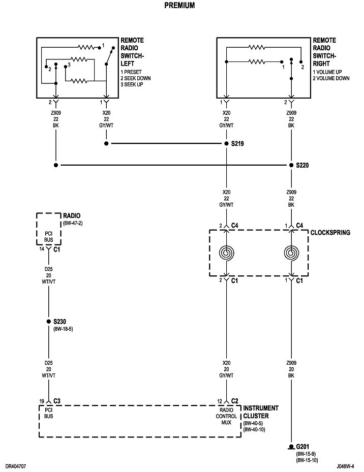

I need to know the steering wheel. Audio control wire colors.

Black is ground. Gray / white is the multiplexed signal wire.
Image (Click to enlarge)
