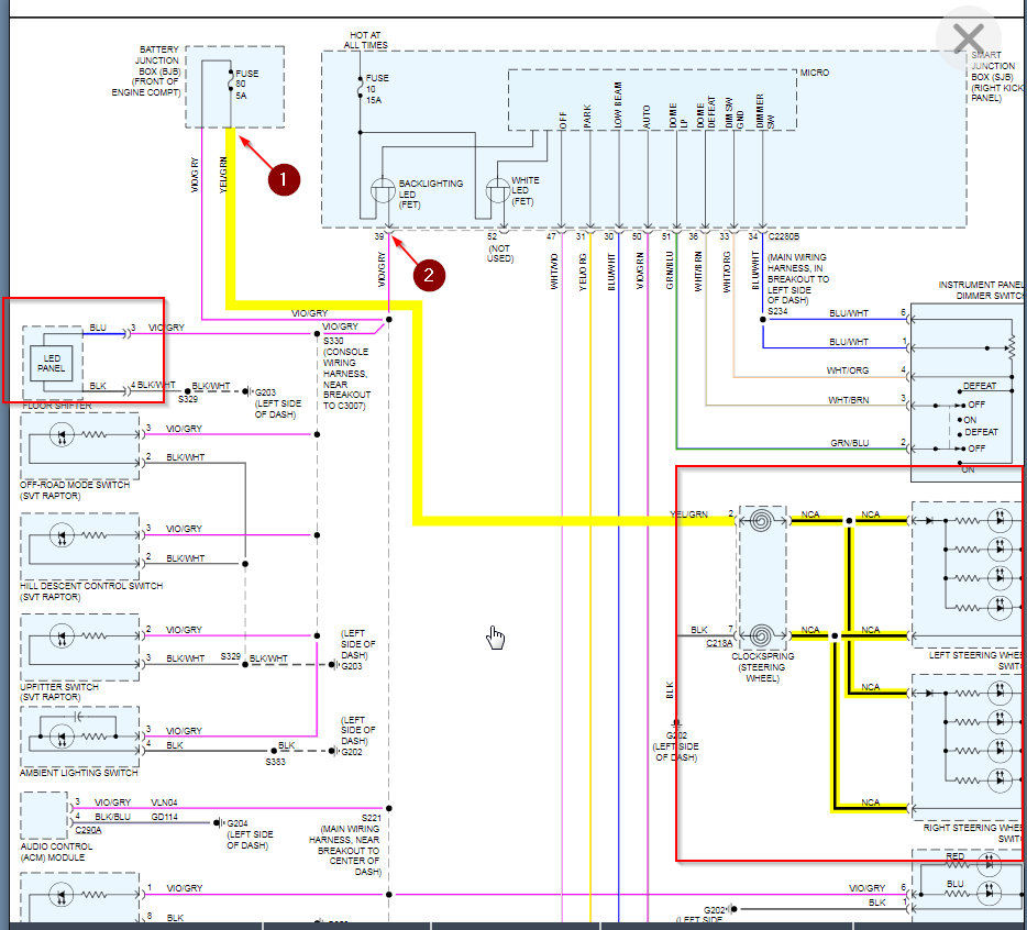

I have the same issue with my truck listed above Lariat. Can you help?
Fuse 80 under the hood is a 5 amp fuse and is good. The #10 fuse (15 amp) near the passenger side kick panel is good. Also, I disconnected the battery for 20 minutes to try to reset everything, but the steering wheel and shifter lights are still out.
Oct 1, 2020 at 10:36 AM

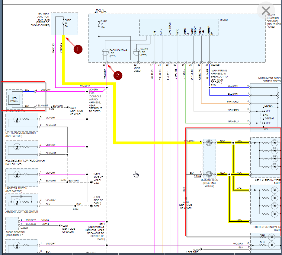

I am attaching the wiring diagram for the interior lights. We need to check voltage at the number 1 and 2 with the lights on. If you have voltage there, we need to go to each component and check for voltage.
It is possible that you have two separate issues so we need to treat them separate and check voltage at each spot. Then we can go from there. Worst case, we will fix one and see if it fixes the other. If not, we can then tackle that one separate.
