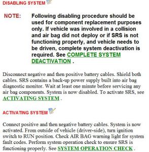

HOW DO I DISARM THE AIR BAG; WHAT SUGGESTIONS OR CAUTIONS DO YOU HAVE WHILE REMOVING THE DASH BOARD.

https://images.2carpros.com/forum/automotive_pictures/55316_96f150airbag_1.jpg
There are quite a few screws and plastic tabs holding the dash panels. If the feels tight to pull out, then you have a screw or tab that needs to pull out.
