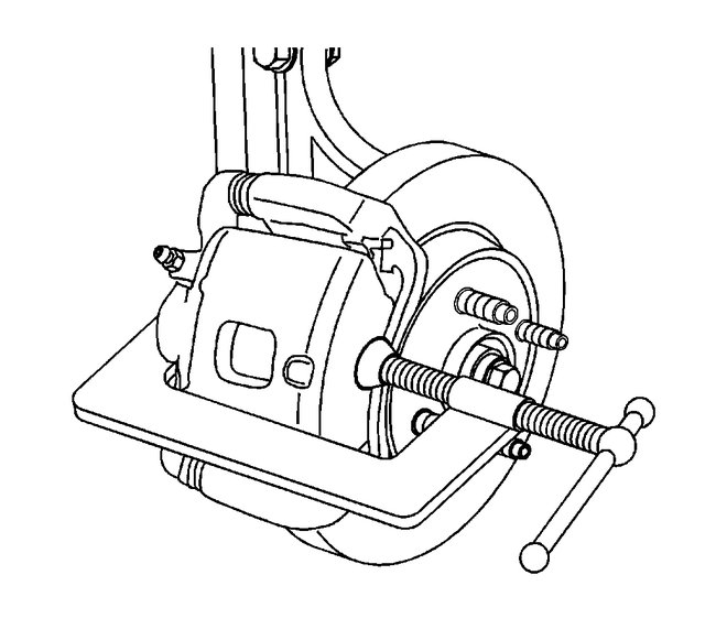

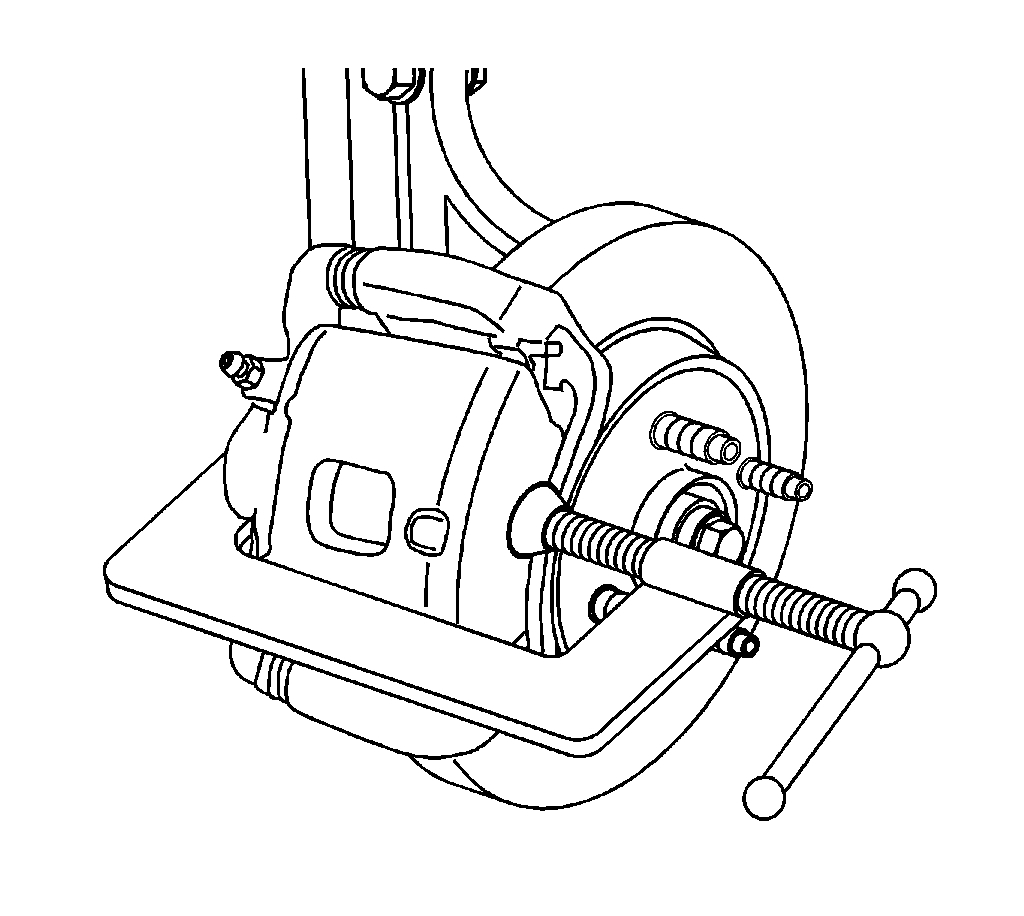

3. Install a C-clamp over the body of the brake caliper, with the C-clamp ends against the rear of the caliper body and the outboard disc brake pad.
4. Tighten the C-clamp until the caliper piston is compressed into the caliper bore enough to allow the caliper to slide past the brake rotor.
5. Remove the C-clamp.

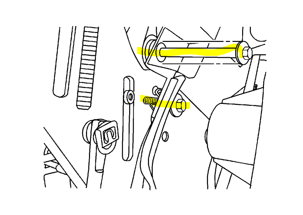

6. Notice: Support the brake caliper with heavy mechanic's wire, or equivalent, whenever it is separated from its mount and the hydraulic flexible brake hose is still connected. Failure to support the caliper in this manner will cause the flexible brake hose to bear the weight of the caliper, which may cause damage to the brake hose and in turn may cause a brake fluid leak.
Important: Do NOT disconnect the hydraulic brake flexible hose from the caliper.
Remove the brake caliper and the caliper mounting bracket as an assembly from the steering knuckle and support the assembly with heavy mechanic's wire (2), or equivalent. Ensure that there is no tension on the hydraulic brake flexible hose.
7. Matchmark the position of the brake rotor to the wheel studs.
8. Remove the brake rotor.

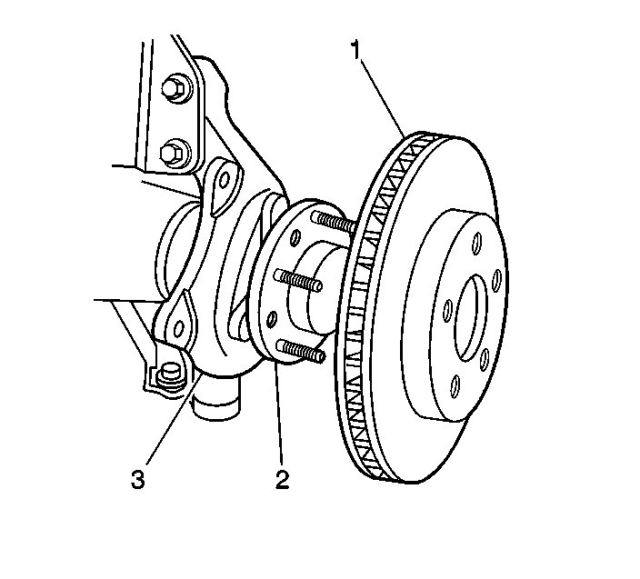

1. Important: Whenever the brake rotor has been separated from the hub/axle flange, any rust or contaminants should be cleaned from the hub/axle flange and the brake rotor mating surfaces. Failure to do this may result in excessive assembled lateral runout (LRO) of the brake rotor, which could lead to brake pulsation.
Using the J42450-A, thoroughly clean any rust or corrosion from the mating surface of the hub/axle flange.
2. Using the J41013, thoroughly clean any rust or corrosion from the mating surface and mounting surface of the brake rotor.
3. Inspect the mating surfaces of the hub/axle flange and the rotor to ensure that there are no foreign particles or debris remaining.
4. Install the brake rotor to the hub/axle flange. Use the matchmark made prior to removal for proper orientation to the flange.

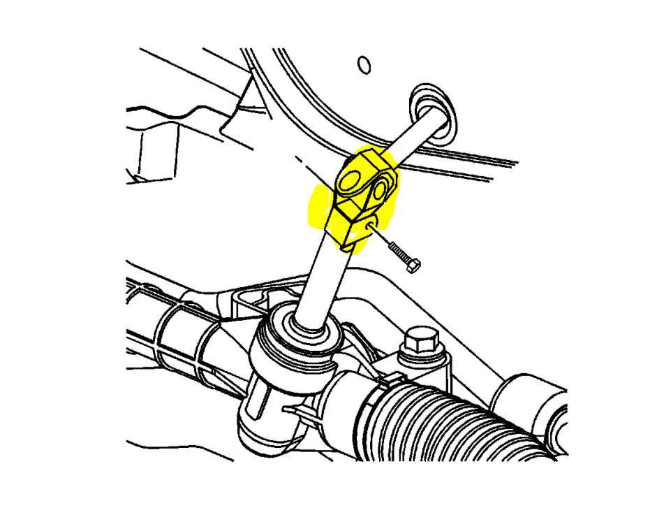

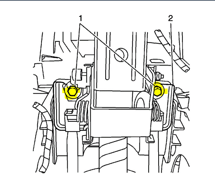

I did hear it. It does sound like something in the column or the column itself. I attached some pics below. The first two show the column mounting bolts. First, check to make sure they are tight.
Next, pic 3 shows the intermediate shaft. Note there is a universal (highlighted). Make sure there is no excessive play in it and make sure the shaft is tight at both ends. Note: The shaft comes through the firewall and attached to the rack and pinion. You will need to look low on the firewall to locate it. It will be on the driver's side.

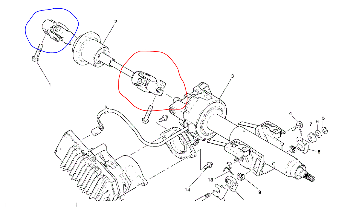

If you look at pic 4, it is the intermediate shaft as well. In blue, I circled the end that attaches to the rack and pinion, and in red is the end which is in the vehicle and attaches to the column. Grab that and see if there is back and forth play. Note: Make sure there isn't tension on the steering wheel in the lock position. We need it to be unlocked. Don't take it out of park and make sure the parking brake is applied.
Let me know what you find. I have a feeling it has to do with the intermediate shaft, but can't be 100% sure without being there to check it.
