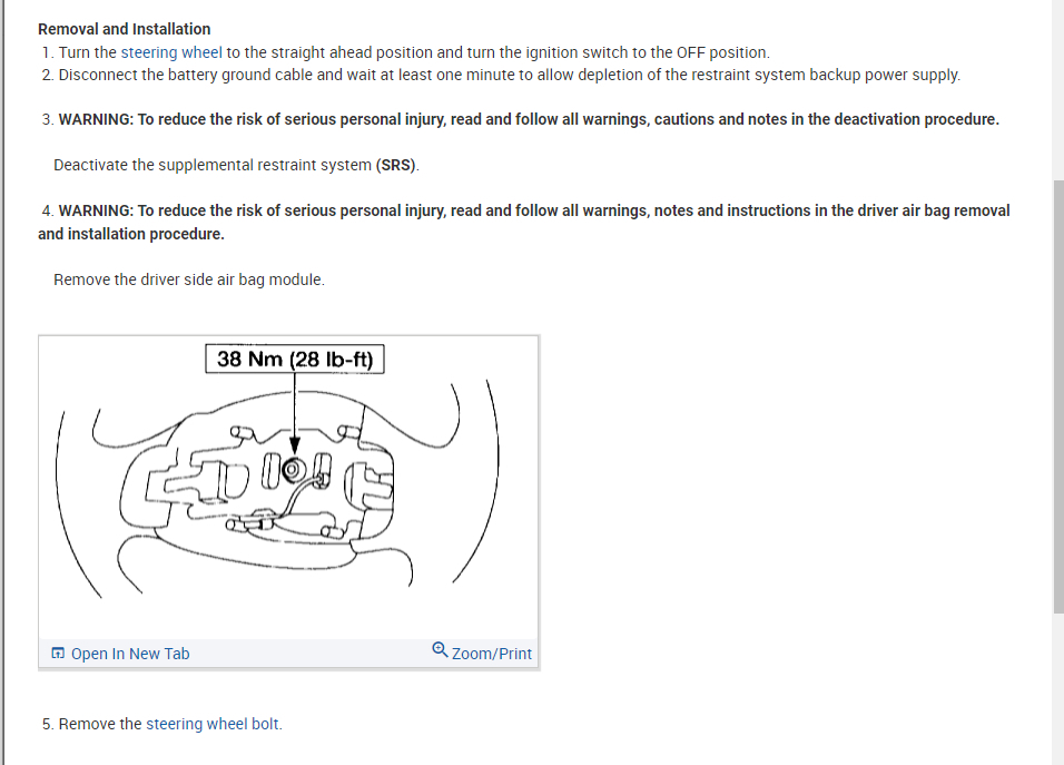

The original steering wheel that came with the truck has signed buttons on the stereo wheel. I would like to know if it's possible to switch to stereo will with one that does not have buttons on the wheel.

I assume that the steering wheel you have for the replacement does not have the buttons for radio, cruise, or other functions? If this is the case then unfortunately you will not be able to control these functions without the buttons and there is no way to add them.
If you found a wheel from a salvage yard then I would suggest returning it and attempting to find one off a vehicle that is similarly equipped with yours.

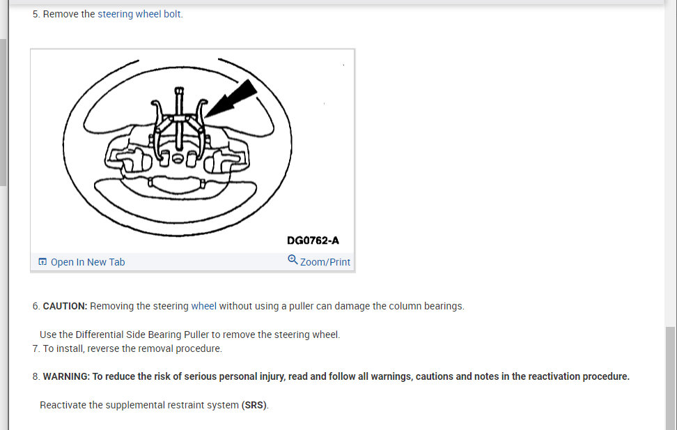

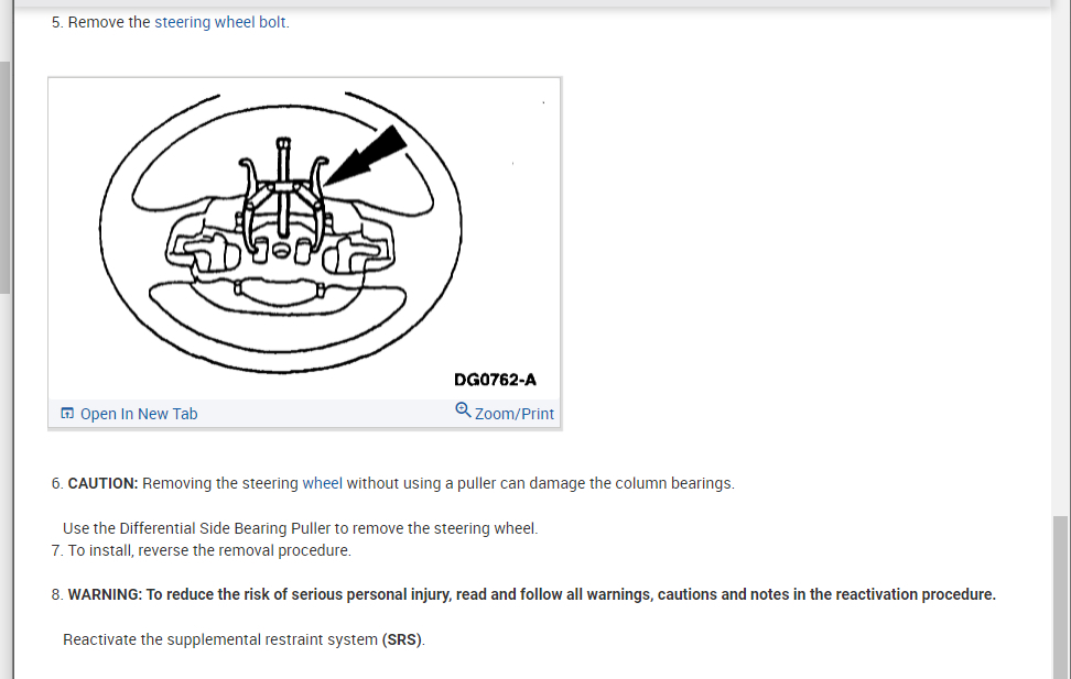

Here is a guide that well help with step by step instructions on how to remove the steering wheel:
https://www.2carpros.com/articles/steering-wheel-removal
You may not need these but the instructions from the manual are below as well.
