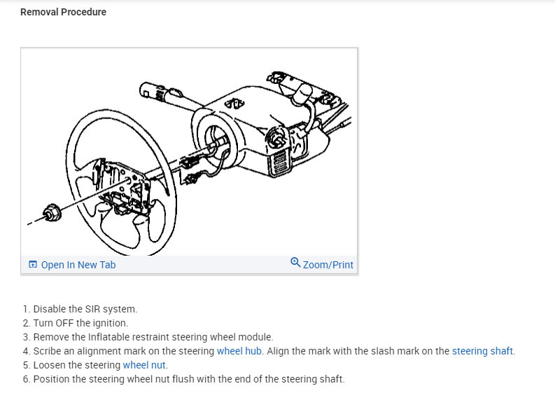

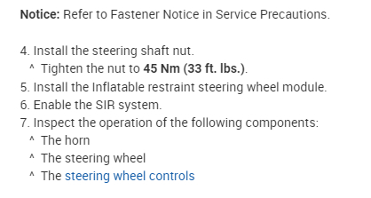

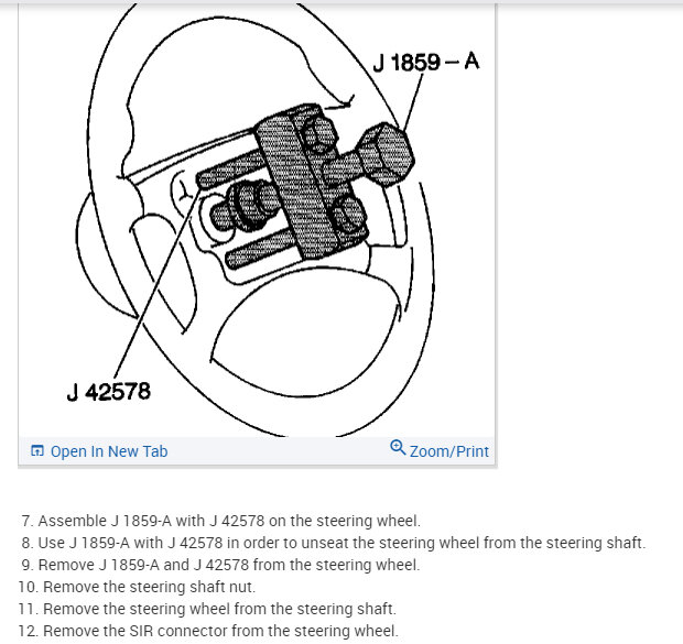

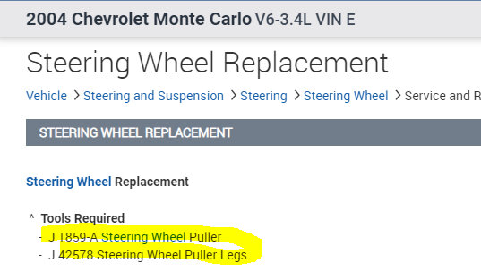

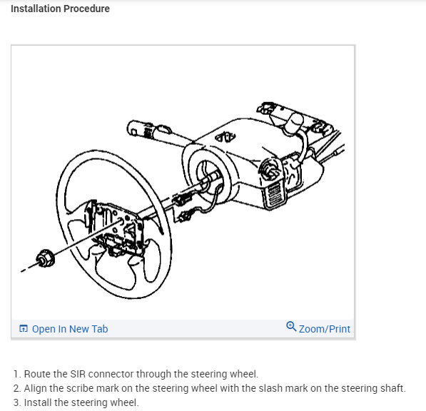

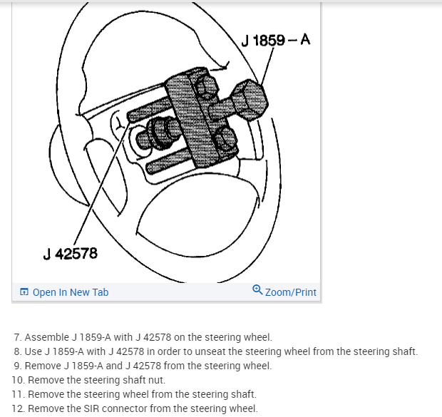

To remove the steering wheel, you will need a steering wheel puller. Also, you must disable the airbag prior to beginning the procedure.
Make sure the battery is disconnected at least 30 minutes before you begin. What I like to do is disconnect both battery terminals and zip tie them together. This helps drain power from capacitors. Also, remove the air bag fuses and make sure the key is off.
If you look below, I attached the directions. Take a look through them and let me know if you have questions.
Let me know if this helps.

Thanks, helped a lot.
