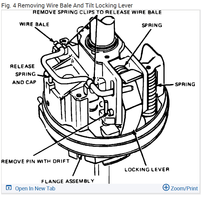

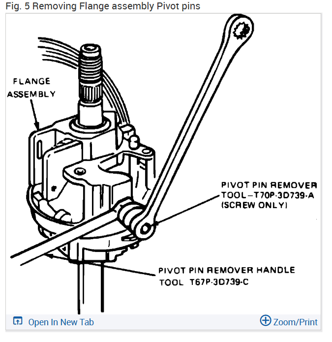

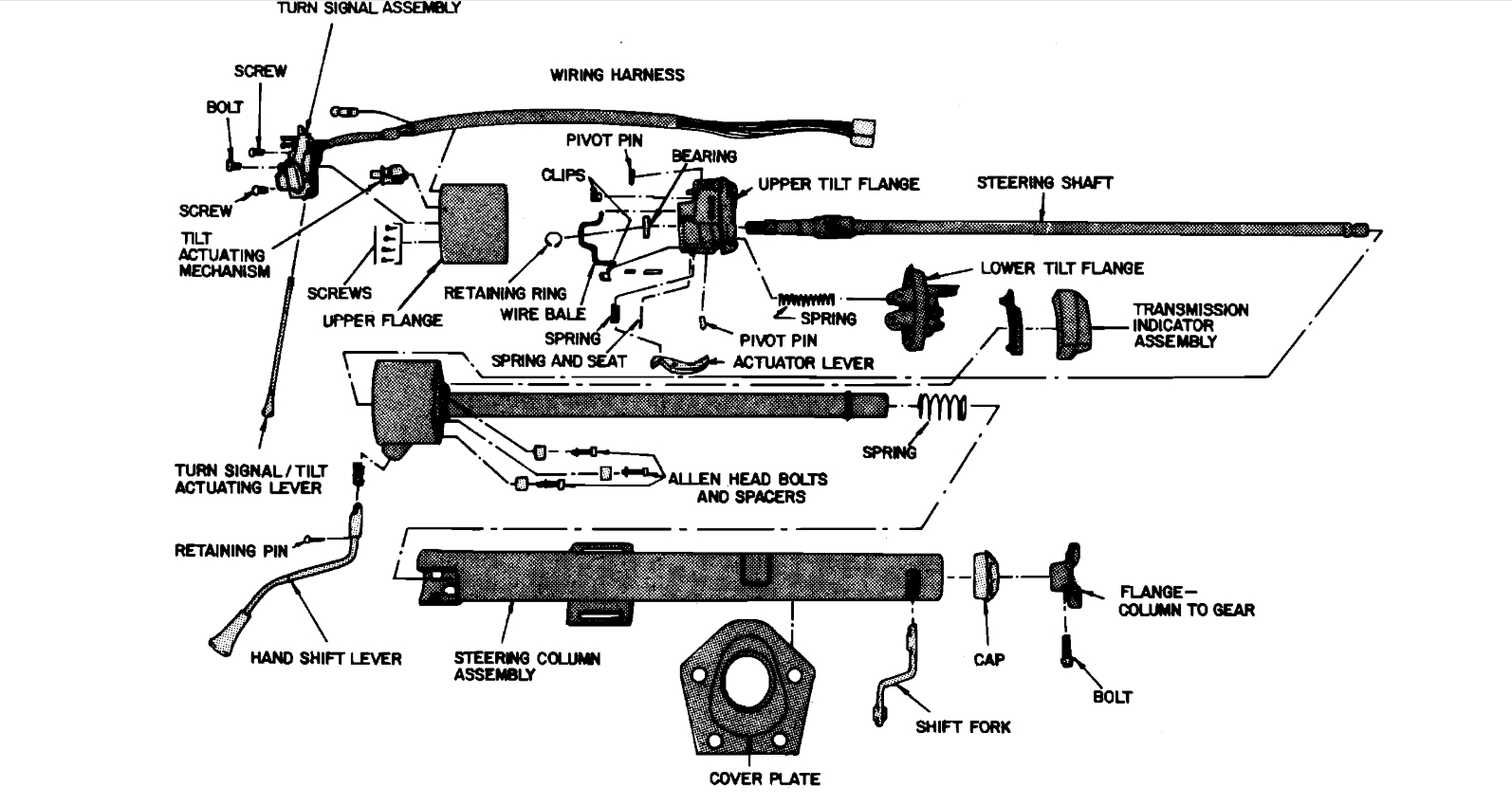

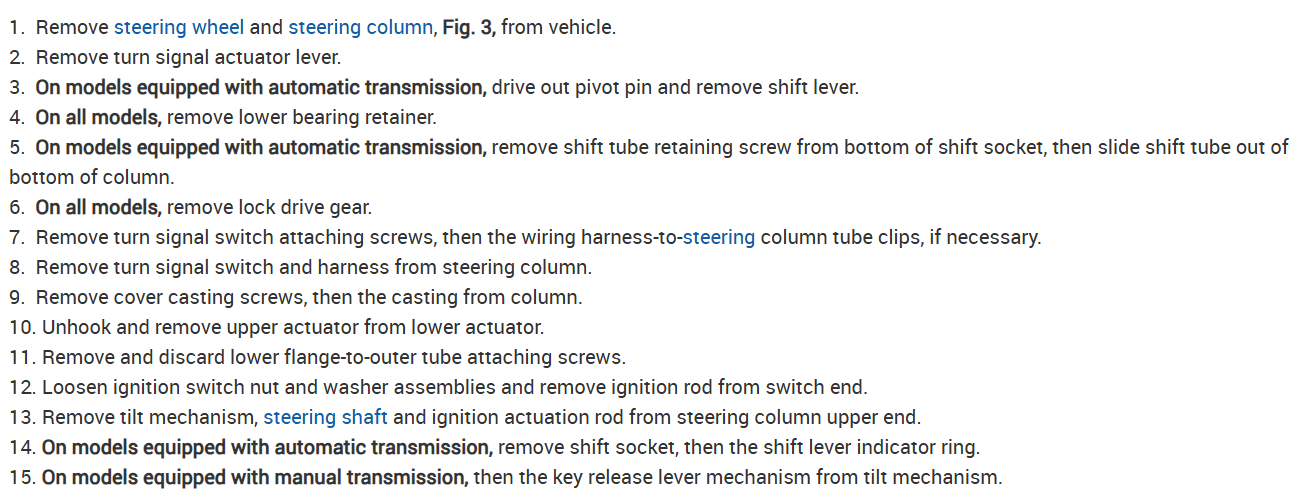

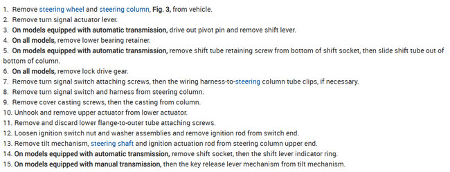

Need steps on taking apart the steering column. I can see small bolts holding some of the electrical boards pieces around the neck of and below the steering wheel.
Sep 21, 2026 at 4:49 PM
AZDANNO04
  • 378 POSTS
Just wanted to make sure especially putting it back together.
Sep 21, 2026 at 8:45 PM
  • 55,746 POSTS
Sure, here is the info to disassemble the steering column. Let me know what you find please.
