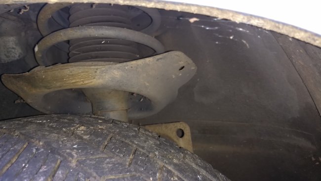

When turning left with the wheels at full lock the right front thumps exceptionally loud. I noticed something out of place (see picture below) when doing a minor inspection of the vehicle. The rear wheels also feel off balance, as the entire rear end hops at speeds of twenty five to forty mph while coasting.

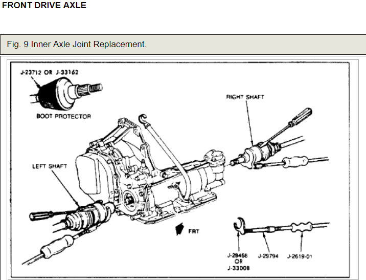

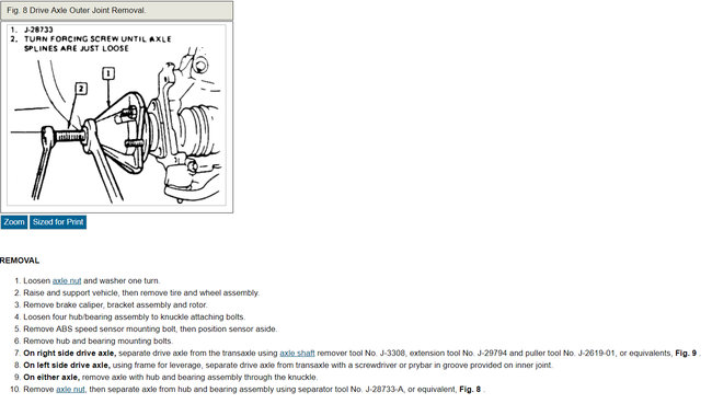

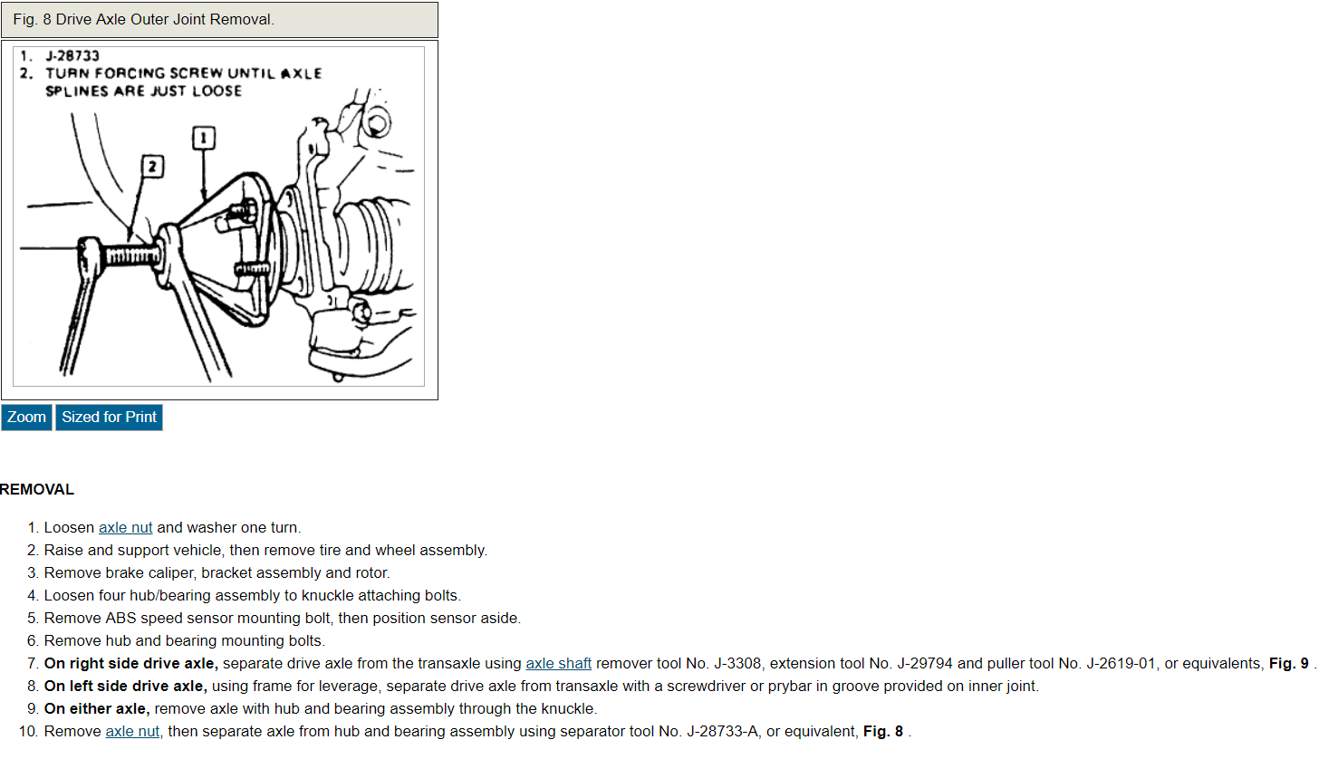

This sounds like a classic CV axle that needs to be replaced. Here is a guide to help you see what you are in for when doing the job and diagrams below on how it will be on your car:
https://www.2carpros.com/articles/replace-cv-axle
