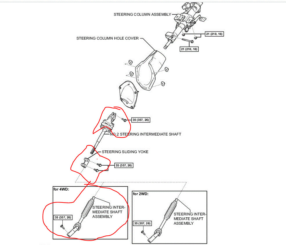

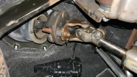

That's odd. Tell me, is there any play in the steering wheel itself? I'm asking because there are two joints that can wear and become loose in the steering column. The intermediate steering shaft which connects the steering wheel to the rack is what I'm referring to. I attached a pic below for you to get a better idea. Check to see if there is excessive play in either of the joints.
Let me know what you find.

It seems like there is a little play, but I think the play has always been there. I will look at the steering column and see. I was also told I have an inner tie rod with some play in it. Would that cause the problems I described though?

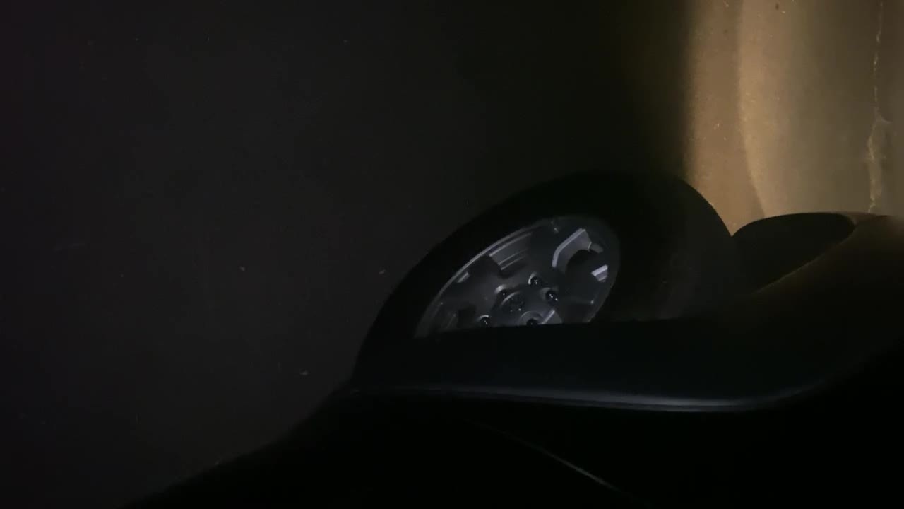

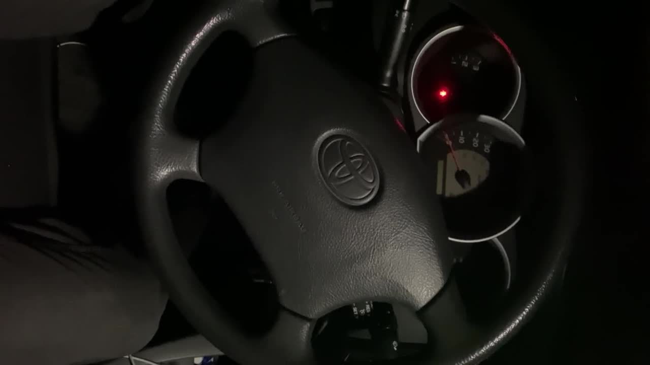

Here is the steering play:
Nov 12, 2020 at 8:00 PM

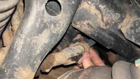

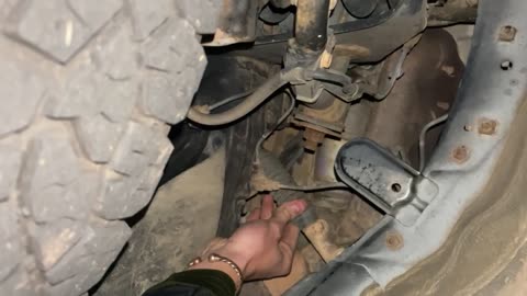

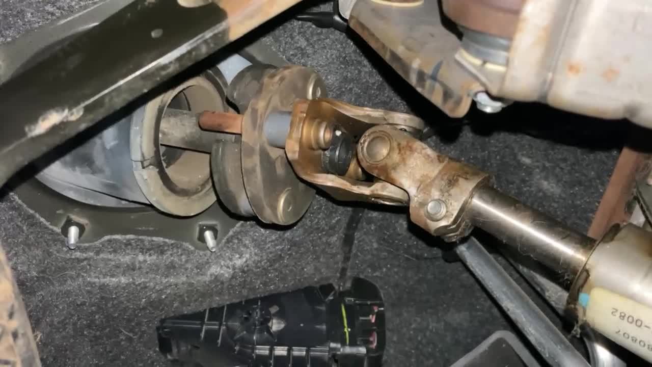

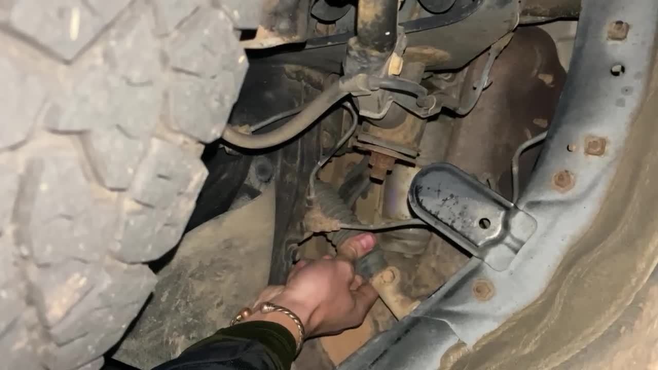

Here is some of the steering shaft. I will take one more video.
Nov 12, 2020 at 8:01 PM
  • 110,194 POSTS
I can't see the steering shaft in the second video. In the first, you indicated a dead spot. What do you mean by that? Also, with the engine off, does the steering wheel have play back and forth?
Nov 12, 2020 at 8:09 PM
JDGSHRED
  • 10 POSTS
What I mean by a dead spot is, I am moving the steering wheel but in a certain spot when the steering wheel is being turned the wheel does not move.
Nov 12, 2020 at 8:35 PM

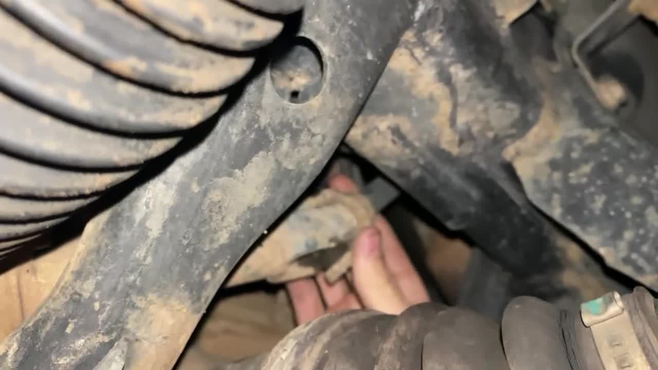

Got three for you.
Nov 12, 2020 at 9:08 PM
JDGSHRED
  • 10 POSTS
2
Nov 12, 2020 at 9:09 PM
JDGSHRED
  • 10 POSTS
In this video I was explaining that the previous owner had put that zip tie there in attempt to remove the Tacoma “drop” sensation when you’re going off road.
Nov 12, 2020 at 9:12 PM

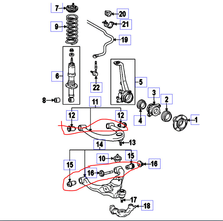

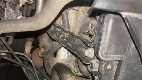

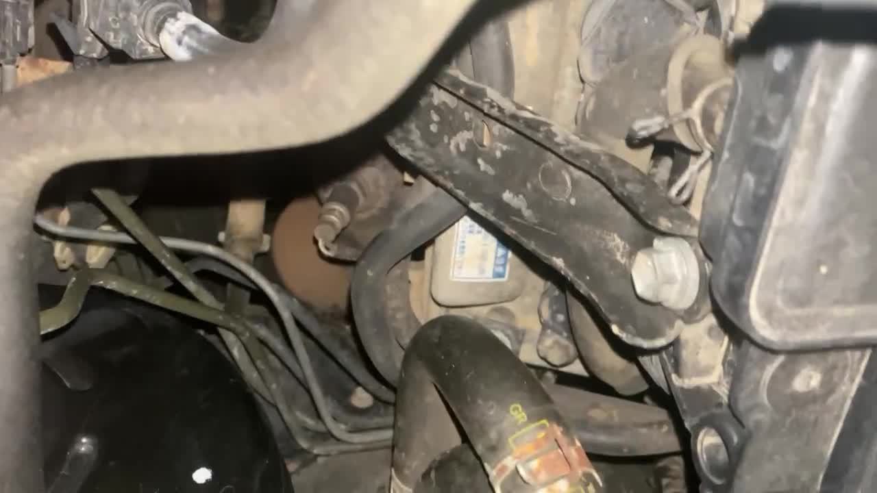

Thanks for the videos. However, everything appears to be tight and not something that would cause the issues you experience. The only other thing I can think of is if there are control arm bushing worn. Have you checked them? See pic 1
Also, on some of these trucks, there are actually steering stops that are adjustable. If they are over extended, that could be causing the steering radius issue. If it has them, you should see them above the lower ball joints. The steering knuckle will actually touch them when fully turned.
I just had an after thought. What kind of tires are on the truck? Do they have the correct air pressure, are they the same size, is the tread good?
