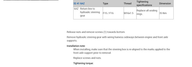

I am experiencing a knocking/rattle at Low speed on uneven Road surfaces. I have looked for a rack repair kit but cannot find one for an f15 x5.
Sep 5, 2022 at 6:13 AM
  • 55,710 POSTS

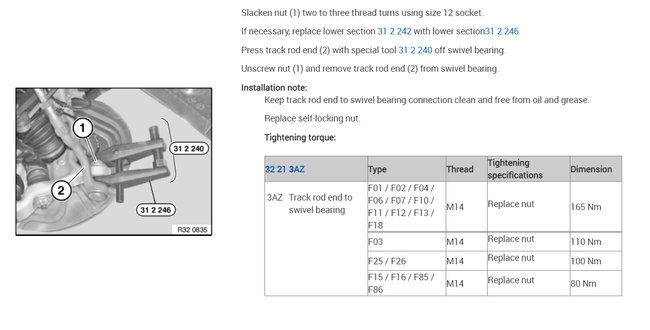

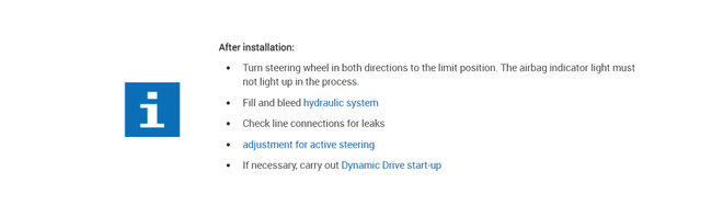

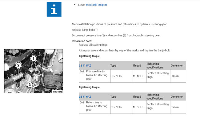

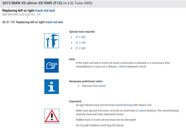

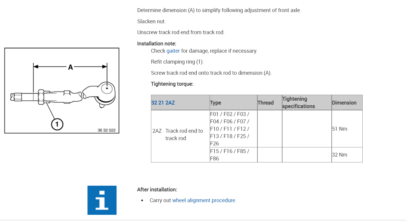

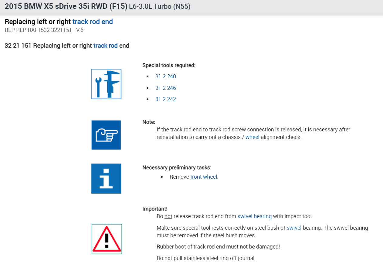

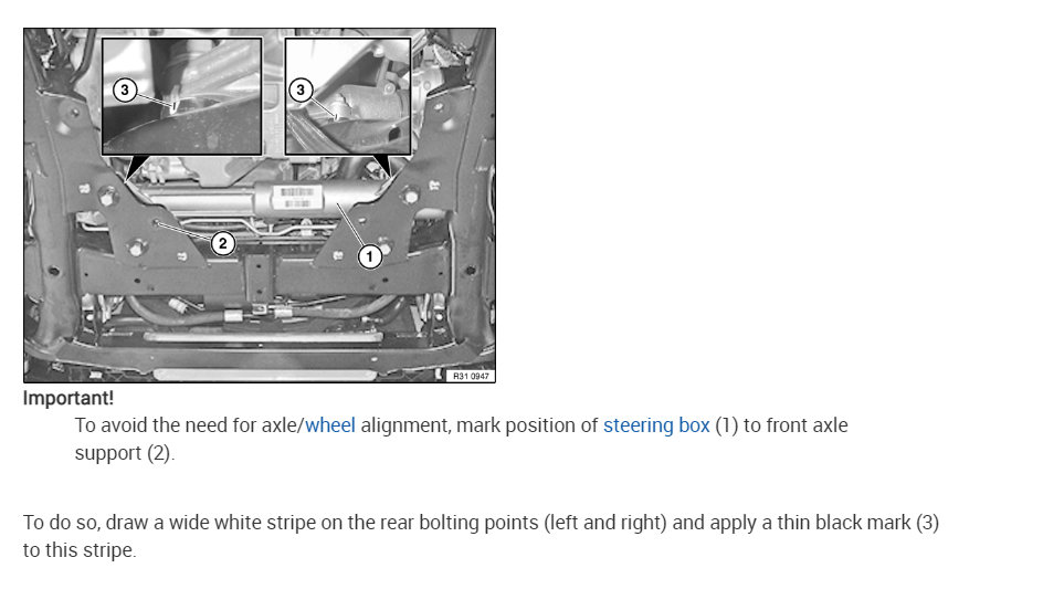

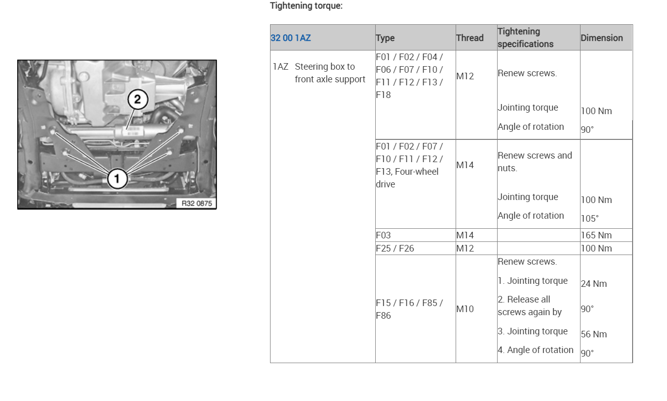

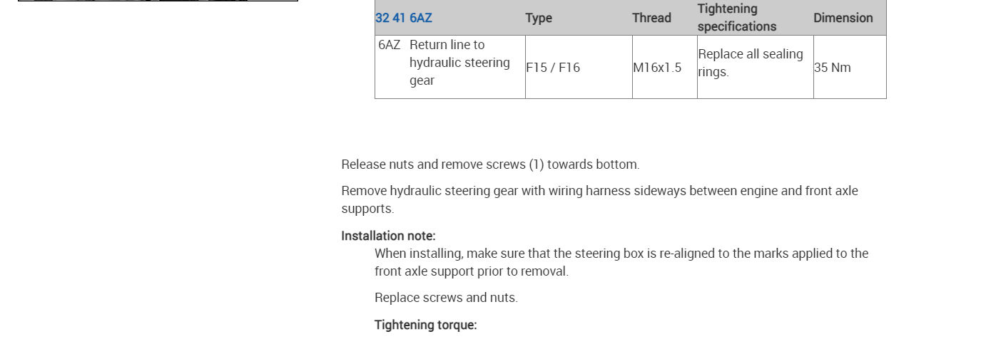

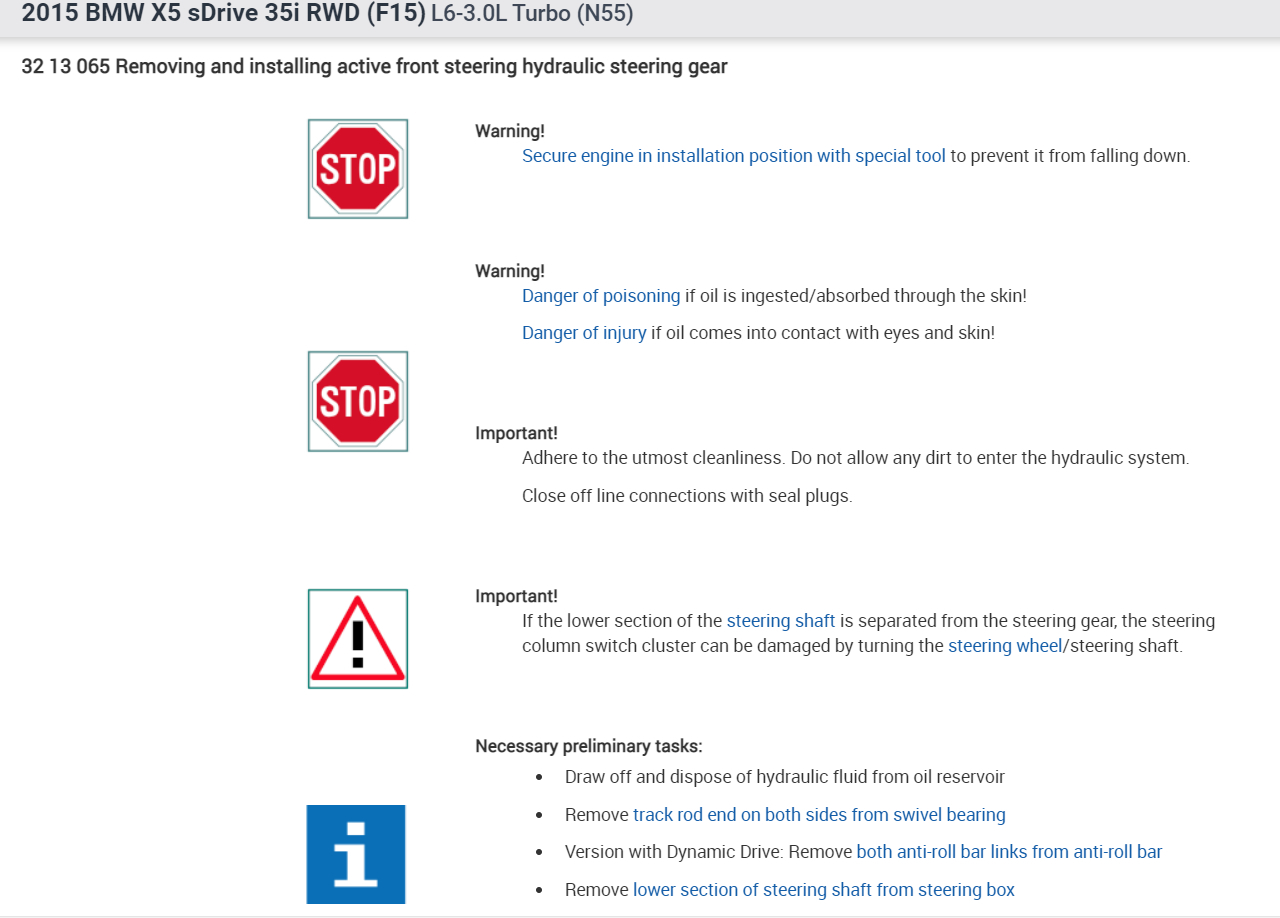

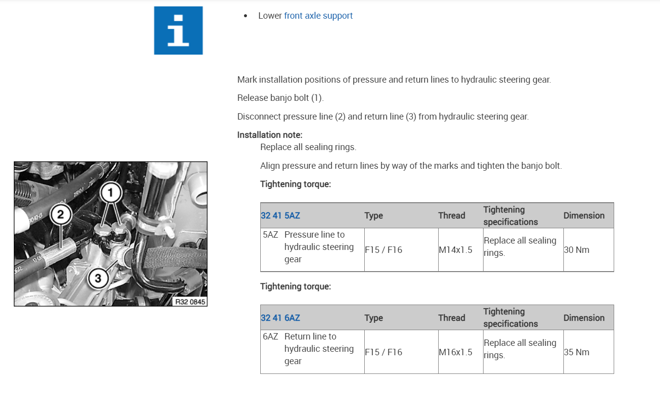

This is kind of low miles for a steering rack but how do you know it's the rack? Could it be the tie rod ends? Here are the instructions for removing the steering rack and how to replace the outer tie rod ends just in case.
4 - Steering Rack - 32106889094 $3548.30
1 - Left tie rod end - 32106863858 $169.67
