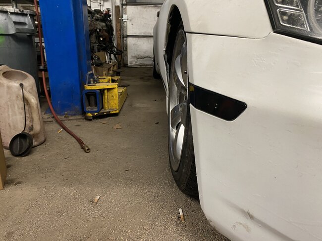

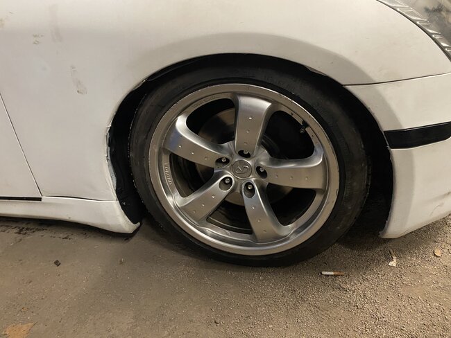

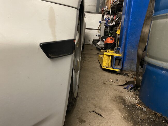

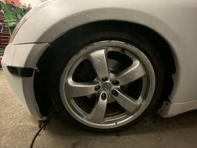

Do the front wheels have an excessive amount of camber? Positive caster is the main cause for this kind of problem. Can you please shoot a quick video with your phone so I can tell you what's going on? You can upload it here with your response.

Here’s one wheel passenger.

Passenger camber.

Driver.

Driver camber.

Thank you for the video and images. if you disconnect the steering rack from the steering wheel, does it turn easily? Also, do not spin the wheel once it is disconnected because it will ruin the clock spring spiral wire. When the car is on the rack can you move the steering by the tire manually?

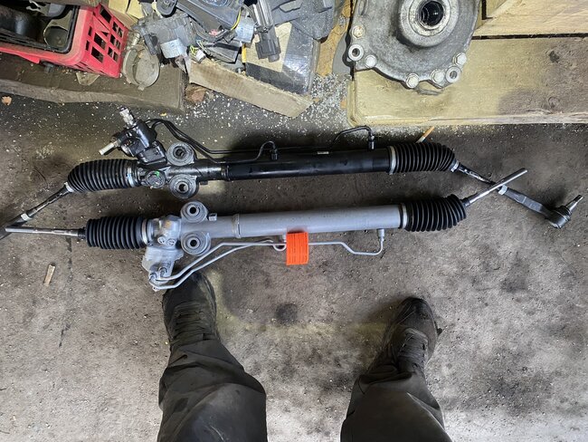

Advance Auto only sells one rack for g35 in general AutoZone has a specific one for coupe. The coupe one I purchased is a little bit longer. Installed it and realigned the wheels and it is working, had to adjust the preload on the rack for some reason but I’m going to assume it’s because he’s lowered with different size wheels/tires.

Thanks for the image, thanks for letting us know, we are here to help, please use 2CarPros anytime.
