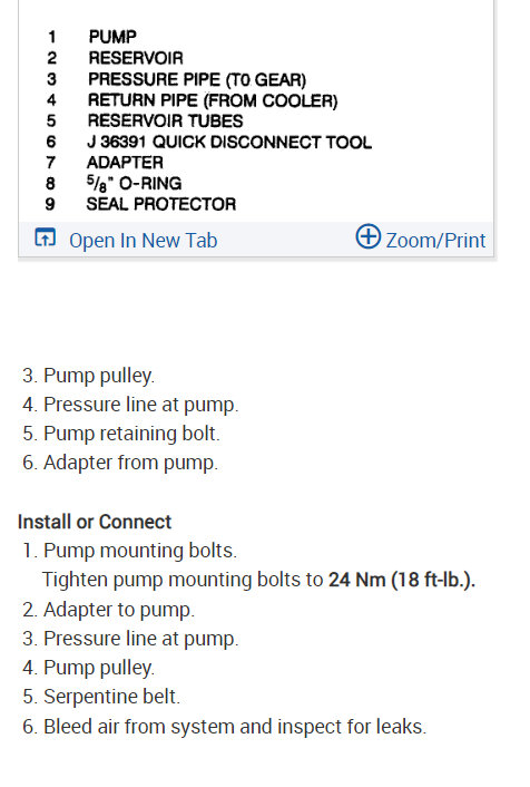

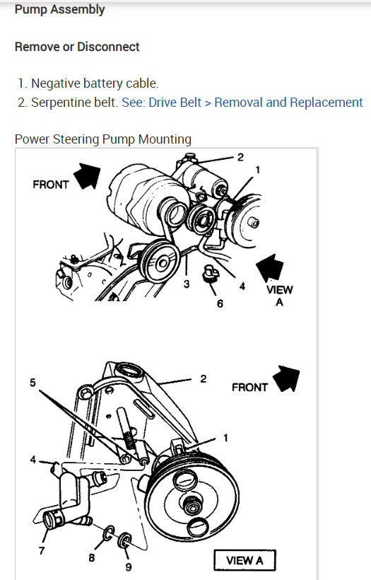

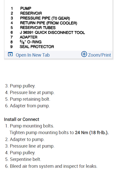

How to change out the power steering pump on the car listed above Sedan model?
Apr 8, 2024 at 10:15 PM
  • 55,447 POSTS
Sure, here is a guide to help walk you through the repair including how to remove the power steering pulley which you will need a puller for to remove the pump pulley which you can rent from the auto parts store. This guide is generic, but I have included the instructions for your car in the images below:
https://www.2carpros.com/articles/how-to-replace-a-power-steering-pump
Check out the images (below). Please upload pictures or videos in your response to the problem so we can see what's going on.
