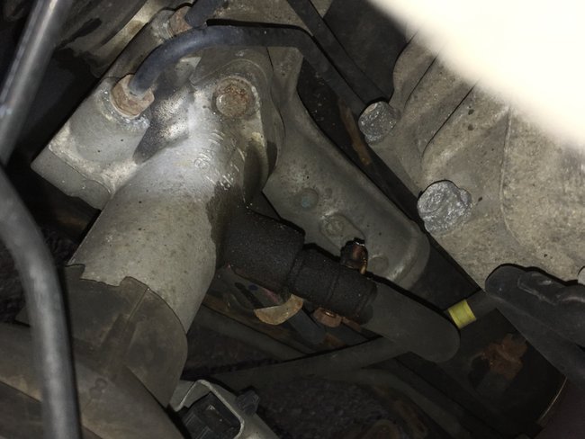

I took this picture of the line that leads into the steering rack from the pump
Feb 27, 2017 at 11:04 AM
KHLOW2008
  • 41,814 POSTS
This is the return hose and don't seem to be leaking badly. Only some fluid seepage. tightening the clamp might stop the leakage.
