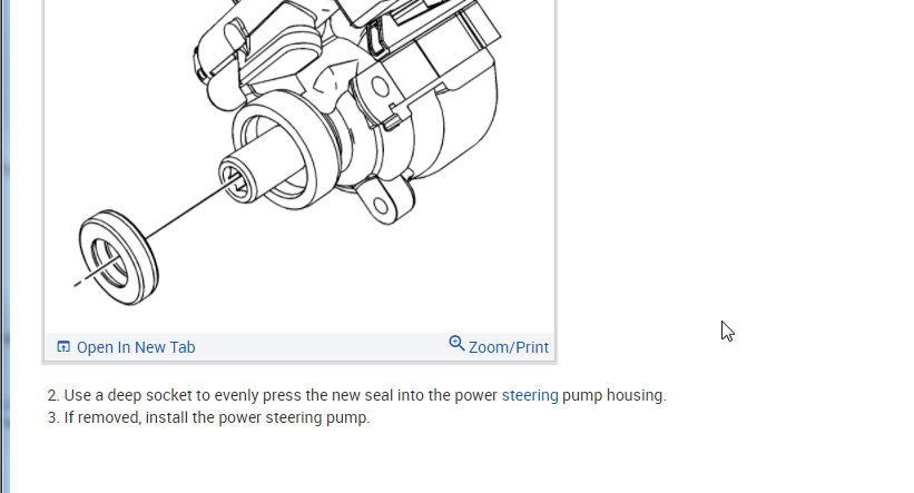

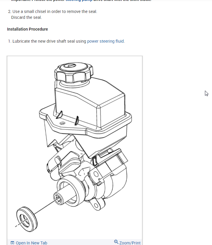

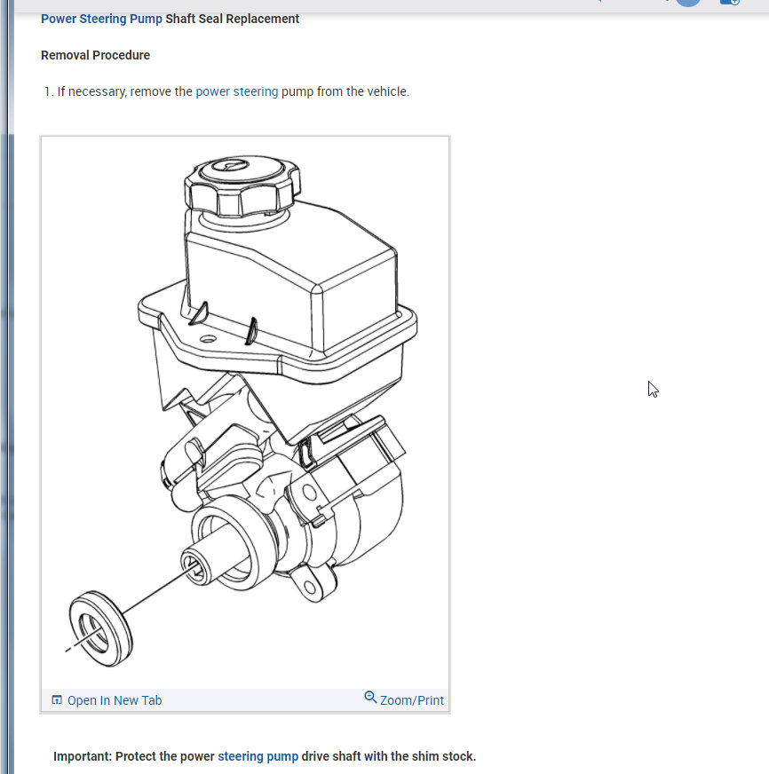

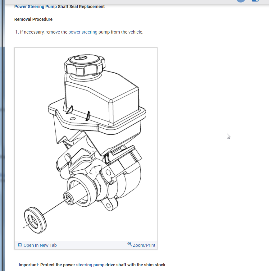

Unfortunately if the recall does not cover this failure then your only option is to fix where this is leaking. Are you able to locate the leak?
If it is pouring out it sounds like the pump seal has failed.
I attached the info for this if this is what it is but if you get a video of the leak then that will help us figure out what the possible cause of it is.
