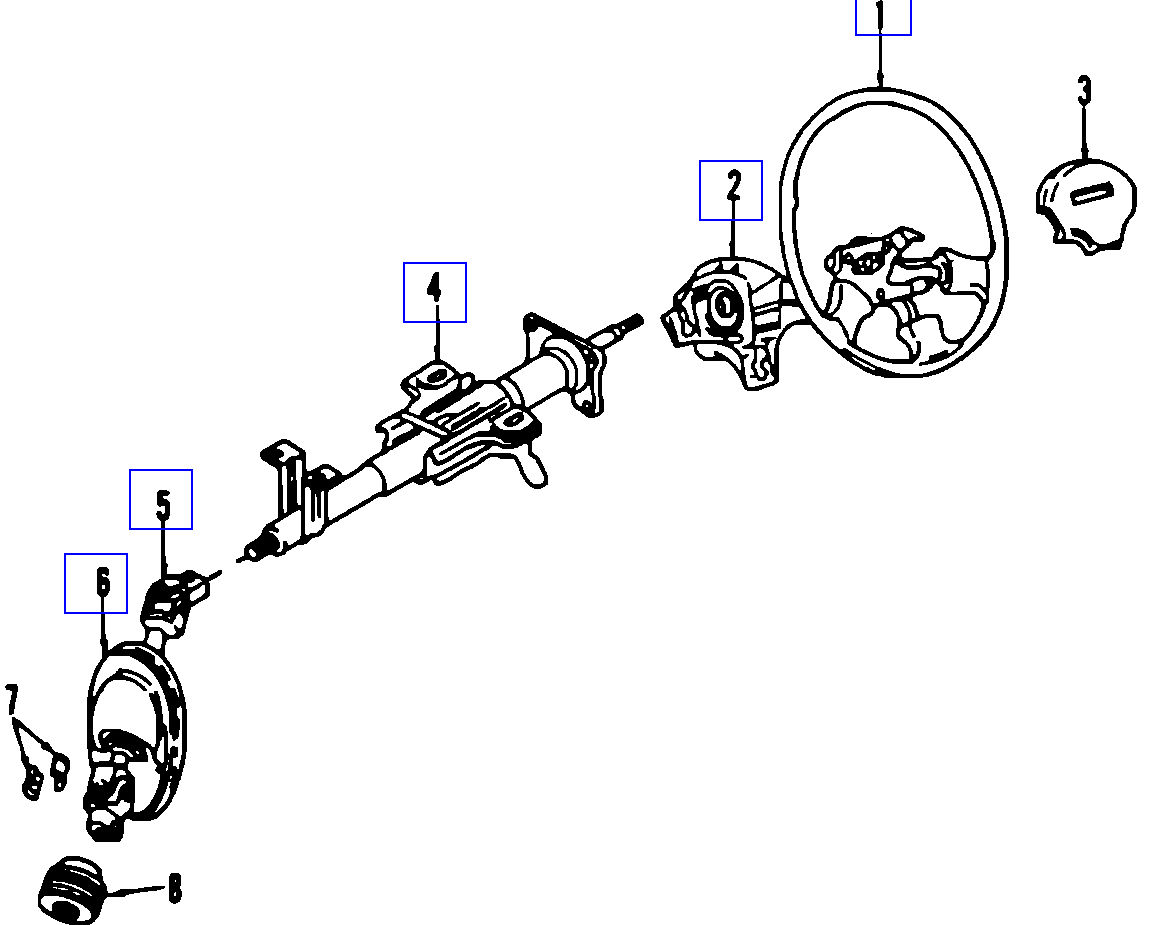

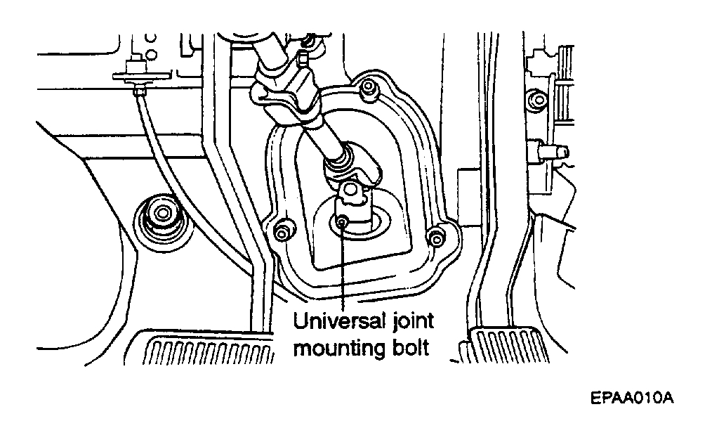

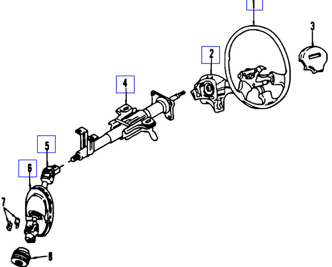

My steering wheel turn all the way round but does not control my tires any more. They will turn some time car will go straight hard when I try to make turn some times i can other times i cannot. Steering wheel does not line up or control front end.
Dec 14, 2018 at 5:41 AM
  • 110,244 POSTS

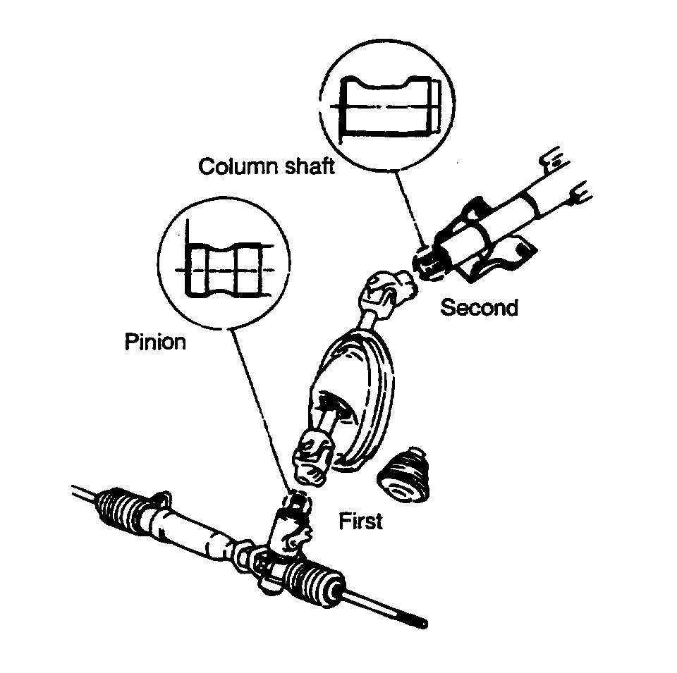

First, I hope you are not driving the vehicle like this. Now, based on your description, I have a feeling either the steering shaft universal joint has failed or where it the shaft connects to the rack and pinion has failed. Take a look at picture 1. Identify parts 5 and 7. These are the areas I feel you need to check first.
If you find one has failed, here are the directions for removing and replacing the steering column. Before starting this procedure, make sure to disconnect the battery and allow the vehicle to sit for at least thirty minutes.

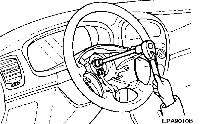

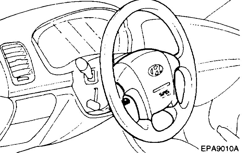

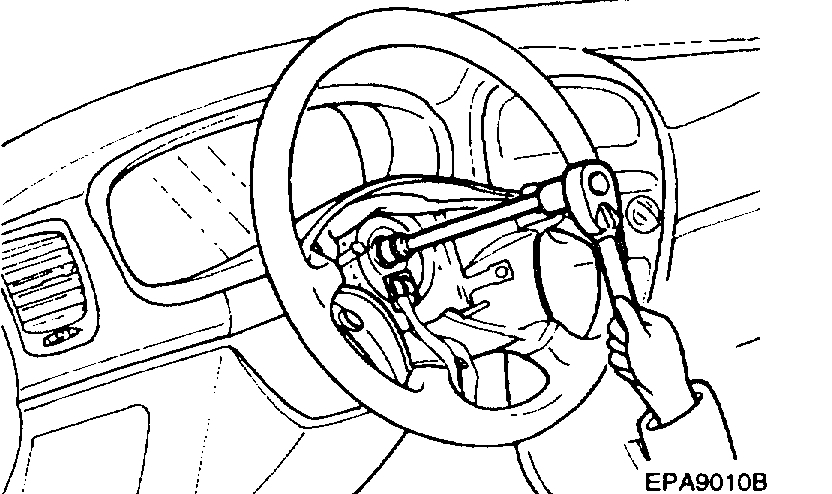

1. Remove the driver's side air big module (DAB) by using the hexagonal wrench.
2. Disconnect the DAB and horn connector, and remove the steering wheel nut.
3. Remove the steering wheel using the special tool (09561-11001).
CAUTION: Do not hammer on the steering wheel to remove it; doing so may damage the collapsible mechanism.

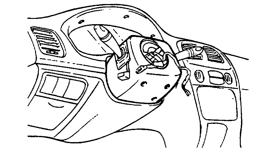

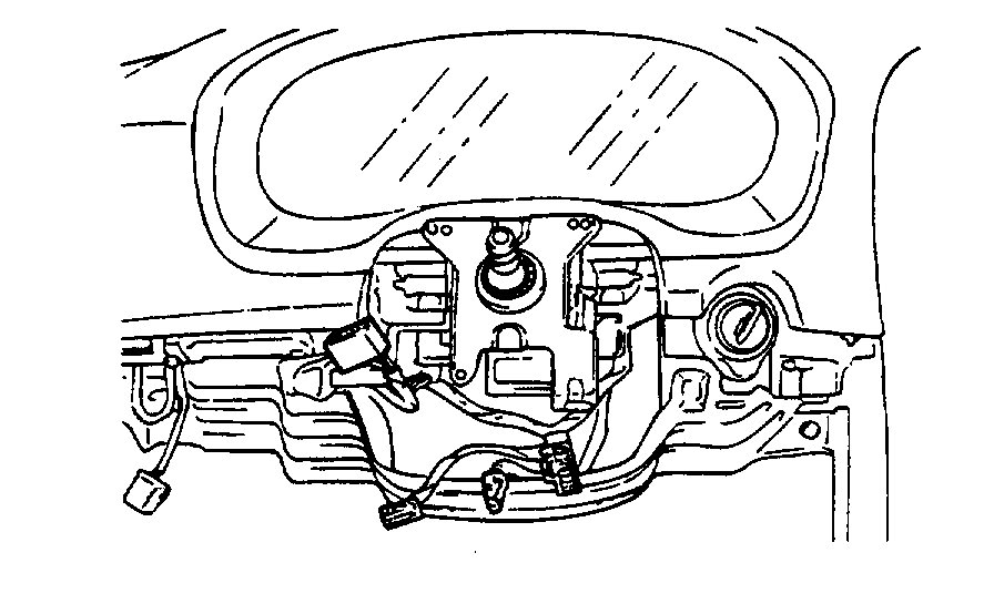

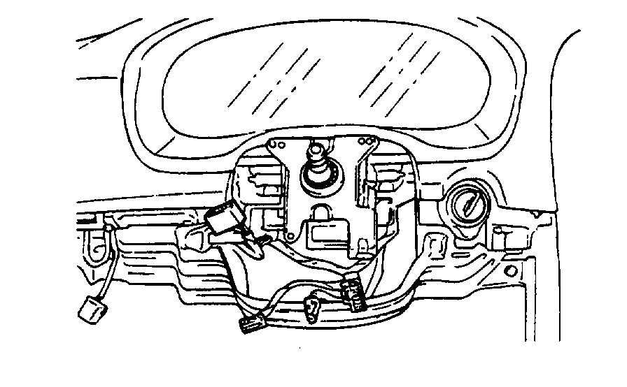

4. Remove the steering column lower and upper shrouds.
5. Remove the lower crash pad panel.
6. Remove the hood release lever and then disconnect the DLC (Data Link Connector).
7. Remove the lower crash pad frame.
8. Disconnect the connectors and remove the multifunction switch.

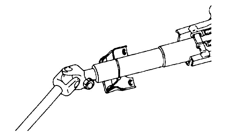

9. Remove the bolt securing the coupling and universal joint.
Pull out coupling and universal joint from the gear box.

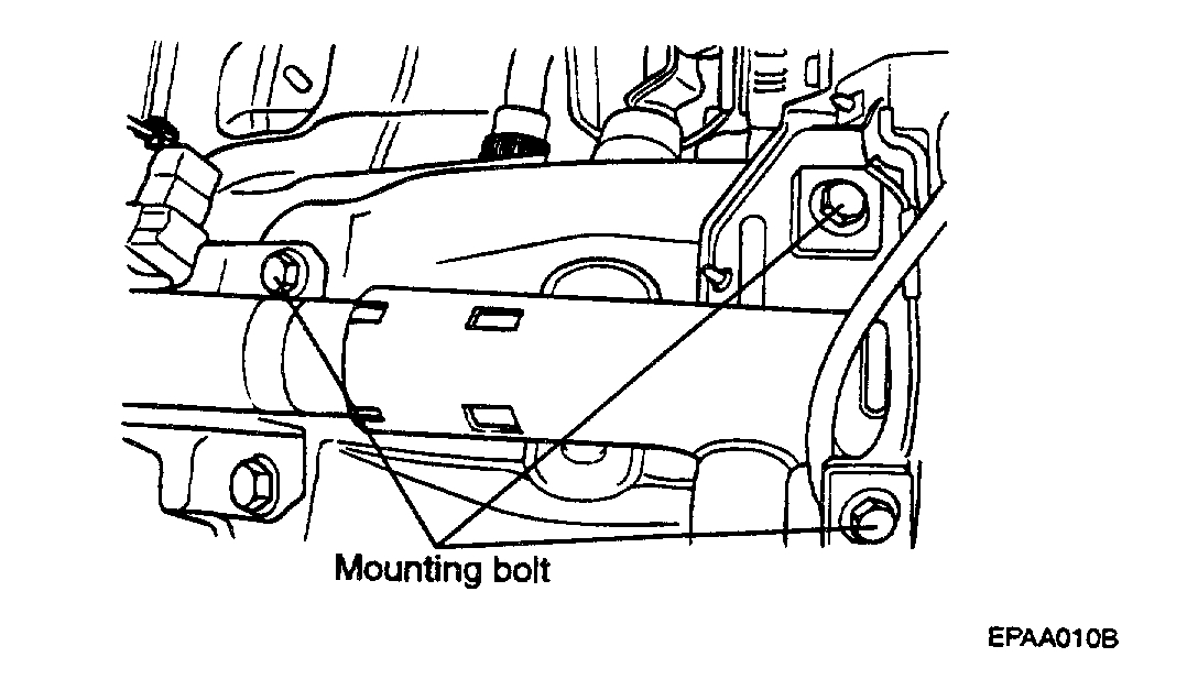

10. Remove the steering column mounting 4 bolts.
11. Remove the steering column.

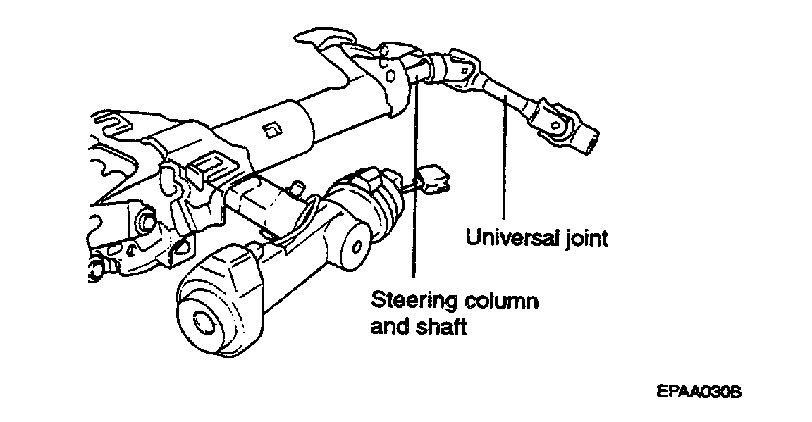

1. Remove the coupling and universal joint from the steering column and shaft assembly.

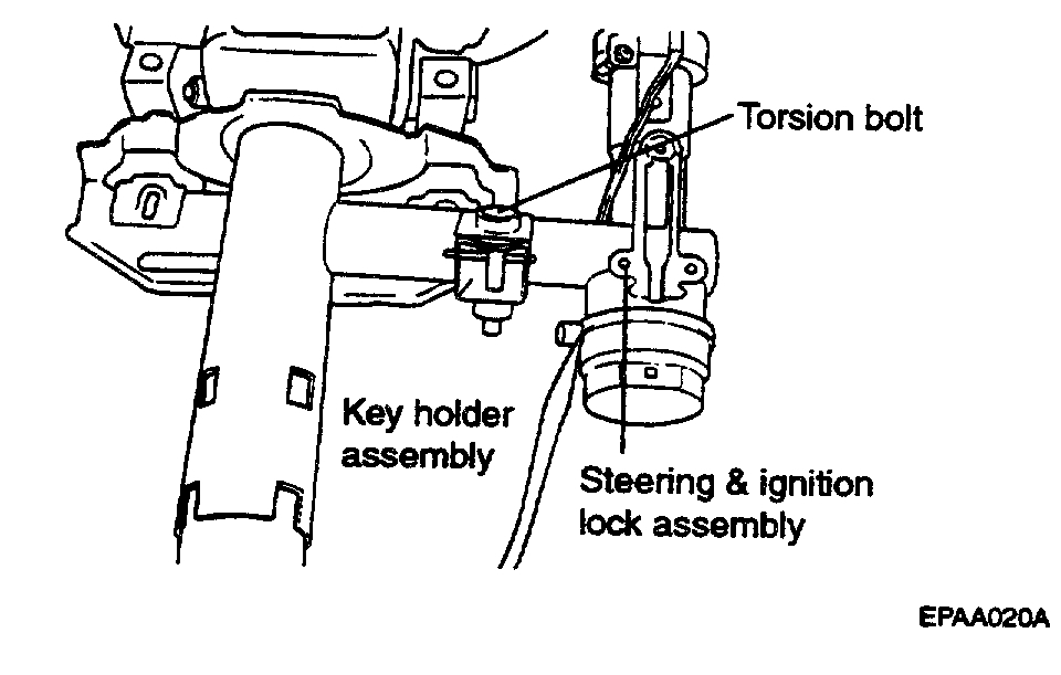

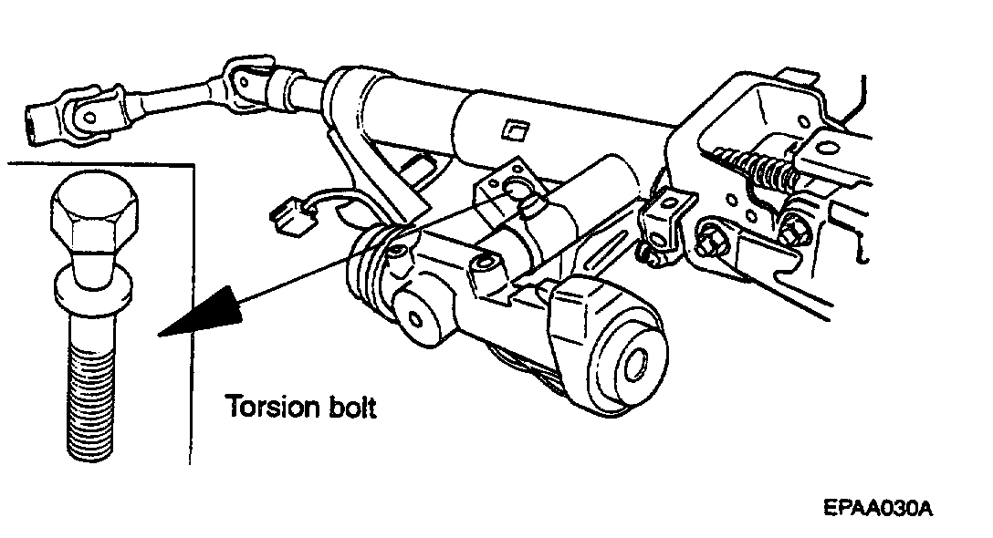

2. If it is necessary to remove the steering and ignition lock assembly, use a hack saw to cut the torsion bolt at the key holder assembly side.

1. When installing the steering and ignition lock assembly to the column tube, temporarily install the steering and ignition lock assembly in alignment with the column boss.
2. After checking that the lock works properly, tighten the torsion bolts until the head twists off.
CAUTION: The torsion bolt must be replaced with now ones when the steering and ignition lock assembly is installed.
3. Install the coupling and universal joint to the steering column and shaft assembly.

1. Install the universal joint to the gear box pinion.
2. Install the steering column assembly to the column member assembly (4 bolts).
