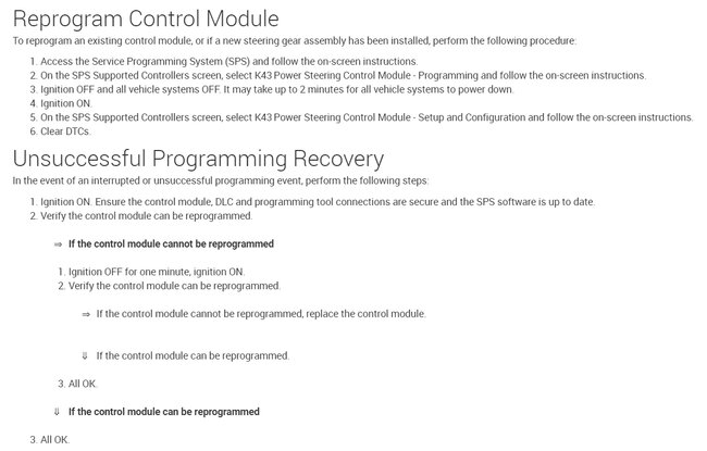

I have ESC service warnings and TC light on with stability light on.
c0460 5a: steering position sensor not possible.
Can I know the location of steering position sensor location
Aug 23, 2023 at 6:43 PM
  • 55,627 POSTS

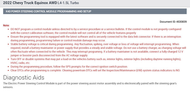

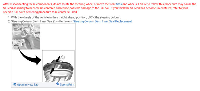

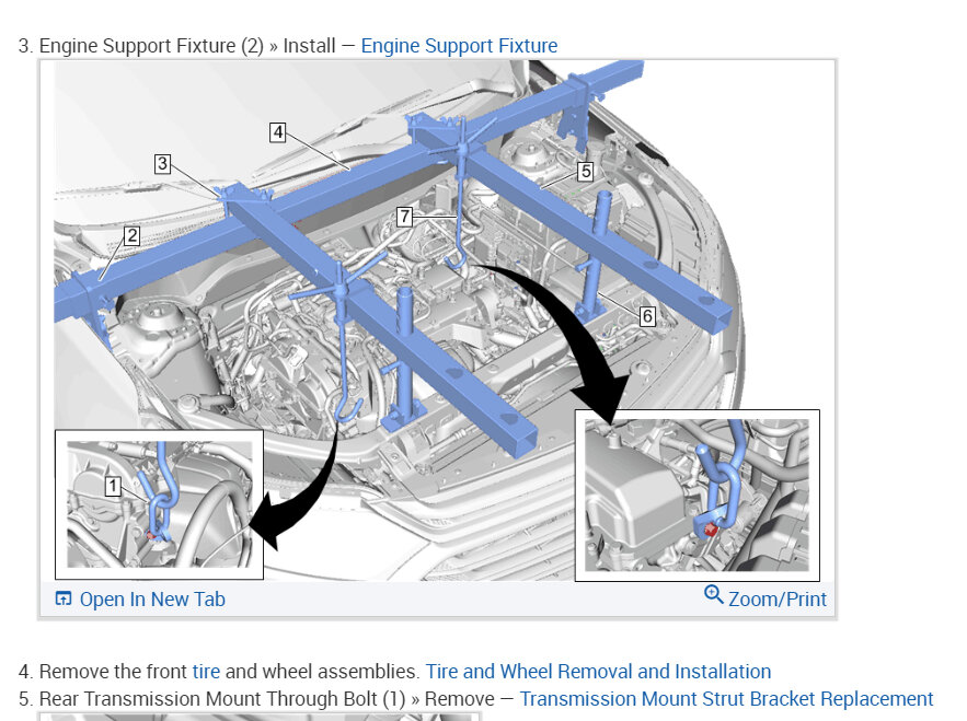

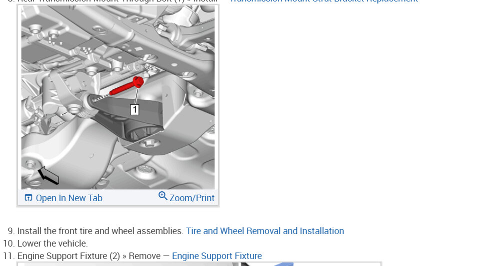

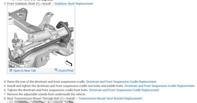

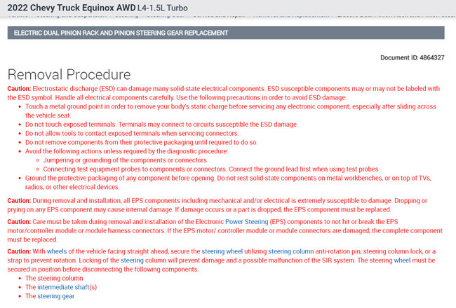

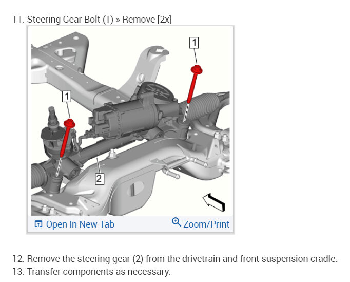

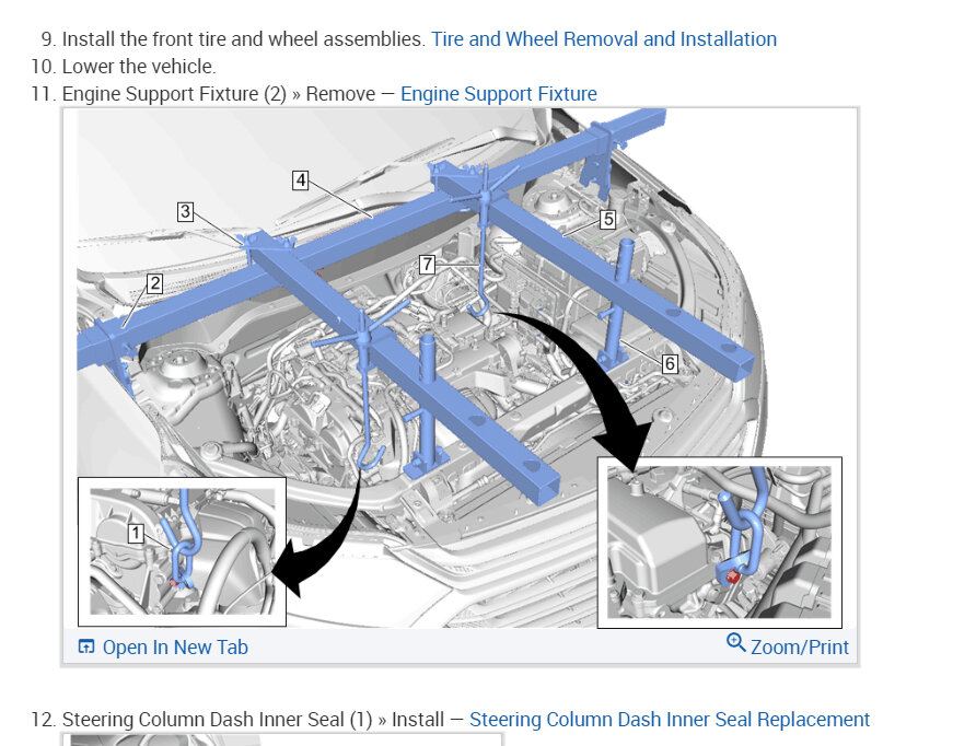

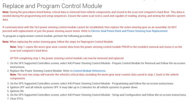

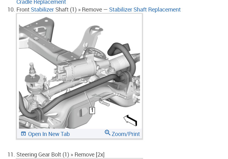

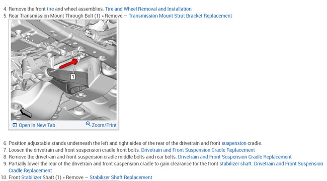

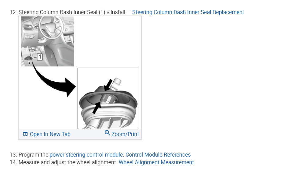

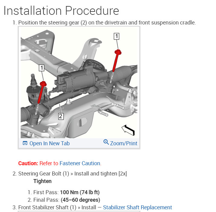

The steering angle sensor is integrated into the electric power rack and pinion. You might want to try to recalibrate the unit which I have included instructions for below. If that doesn't work the power rack must be replaced, which I have included as well.
Here is information on the code and what to look for:
The C0460 code is a diagnostic trouble code (DTC) that pertains to the electronic stability control (ESC) system
