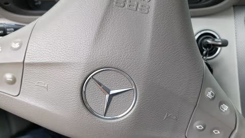

When I turn it wants to turn back on me like it has a mind of its own which affects my turning corners. Can you please help? Or diagnose the issue?

The car steering wheel pushes to the opposite direction when I'm turning.. I had new bushings,tie rods, upper/lower control arms done. replaced a month ago. Didn't have that problem before, had a wheel alignment, but steering still doing the same, like it want to turn back the opposite direction. other than that, the car drives excellent.

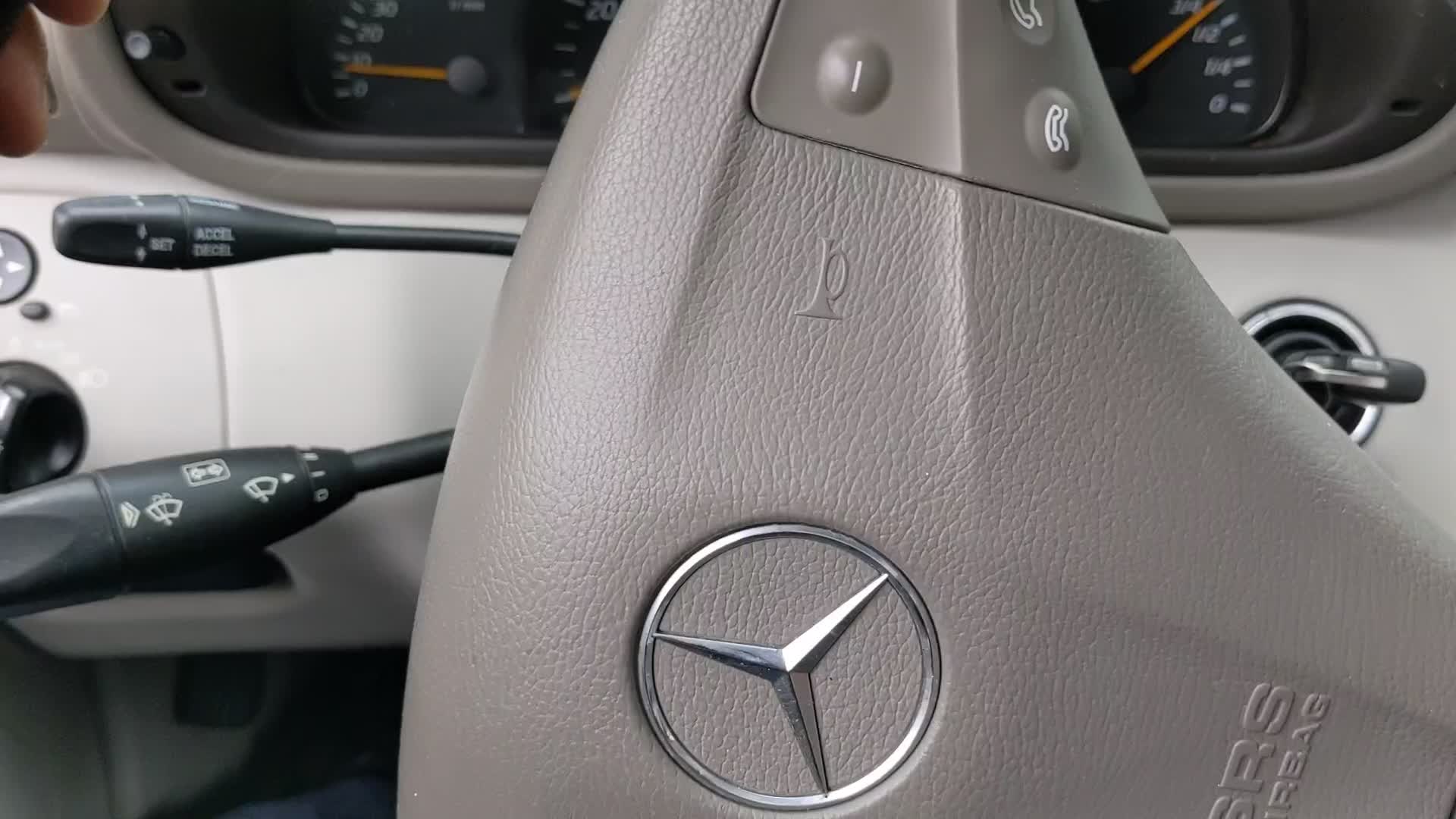

Sending video. when I turn the wheel, it kicks back the opposite way. Whether I'm driving fast or slow or even when I'm parking. Thank you for getting back to me.
Jun 5, 2020 at 2:36 AM
okay, that helps with getting me on the same page as you. Just to confirm you have owned this vehicle for a little while and have felt this get worse or did this happen all of a sudden?
I suspect the power steering pump is the issue or the steering gear. Depending to the answers above we can possibly start with checking the pressure in the system. However, let's take it one step at a time because I don't want to go off in the wrong direction. Thanks
