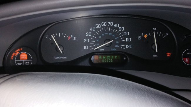

Sometimes when turning sharp left at slow speeds, like pulling into a parking space, I get a clunking and/or a grinding sound. What could the problem be?

Get the front drive shaft CV checked, sounds as if one has failed, you can look under the car and if the rubber boot at either end of either shaft is split and grease is leaking. they will require replacing.

Would that also cause my service vehicle (not engine) abs and antilock lights to be lit on my dash
Feb 16, 2017 at 2:13 PM
EGUNS80
  • 85 POSTS
Sorry Trac off not abs
Feb 16, 2017 at 2:14 PM
MHPAUTOS
  • 31,937 POSTS
A cv would proberbly not cause that, best to get a scan done and post any codes
