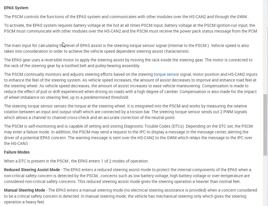

steering wobble at 60 kmh and higher. gets worse when turning left during a lane change or sweeping road. steering on center is less vibration. have had the tires roadforce balanced, 4 wheels alignment, new front hubs, new 4wd actuators and new steering rack.

If so, they need to make sure they report this issue to Ford. This system is not just a mechanical pump and rack and pinion. This is now electronically controlled and they vary the amount of power assist based on a lot of sensor inputs. This sounds like the control module is causing an issue in the assist.
If I am correct, then either the module will need to be replaced or possibly a sensor that is giving the module incorrect info. Either way, you need contact Ford directly and report the issue. They will ensure the dealer has started a technical assistance case which will engage engineering in they need too.

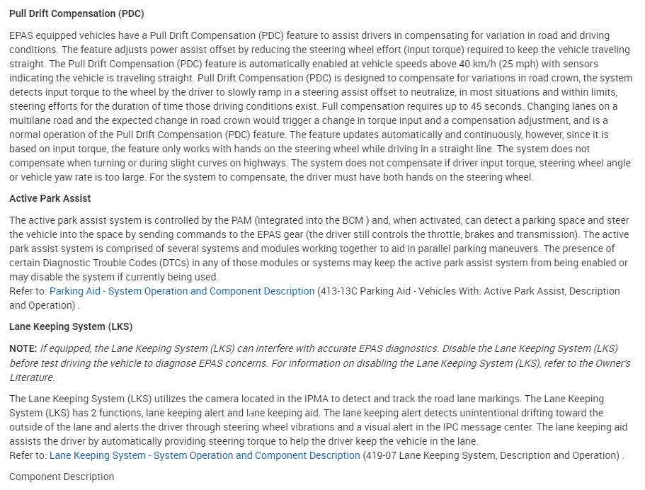

thank you, i appreciate your response. yes everything was done and documented by the dealership under warranty. I am familiar with the EPAS and its functions. i even tried disabling the Pull Drift Compensation via Forscan but it didn't affect anything. I almost still think its something mechanical as the vibration always starts at 60 kmh and up. no matter what gear, on or off throttle etc... the only way i can affect the intensity of the vibration is if i turn slightly to the left... i then started thinking maybe a right ball joint or control arm? Everything seems tight however...
