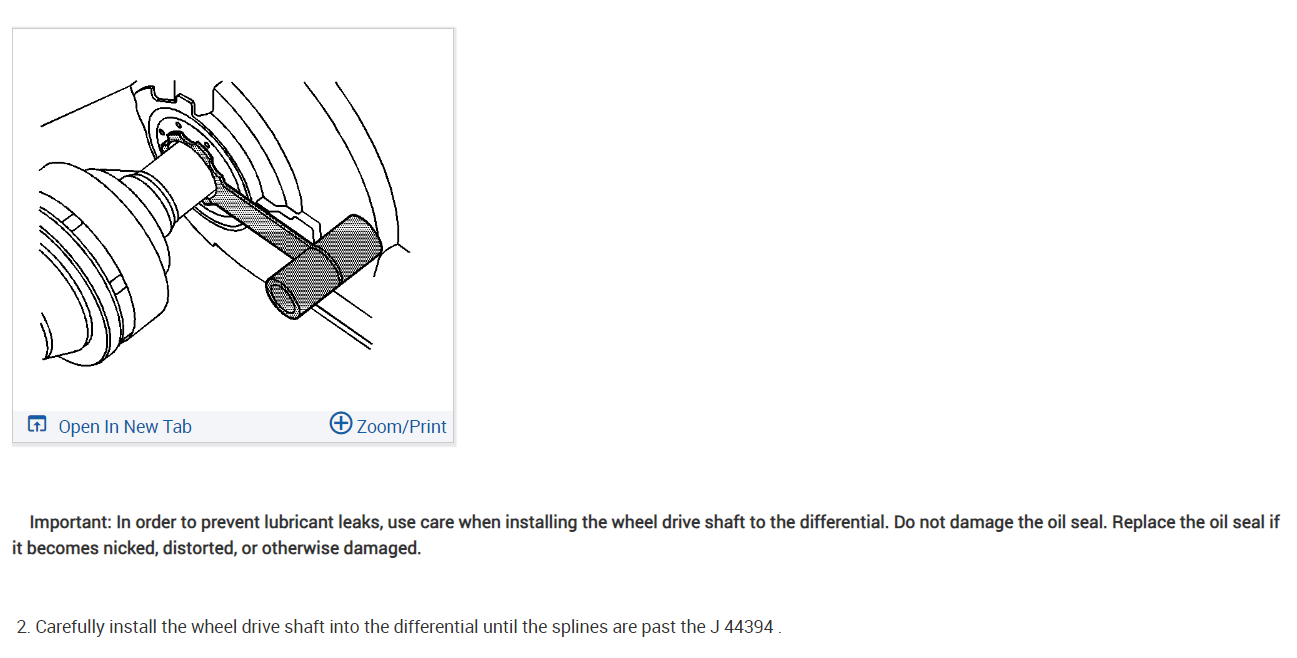

The previous owners had this problem as well and couldn't figure it out, but when driving there will be a sudden jerk to one side. It kind of feels like you hit some black ice for a moment. then it goes back to normal. Also, when you start to apply the brake it will do it as well. It's always in the same direction, to the right. We've replaced the brakes, there's new tires on it. And the ball joints and wheel bearings have been replaced. It does show the esc light, traction control and abs light on the dash.

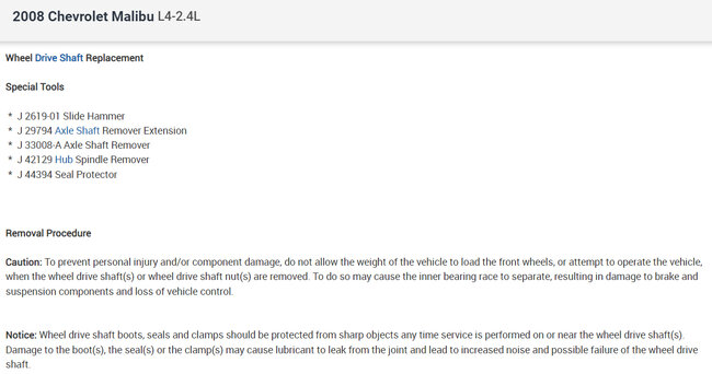

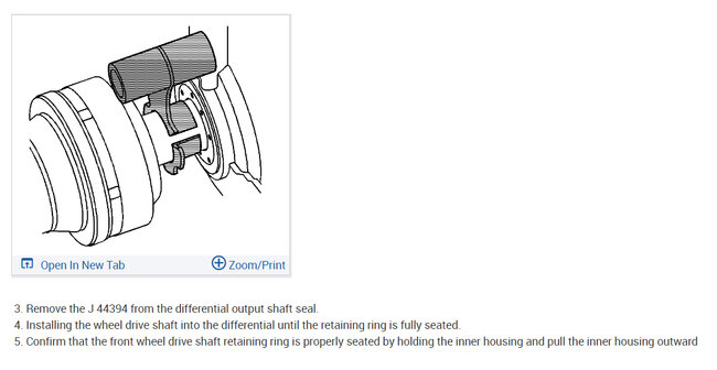

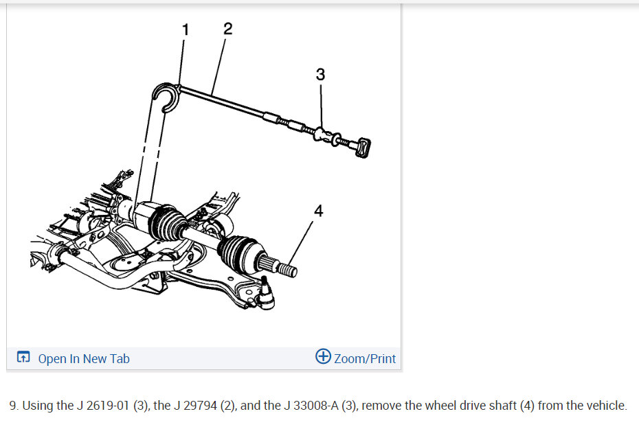

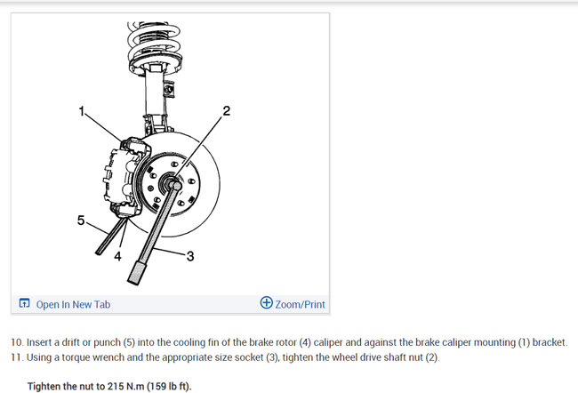

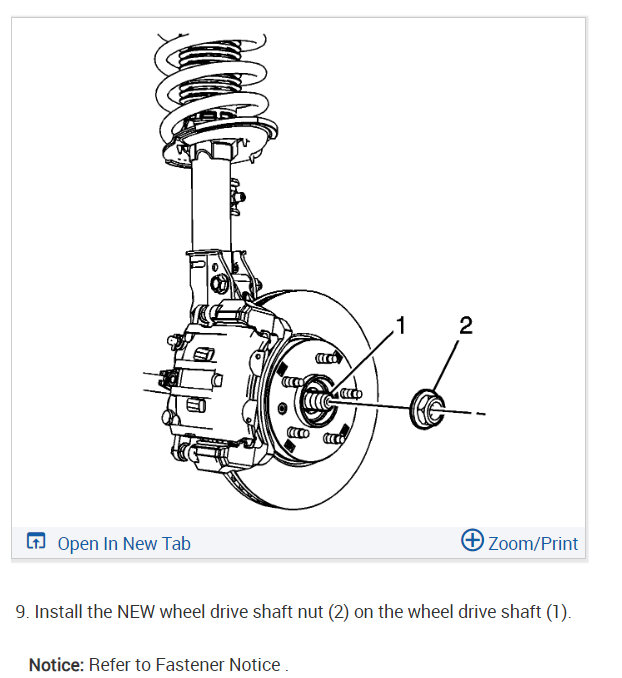

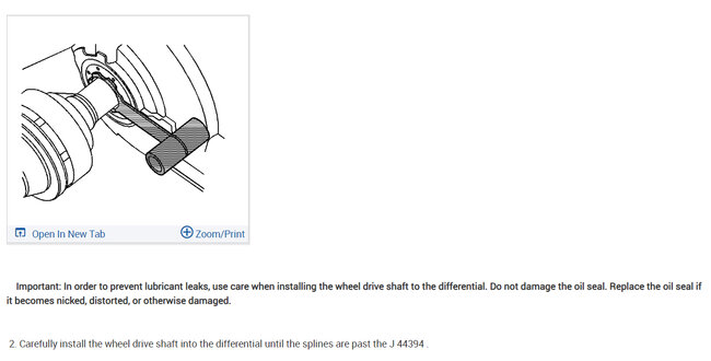

I have seen the CV axle start to bind up and cause this problem. I would remove the axle for inspection and then replace it if found to be bad. Also, we should run the codes for the ABS/Traction control.
This guide can help:
https://www.2carpros.com/articles/anti-lock-system-testing-and-repair-abs

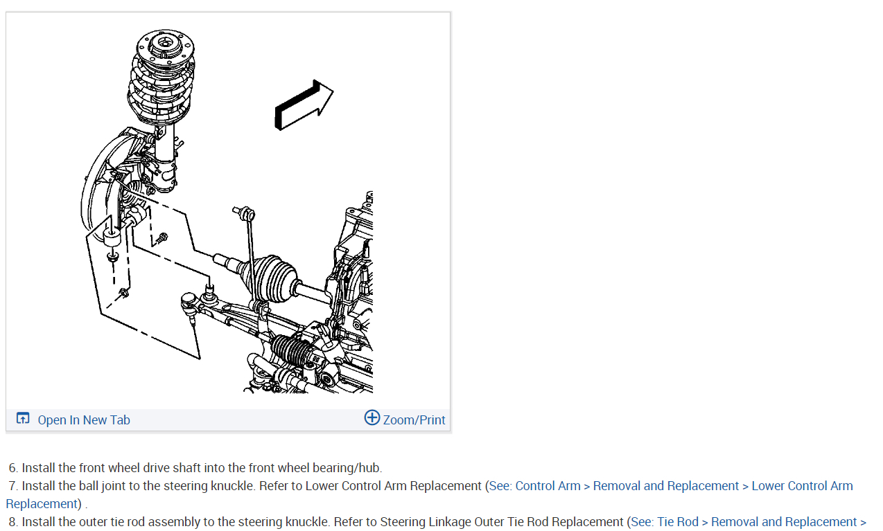

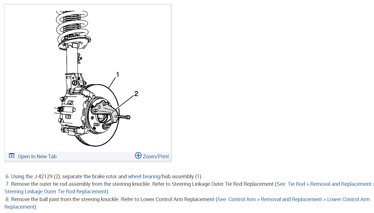

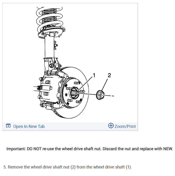

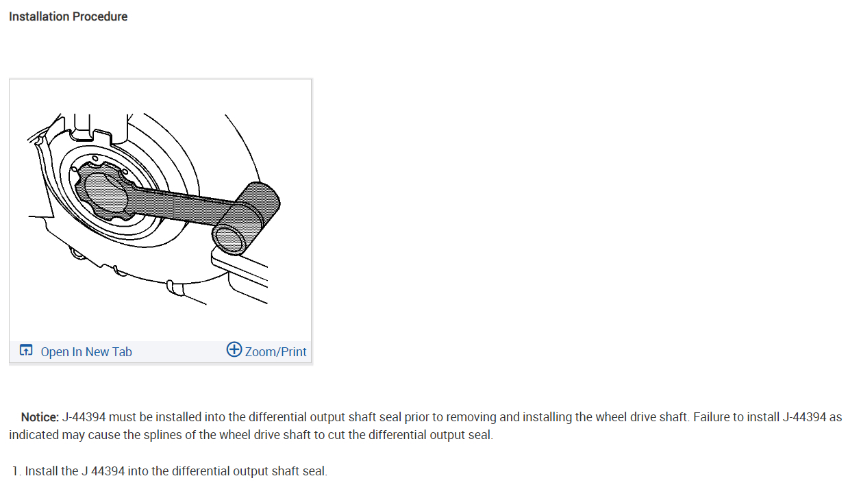

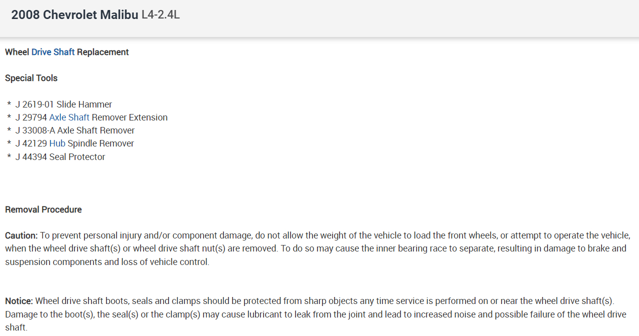

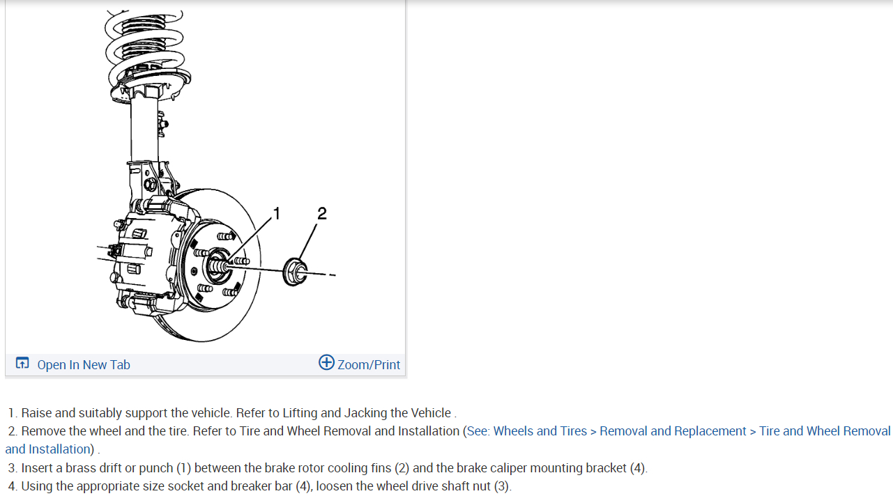

Here is how to remove the CV axle in case you need it. Check out the images (below). Please upload pictures or videos in your response to any problems so we can see what to help you with.
