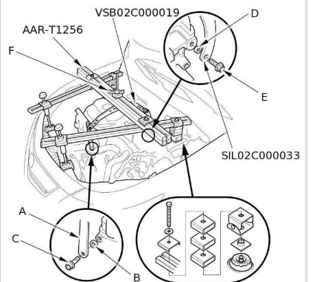

Turning one side is super smooth while its harder to the other. New tires. Drives great
Sep 5, 2026 at 7:30 AM
  • 55,721 POSTS

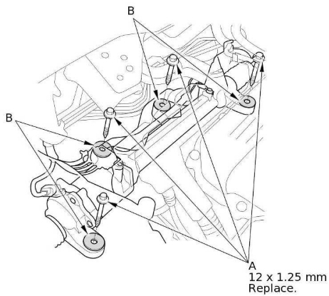

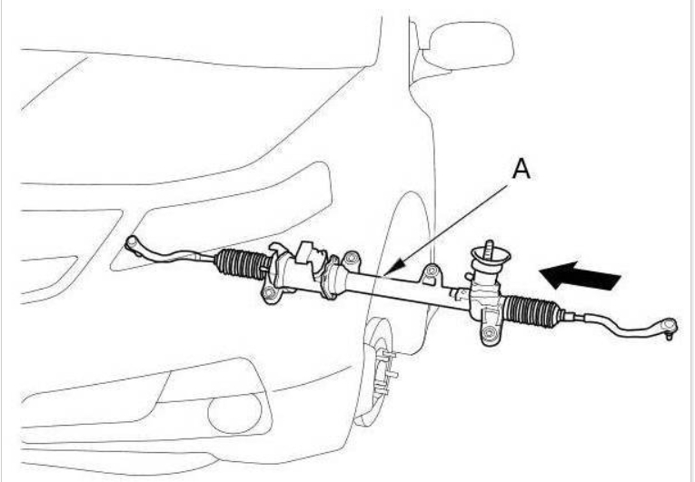

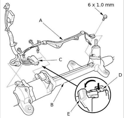

Yep, this is an easy problem, the steering rack is bad. Unfortunately the replacement is a little more difficult. You will need to lower the engine cradle, here are some images to help you with the repair. Let me know how it goes.
