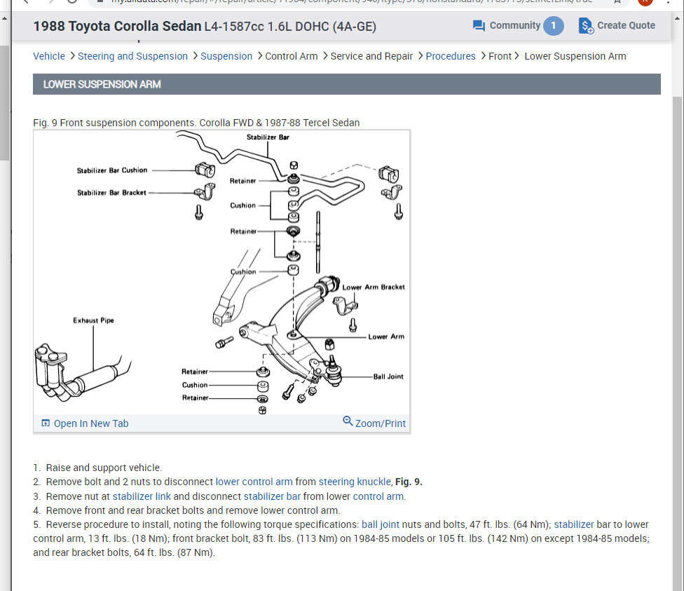

I am replacing the idler arm. I do not have the torque specifications for the two types of the bolts.
Would like to know the torque settings for the following:
i) The Castle nut on the tapered ball joint.
ii) The two bolts that attach the idler arm's plate to the body of the car.
Also, is it right to torque the bolts with the passenger side front wheel jacked up? Or do the wheel have to be on the ground?

Unfortunately, due to the age I am unable to get any torque specs. However, you can torque the nuts with the wheel jacked up as this should have no effect on the torque readings.
Jul 21, 2021 at 4:08 AM
Unfortunately we don't have torque specs for a 1976 vehicle simply because they did not provide that info to AllData or Mitchell which is who we use for our online manuals.
However, these vehicles did not change that much over the decades and so while the torque specs will not be exactly the same, they will be close and not cause any damage. So I included below the torque specs for a 1988 which is the first year that they started publishing these types of torque specs like this.
More than likely the paper service manuals at the dealers had this info in them but unfortunately that was not transferred to the online manuals.
If you are still looking to be more accurate then we would need to contact a dealer and see if they will give you access to those manuals if they still have them.

Also, you do not need to torque these on the ground. Securing them while still on jack stands is just fine.
