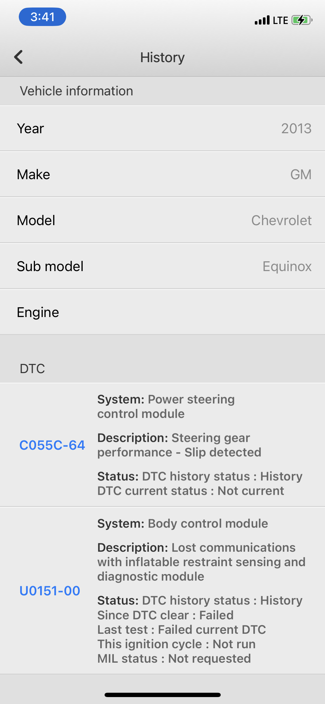

I recently did a scan of my vehicle and got a DTC C055C-64 which noted a steering gear slip was detected. Is this a serious problem? Also, what is the appropriate repair or next steps in troubleshooting?

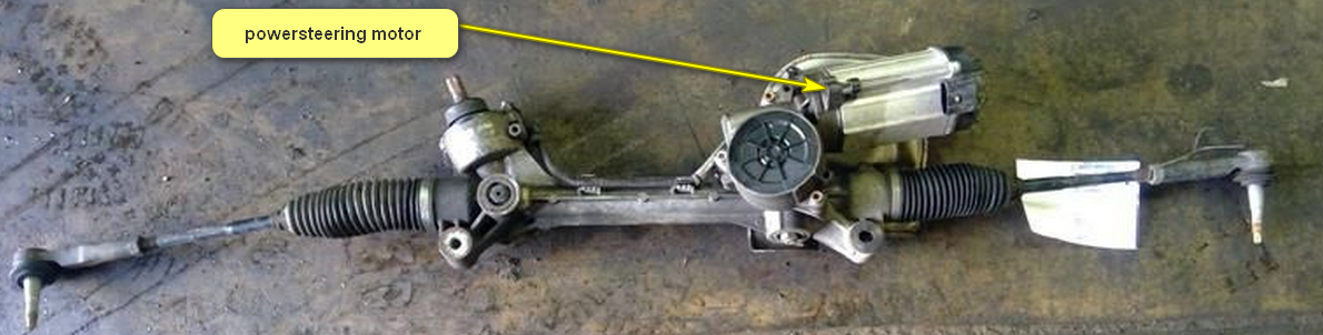

C055C- Steering Gear Performance Slip Detected
A guide:
https://www.2carpros.com/articles/power-steering-problems
The power steering control module continuously verifies the mechanical friction of the steering gear. If the friction is too high the clutch between motor and rack slips and the internal angle is no longer valid.
If the mechanical friction in the steering system is too high, the steering gear must be checked, and all rubber boots and seals inspected. Check for signs of water intrusion into the steering gear. If water has gotten inside, high friction is likely to occur again.
The usual repair is to replace the steering gear. You can try and reuse the old steering motor.
If a new motor is to be installed together with the steering gear, then the new motor needs to be programmed using SPS programming, a factory tool.
How to replace steering gear:
https://www.cequinox.com/steering_gear_replacement_2_4l_steering_gear_assembly-1681.html
How to replace steering motor:
https://www.cequinox.com/power_steering_assist_motor_replacement_hydraulic_steering-1663.html
See image below.
Cheers, Boris
