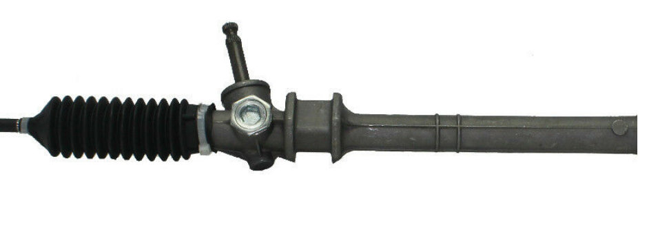

According to instructional manual of the vehicle listed above 2-door Hatchback, replacement of the steering gear requires removal of the Multi-Function Ignition Switch and airbag contact, steering wheel and steering column (upper, lower and intermediate). I have never had to remove any of the above while replacing a steering rack and pinion on GM models. I only fix the steering wheel in place and remove the pinch bolt of the coupler to the RNP and separate them. Can the same be true for this vehicle?

Yes right Roy, the steps you outlined are exactly what is expected. This car, however, has no steering hoses and no steering pump- it is the "Manual Steering Rack and Pinion Assembly 1994-1997 Ford Aspire Base SE" I am replacing (image attached). I have the Ford Service Manual for this car, and it calls for the steps I described in my question (it asks, in step 2, to remove the "steering column and lower steering shaft." In another section, it describes removing the steering column (which is where the problem is because it pretty much asks for the removal of everything!)Can you reconfirm one more time. Is it possible that the gear input shaft to couple bolt is inaccessible until the column is removed? That's a lot of work to replace a primitive gear as this one.

Yep, manual steering tells you to do that. I would see if I could just release the coupler and leave the column alone.

Hello Roy, I know this is like months after our last emails about this installation. But as you know I had been busy with other cars and rebuilding everything under the hood for this car. Well, to make the story short, I finished all the work under the hood and I have been driving the car to auto body shop suppliers to restore the body and interior trims and later to overhaul the wheel system. But when I first drove the car, the steering rack was not centered. No matter how hard I tried to align the wheels, it didn't work because the guys at Detroit Axle told me it was centered and not to touch it "to just install it." Well, I reviewed your last statement on here when you helped me with the installation and I said to myself "how did he know the rack wasn't centered?" Because that's the problem now, and I am having to take it out to center it. The steering wheel won't center (I couldn't get the steering wheel to be centered straight after counting equal turns to the left and to the right in order to center the rack while the rack is still attached to the lower column of the steering wheel). So they have to be separated? I am going to cut a slit in the boot again (which was what I did last time to avoid removing the column) and reach for the pinch bolt to lower the rack. Now when I take out the rack and center it off the car on the bench and then reinstall it, all I have to do is make sure the steering wheel is straight right? I mean the steering wheel could potentially turn perpetually when not connected to the bulkhead of the rack and centering it by turning it to the right or to left is pointless and not advisable? So, it would be a matter of just making sure the steering wheel is straight (no turning and counting and so on) when I spline the lower column to the rack and fasten the pinch bolt, right?

Okay, no need to remove the rack.
What you need to do is turn the steering wheel all the way to the right. Then count the number of turns it takes to turn it all the way to the left. Let us say it is 4 turns. Then you turn back the wheel exactly 2 turns and stop. That is the center point for the rack.
Then you remove the coupling from the rack for the steering wheel and center the steering wheel in the car and attach the coupling.
Then have it aligned.
